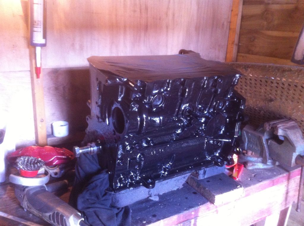

Finally managed to get the bolt undone to get the front pulley off, thanks to a bigass 1" drive windygun.
Got the block all painted.

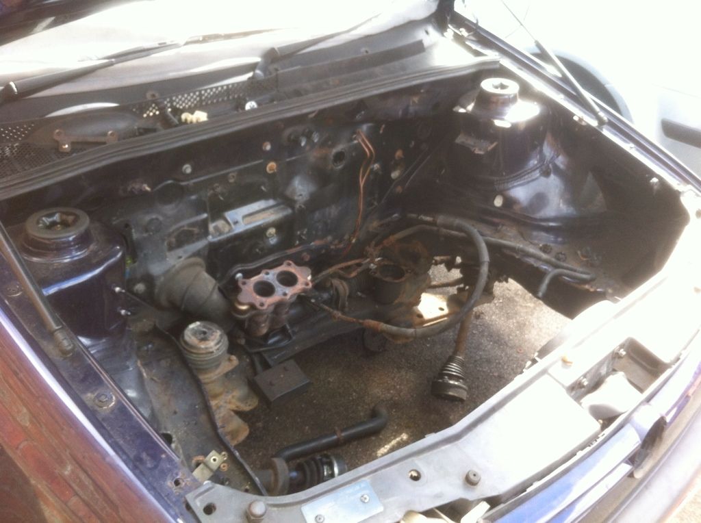

Also managed to get the engine bay pretty much cleared out ready for removing the seam sealer, not a job im looking forward to as ive read so many people have started and wished they hadnt. Hopefully will get the help from a mate.

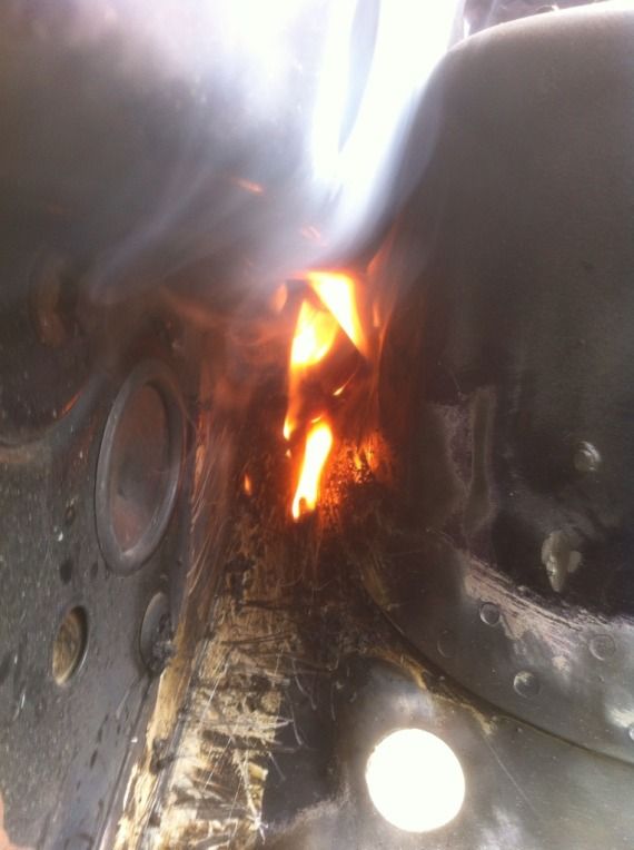

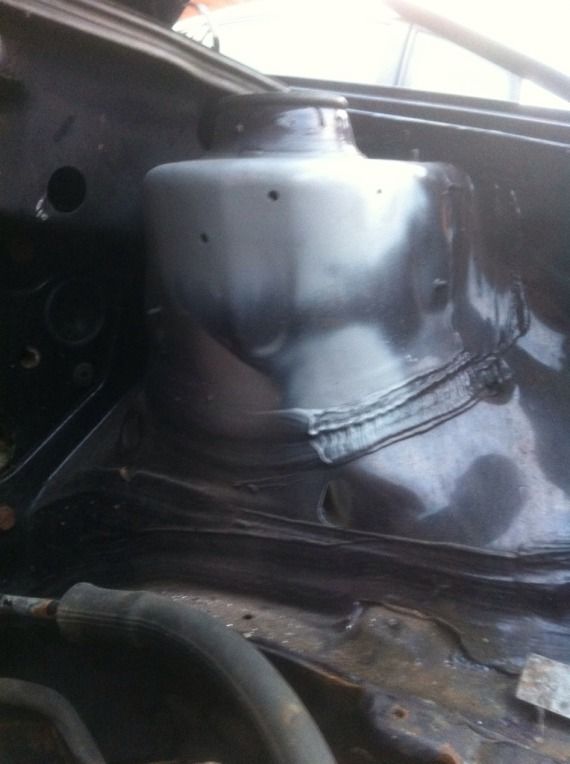

Started getting rid of the seam sealer and afew unwanted brackets tonight, not as bad a job as I thought it was going to be, few tight areas I can't get into but will get some smaller wire brushes to get in there.

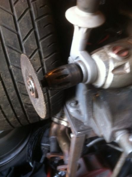

I blew my grinder up the other night cleaning up the rear axle, not having time to get another yet I dismantled it to make my drill into a grinder, works pretty well just gotta watch the old fingers with no guard on it.
Got a coat of etch primer on all bare metal areas

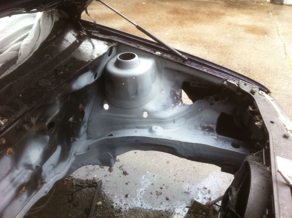

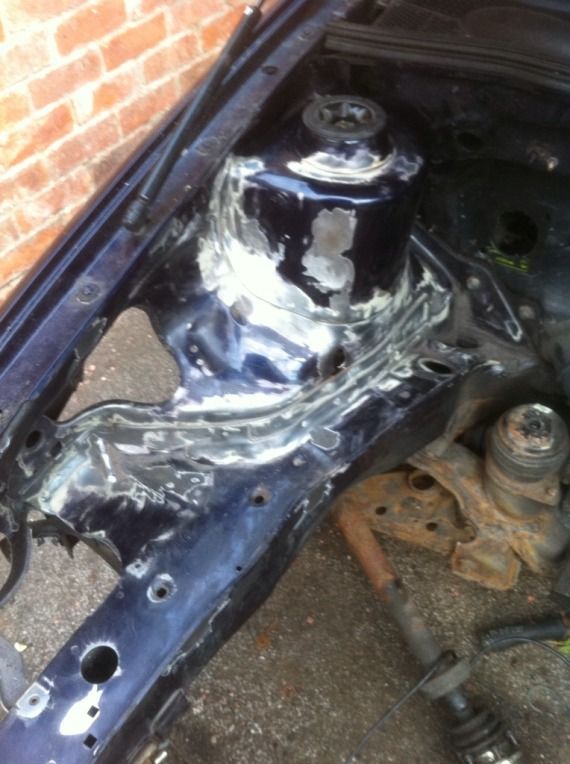

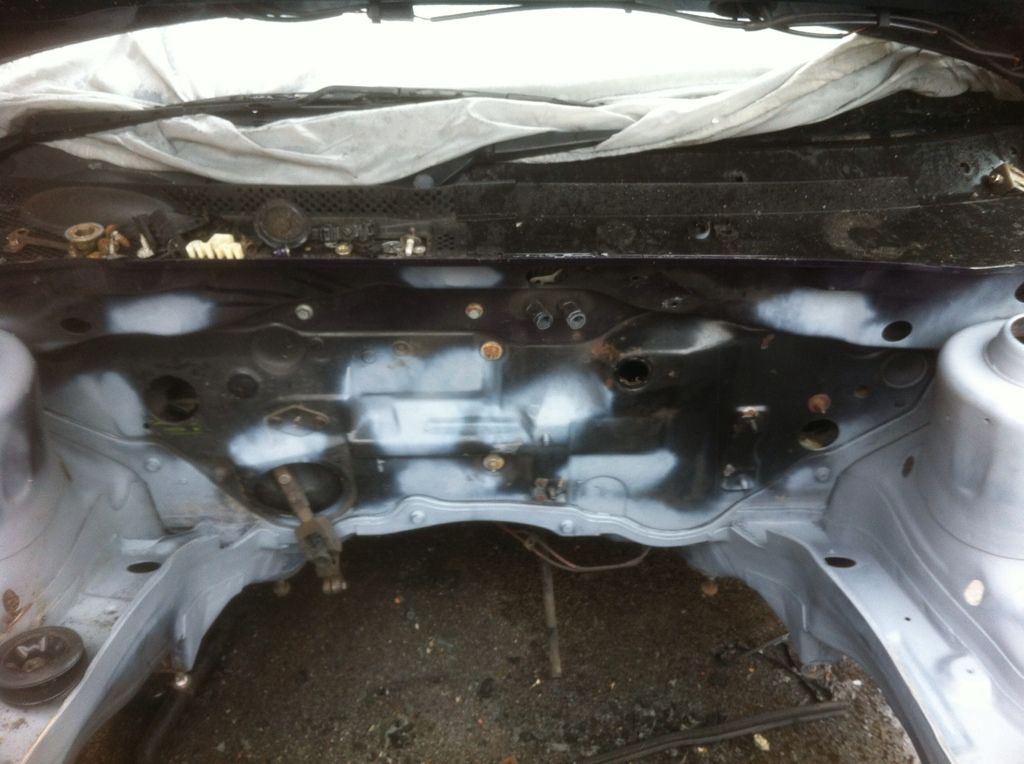

Bit more done today, went and got some supplies last weekend to help remove the seam sealer, gas blowtorch really does help, think its all pretty much gone now just a bit of cleaning up to do after the angle grinder flings the stuff absolutely everywhere.
All bare metal areas have a coat of etch primer, just need to get on with welding a few bits up then i can get a coat of primer laid down. Rain stopped play for the day tho.  :sad:

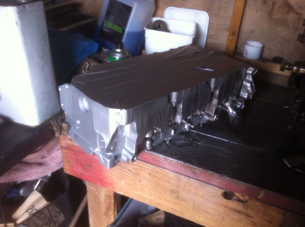

Got the head all masked up and painted. Starting to look alot cleaner.
