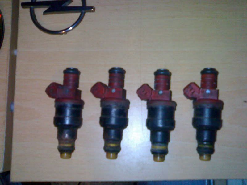

there there is this the rite saab injectors for the golf agu

yes looks like it mate. Get a part number to be 100% though

what about theses ones look a bit diffident

Second ones are the wrong fitment
