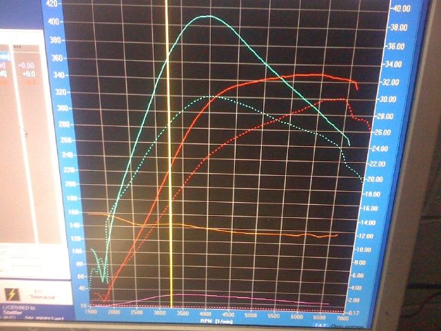

Oh, just got this pic as well.
My before and after WMI
The differences in software are....
Before
GIAC stage 2 software
Evoms intake
After
GIAC extreme map in Race mode
VF Intake - 3"MAF housing
Devils Own Water Methanol Injection
BSH throttle pipe
Exactly 60bhp and 90lbft more at 3500rpm!! Not bad returns for the outlay cost.
The midrange on this R is now mental.  :laugh:
Graph....
This was the first run up graph on WMI before fine tuning.

Wow.
They are some serious gains!! :shocked:

Mental isn't it. I just can't believe this car! Is it possible that this car could reach anywhere close to 500bhp?  :smug:
