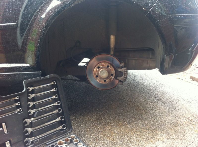

Been having a look at the rear sticky brake today. Thought id find rust on pads as its been stood with the hrandbrake on for a while. Didnt though, wire brushed them anyway, re-greased sliders. Must be a piston problem, Ill take the cover off around the piston, put some lube down there and wind it back with a g-clamp see if that free's it up. Failing that Ill just pop a new caliper on.

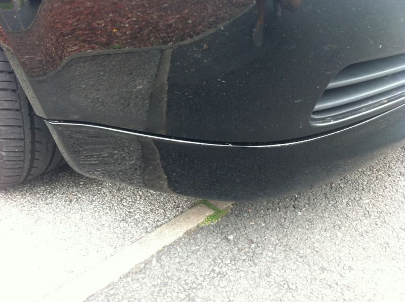

Considering I sprayed it in the dark pretty much, the front splitter came out well

ive just done a sticky rear on mine mate drop the break line off it undo the to 13mm nuts then pump the arm piston will come out. give it a clean and wind it back in. they done push in  :wink:

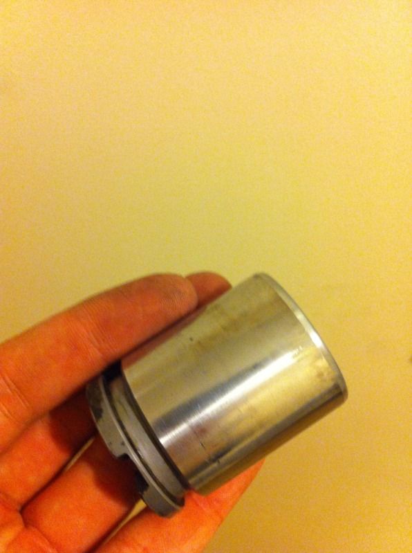

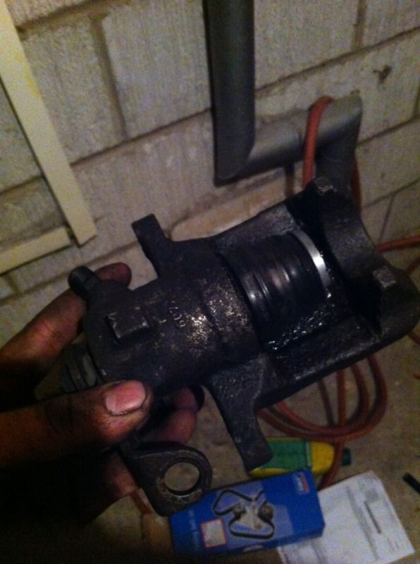

Anyway there I was tearing the caliper apart when I realised I had run out of brake fluid. Not only that but after I cleaned all the crap off the piston, I remembered it was a wind in caliper! Didnt stop me trying to wind it back in by hand  :grin: got one turn out of it then gave up. Kinked the hose, cable tied it up, wheel back on and without brakes shot out of my garage, down the drive round the corner and parked it on the side of my house and left it in gear. Will take the caliper off to a mates garage in the morning to be wound back in and go buy some fluid! Feeling pretty special right now  :rolleyes: no fluid lost out of the brake hose tho so no air entering the system which is good atleast lol.

put my one back in with mole grips drop of 3 in 1 oil around the piston job done :smiley:

Yeah I left most of my tools at my other house so didn't have any. Sorted now, have fluid aswell now so will bleed when I've got someone to stand on on the pedal. Calliper is nice and free now. Quite ironic that brake fluid can be used to clean up the piston. Might do the other side for good measure too so it doesn't jam up like this one has.
