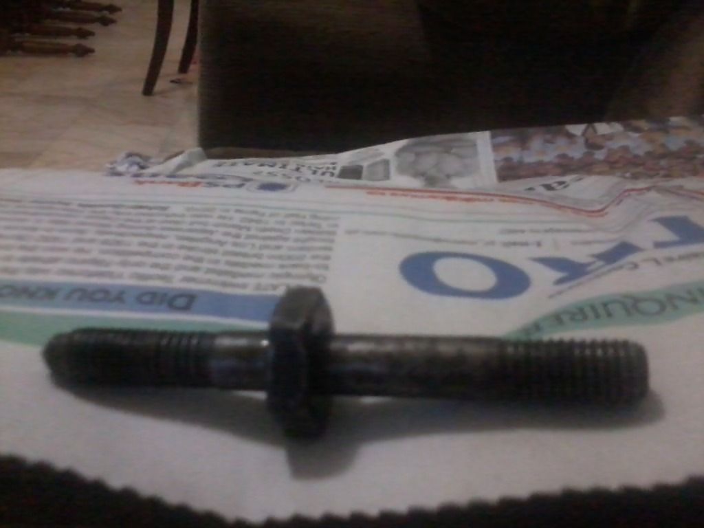

Here is the type of bolt - I have aircon, so need the ones that have 2 ends for the aircon compressor bracket to fit on. 2 shorter ones like in the pic, 2 slightly longer.
Does anyone know part numbers for these bolts? Or where I could find them online? Better yet does anyone have a spare set at home they wouldn't mind popping in the post? - I can send money by Paypal or a British cheque.

I think you're in for a new set from a VW dealer, to be honest.
With things like that, if it feels like it's tight enough, then it probably is.
A quick centre-pop in the middle and some careful drilling should see you right.  There's no chance you put the bolt in the wrong way round is there?

I wish I'd stuck to tightening it with my socket set, rather than reaching for my new torque wrench, no chance I would have over-tightened it then. The new wrench though is a huge long beast and because of the extra leverage it didn't feel that tight. Bolt definitely went in the right way round.
Do Audi dealers tend to stock VW parts in other parts of the world? I don't mind making the trip, but just don't want to waste most of a day (its 2 hours or more each way on the bus to the closest Audi dealer.) just to have them tell me they won't be able to get the parts in.

A LOT of the parts are the same,    cant you just ring them up and fire part numbers at them
all the VW's have gone bar 1.
