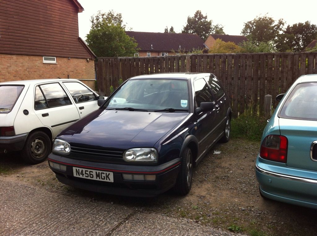

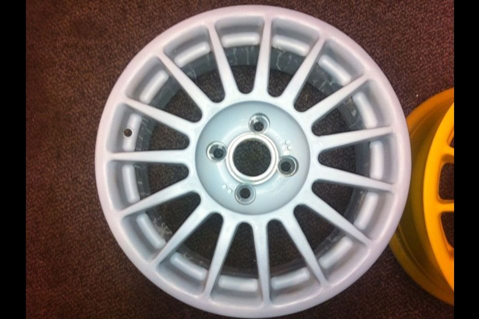

looking to get theese for my golf but not sure what colour i should have them in ......
what you guys think i like white or black my car is the purpley blue colour
last thing is what size does the centre of the wheel need to be so it fits the hub properly , i cant remember the correct name fot it , something like spiggot hole? brain dead ,
cheers guys ,

They're 4 stud, a GTi is 5 stud!  Are they VW wheels? If not then nobody could guess what size caps you need, your best bet is to measure the hole with a vernier gauge.
And personally I think white would look good on your car, if they fit  :laugh:

Centre bore is 57.1mm.  :smiley:

^^ What he said for the center bore (Spigot) and you want 4 x 100 pcd with an offset of around the et35 mark  :wink:
