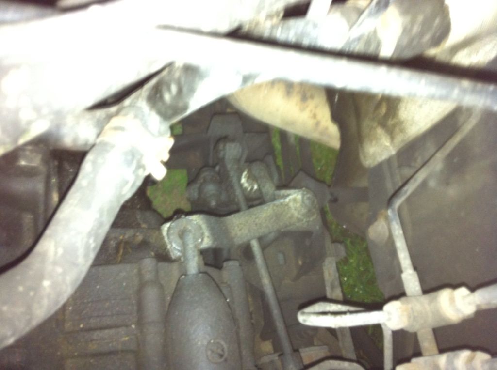

i was defending the mk3's corner earlier when a fto raced me all the way up to 30mph . was nearly beaten but we won ! anyways back to topic , i noticed my gear stick felt a tad floppy when in gear i can move it back and forwards quite abit . so took a poke in the bonnet and i think i found the contender
the little white bit feels lose in the bonnet and looks like its about to fall apart ? i presume this is what they call broken .
is that my problem guys and if so would that new bit be in the gear shift repair kit and where do you lot reccommend to get the kit from ?

both are the correct parts, both from sellers off ebay I can recommend.
The bottom has the bushes and bits for the gear stick end as well though.

I ordered the bottom kit from them directly away from eBay as was cheaper so ordered and hopefully back on the road soon

aye. under bonnet stuff is fine, but the gear stick end is a bit of an ar$e as you have to drop the exhaust.
okay no worrys might aswell do it as i have the kit and luckily i work in a toyota dealer so ill find a free ramp and have a go

yo have the mk3 SE?? i had one of those in red didnt think the linkage was weighted on those it really is a peice of piss to change but make sure the plastic part with a ball joint either end is the right one like your old one because when i did mine it was wrong and the shifter wouldnt go into all of the gears
yea 1.8se , done it last week or so , all went together well and stiffened up the changes , was the ball that split making the sloppy change ,  im not sure about the weighted rod as i thought all mk3's had them anyways .

the ball was more than likely the culprit happened to mine but as for the weighted rod im prettty sure mine didnt have one
