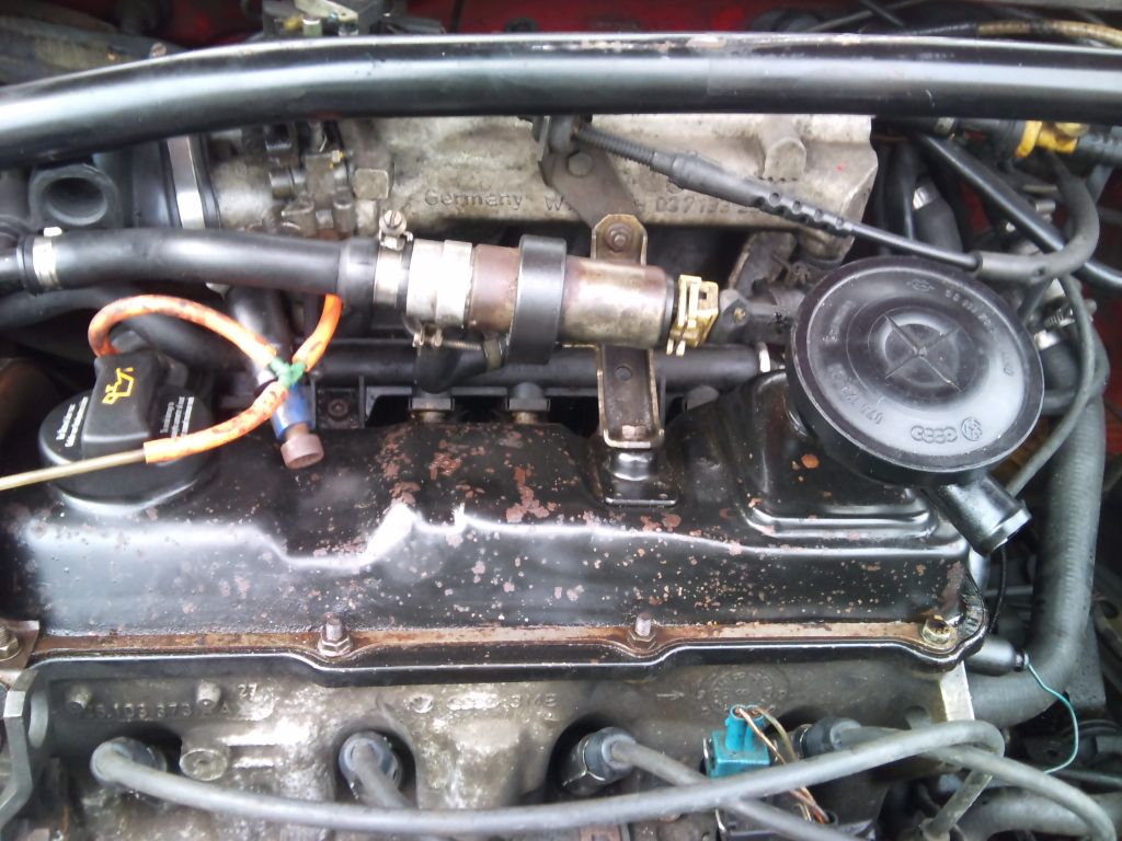

is there a hose missing here as it seems something has been blanked off?

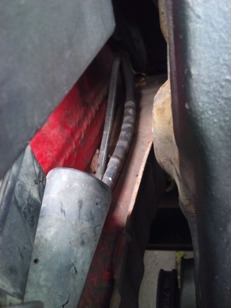

This part coming off the airbox seems to be missing a pipe that connects around the manifold injector area on the left side of the engine?

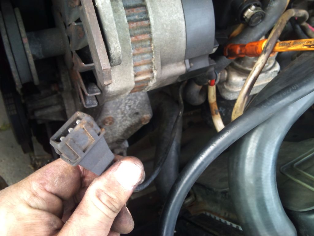

I found this plug wrapped up and cable tied together behind the oil cooler, cant find exactly where it comes from or what it plugs into?

Have a look at this for the missing pipe:
There is a 52mm flexible pipe that goes from the airbox to behind the engine - you can just see it here under the the green air filter

I would bet the plug is for the knock sensor, do you have one bolted to the front of the block, slightly obscured by the alternator?

are either of the pipes important? ie, if they arnt replaced will they do any harm?

The price you can get the pipes for and the fact they will tidy the bay I would replace them.

Looks like a mk3 golf crank sensor wire and mk3 bottom end (2 litre conversion)  :nerd:
If its the crank sensor (sensor fits behind the front engine mount bracket) then cut it as you don't need it.
You do look like you are missing the knock sensor though? Something you should have!
If it idles fine then I would leave the air pipes as you just end up with oil in the inlet. Would fit an oil catch can.
The airbox missing pipe is fine. I would remove the restrictor in the airbox if its still in there.

mk3 2.0 AGG or ADY bottom end (crank sensor versions) The black box on the block and the crank sensor is a dead give away.
You need to leave the crank sensor in or oil will spill.  :grin:
