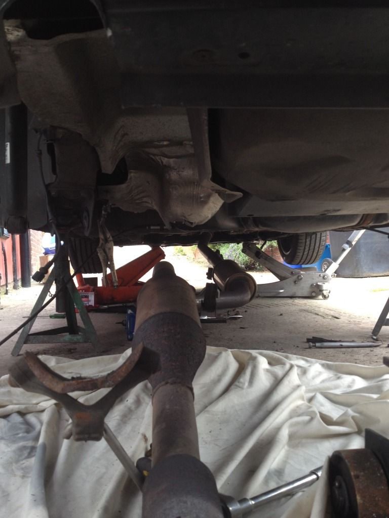

Just finished fitting it  :cool:
I'd day it's a pretty good fit the clamps arnt the best so I used the u clamps mainly
Also did my rear beam bushes at te same time
Started by jacking up
Unbolting downpipe and Removed the centre exhaust bracket and completely dropped the rear beam
Sorry about the lack of photos kept forgetting ha
Uses a small jack to hold exhaust up when I unbolted mounts
Then dropped the exhaust
Then removed  :cool:
Old versus new
Can't really tell the size difference on photo
But there is a big one  :grin:

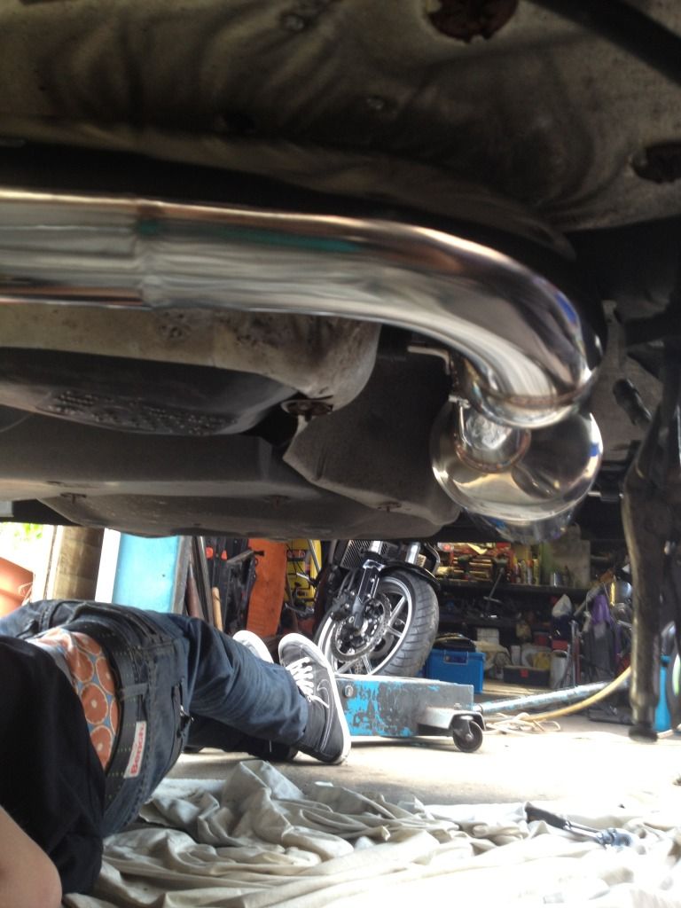

Then fitted new exhaust
First the back box
Then the downpipe and centre section
The the over beam piece
And bolted/clamped it all together
Then fitted the new rear beam bushes
And then put everything back together  :cool:
It's not as loud as my
Old one at low revs/idle but sounds sweet under load  :evil:
