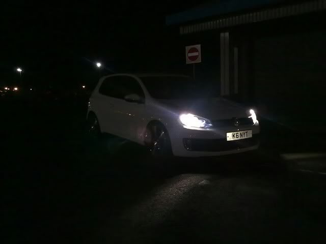

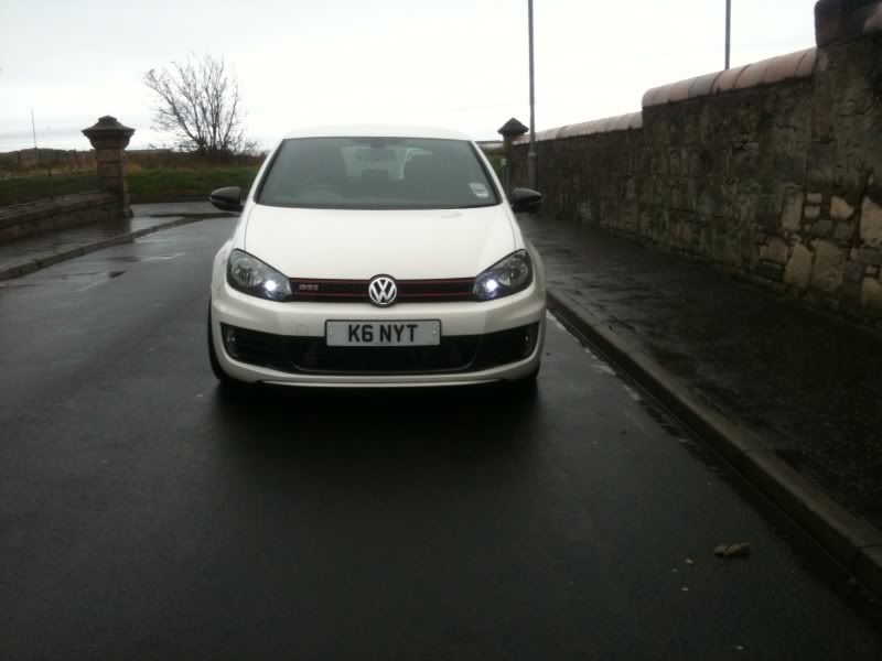

Dipped beam - H7
Full beam - that horrible DRL bulb which their is no replacement for as far as I am aware.
Sidelights - 501 wedge ( expect bulb out errors with the LED ones )
Led sidelights:
Aftermarket hids h7r bulb ( designed to cut off and not blind ppl!)
and yes they are still illegal.
