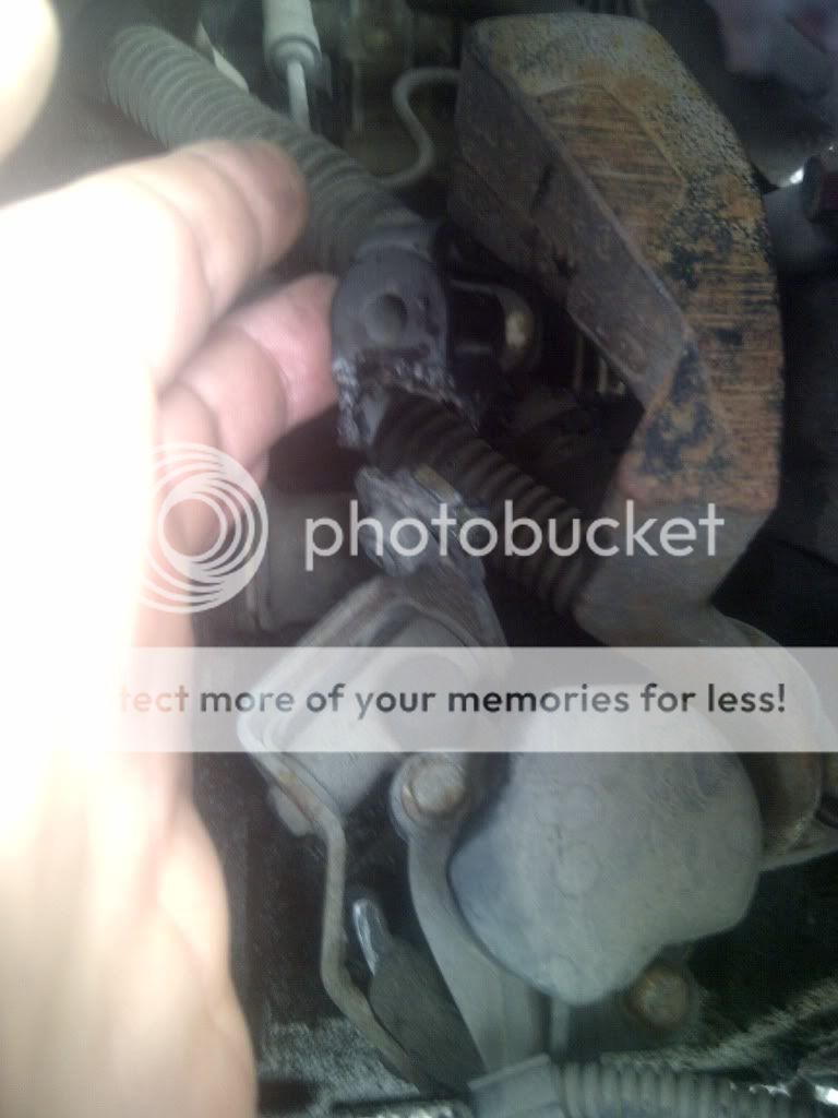

My mk4 golf gti non turbo and basically it will only select 3rd and 4th the problem is that the selector cable has snapped at the gearbox end now im wondering if anyone knows the correct name for this part or the part number i will try and get a pic if that would help.

Here is a pic of the broken bit

that is perfect where did u find that i need part 46 in that diagram

46 1J0711761A
  bowden cable catch / F >> 1J-1-542 139
(46) 1J0711761B
  bowden cable catch / F 1J-1-542 140>>* / also use: / to be used for:
N 908 159 03 POS.41 /
(46) 1J0711761C
N 908 159 03 POS.40 /
