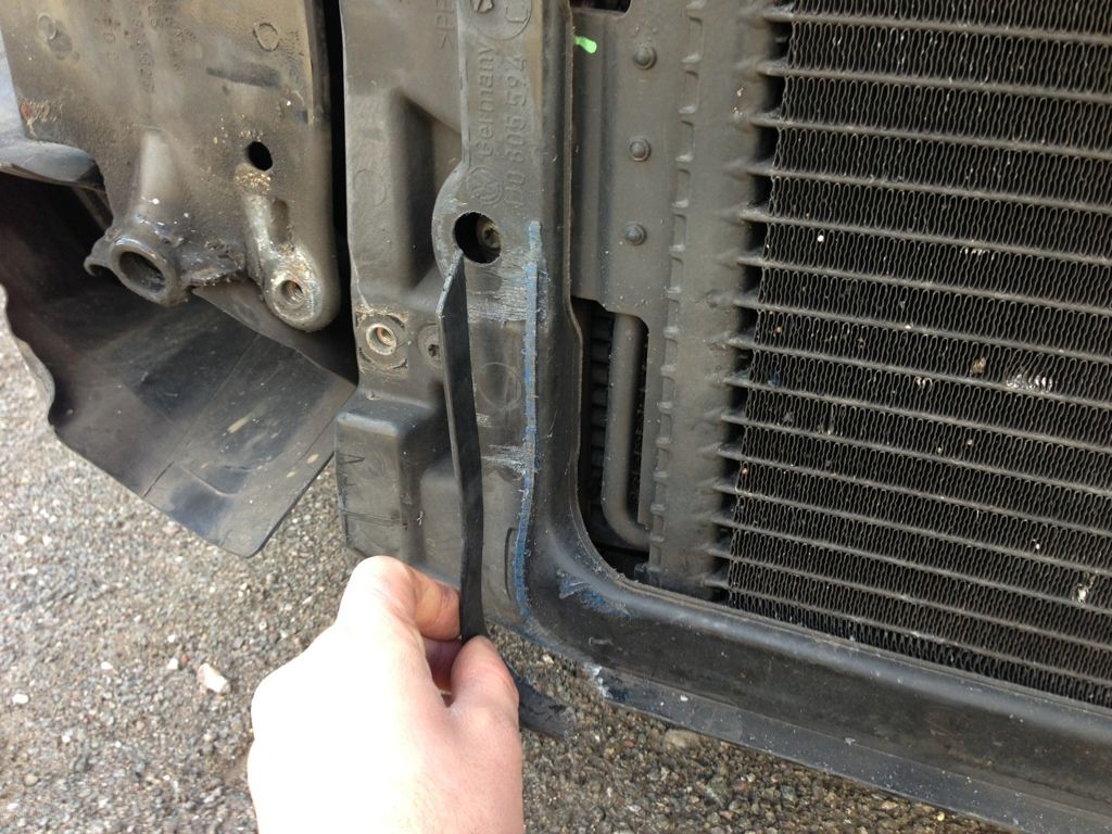

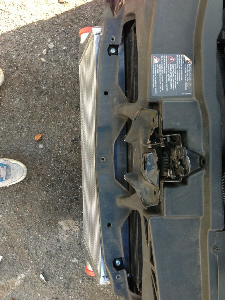

started fitting the front mount aka 'the beast'
so a few shots of how it going
cut the bottom of the latch bracket
cut away some of the panel to help bring the intercooler as far back as possible
cut an access out and drilled into the frame (where the bumper fixes on to) to fix the intercooler on to
offered up crash bar and marked and cut it
and fitted
offered the bumper on and gave it a little trim, but still needs a bit more, but that will come when i get the hoses on.
thats all the main work done for now, bumper shouldnt take long to finish once its on  :smiley:

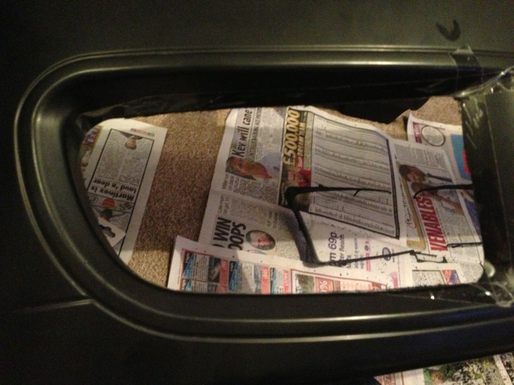

Can't do much at the mo as some pipes are out of stock but decided to trim the bumper down last night, as it would foul the intercooler pipes
Before
After
Bad pic I know!! Decided to cut a flat surface rather than a circle for the pipe work so I could still put the mesh in without it looking like I gave the bumper to a butcher to chop!!
