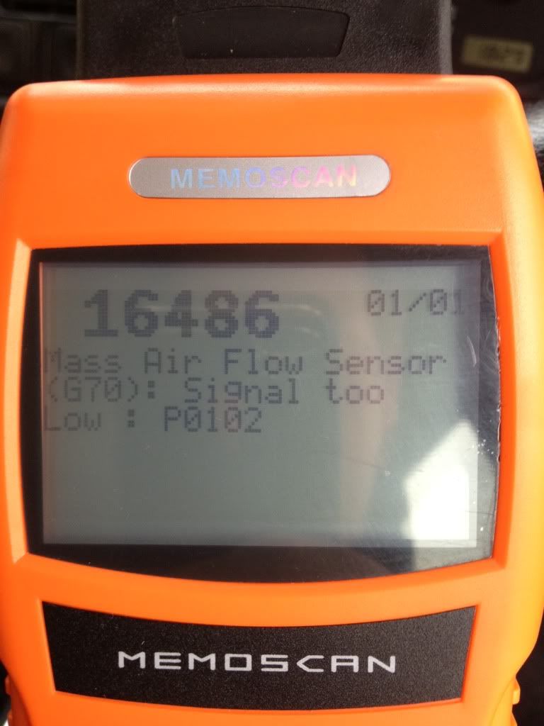

Hi
Everyone......I just wanted to thank everyone for the advise and guidance.  Found my VAGCOM and tested the car and found this fault code: -
Order a new part now so hopefully, this will resolve the rough running issues.
Really appreciate the help  :smiley:

I don't want to piss on anyone's bonfire but, spot the obvious flaw in this plan.
Unplugged the MAF......didn't feel any difference either way really.  Just as bad tho :sad:
Quote
I'd see if you can cancel the order and just do a bit more investigation.
Try resetting the codes (and disconnecting the battery for 30mins or so). This will reset the ECU trim values.
I'd put money of it being the lambda sensor over the MAF. Have you got the car mapped?
