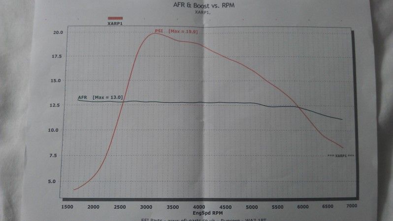

Took car to check hp after fitting few things fitted forge actuator to ko3s, forge dv and velocity stack intake. While on roller notice from print out boost dropping off poss to quick. There are no faults in ECU have n75f valve fitted. Any ideas??? Running APR stage2 map.

Actuator setup properly?
Maybe the style of mapping?

boost leak?

Actuator set up I reckon, How many turns did you turn it to preload?
Also what colour spring have you used?

3 full turn back and both dv and actuator have yellow spring. Car made 220bhp and 257ftlb tq so power itself is about right just dont understand why drops off like that.

Poss boost leak if so how do I check???

Maybe map then? who mapped it?

I'll pop into awesomegti on way home ask them, there doing APR again instead of revo. Car itself drives spot on, just noticed it on roller print out. Can u with vagcom check actual and specified n75 reading???
