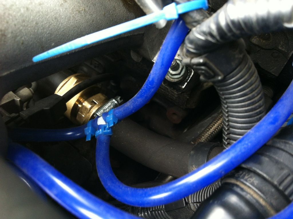

so the place i went to buy it from for £12 or what ever it was is now out of stock  :undecided:

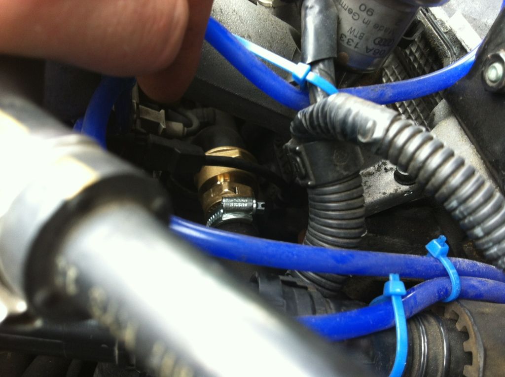

so i used some 22mm copper and a 1"x22mm female connector and it screwed onto the half snapped elbow lip perfectly!!!!!
that fix cost me £0.00!!!!!

as long as it holds id leave it like that looks a better job than the standard one  :cool:
Went on nice and tight and is solid, test tomoz 120 mile round trip!!!
