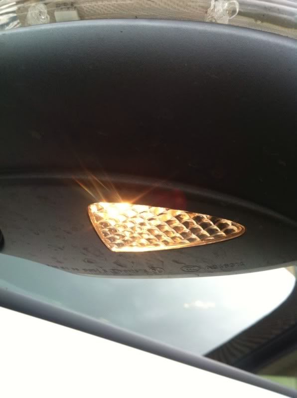

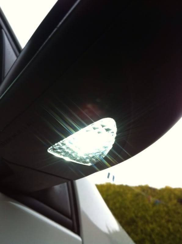

Yes, the glass has to come out. Not as daunting as it sounds! I took the glass out 3 times on my drivers side (long story) but I managed to crack the glass on the passenger side on 1st attempt! €40 for replacement glass from VW! Anyway, if you are very careful you should get away without breaking it. I did manage it on one side after all. Some plastic trim removal tools are useful also.
There's a guide for doing this somewhere on this forum that I followed. But basically, dip the glass down as far as possible and gently lever in behind the glass around its centre point. It's clipped in. If you lever at the sides you'll more likely stress the glass and crack it.
The result is worth it IMO!
Before:
After:

These are the exact ones I got - http://www.ebay.ie/itm/270790422041?ssPageName=STRK:MEWAX:IT&_trksid=p3984.m1438.l2649#ht_510wt_689
They are canbus W5W. I believe that non canbus will register an error on the ECU and these ones won't.
I only did this mod last week, so it's fresh in the mind! Any other questions, just ask. It's deffo worth it, makes a big difference, especially when unlocking the car in the dark obviously!
