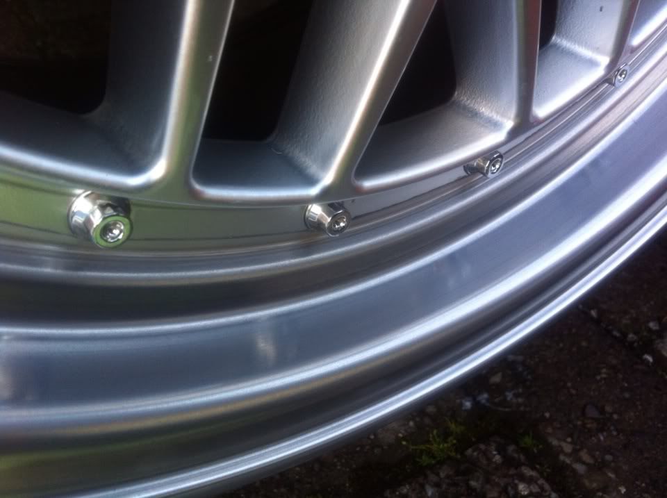

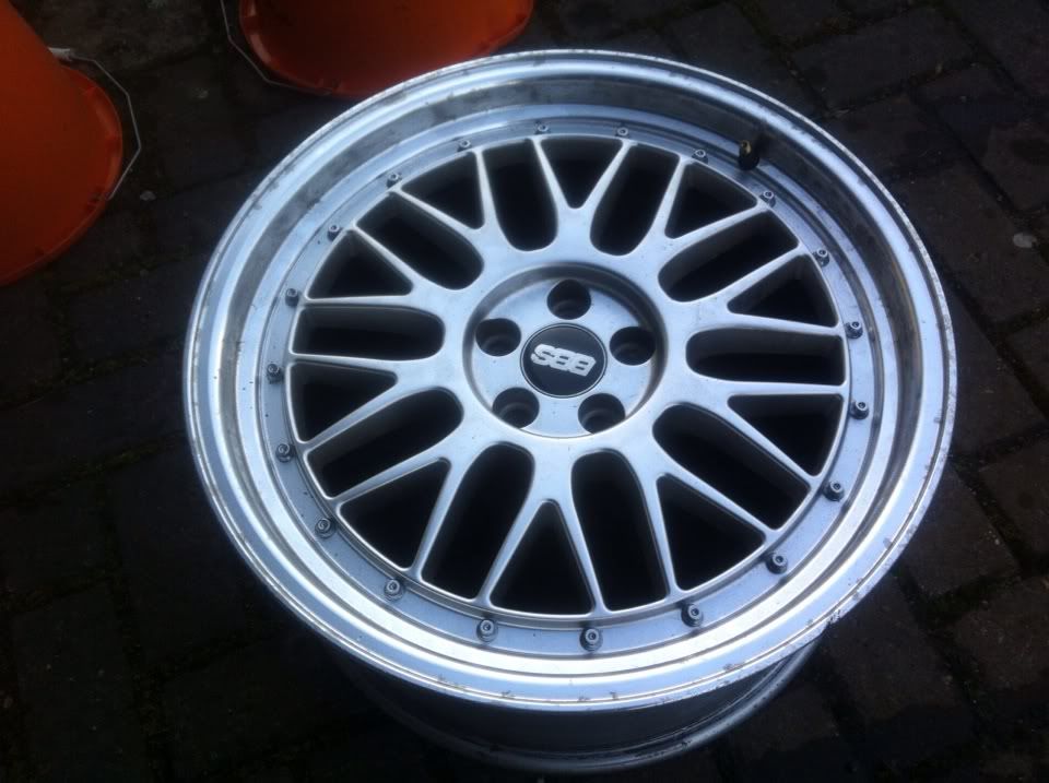

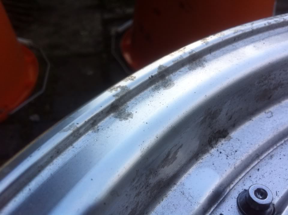

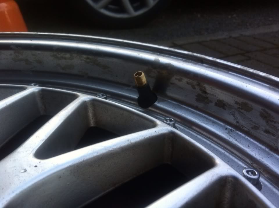

hey guys, so seeing as today was so nice thought id take advantage and get started on refurbing my LM reps for summer :)
first off this is the problem im faced with, laquer peel to the maxx

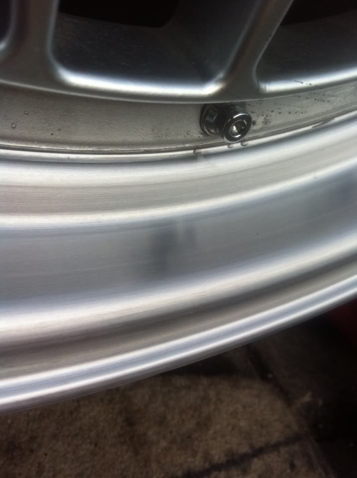

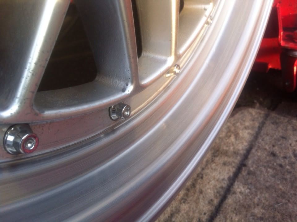

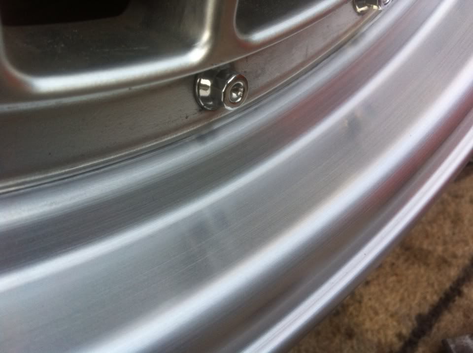

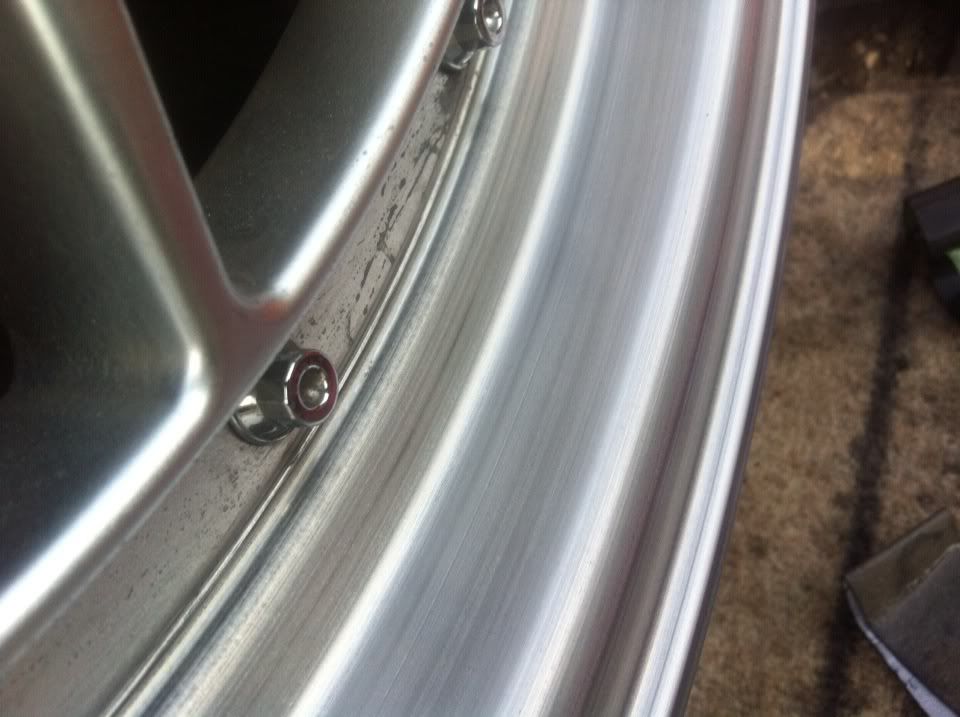

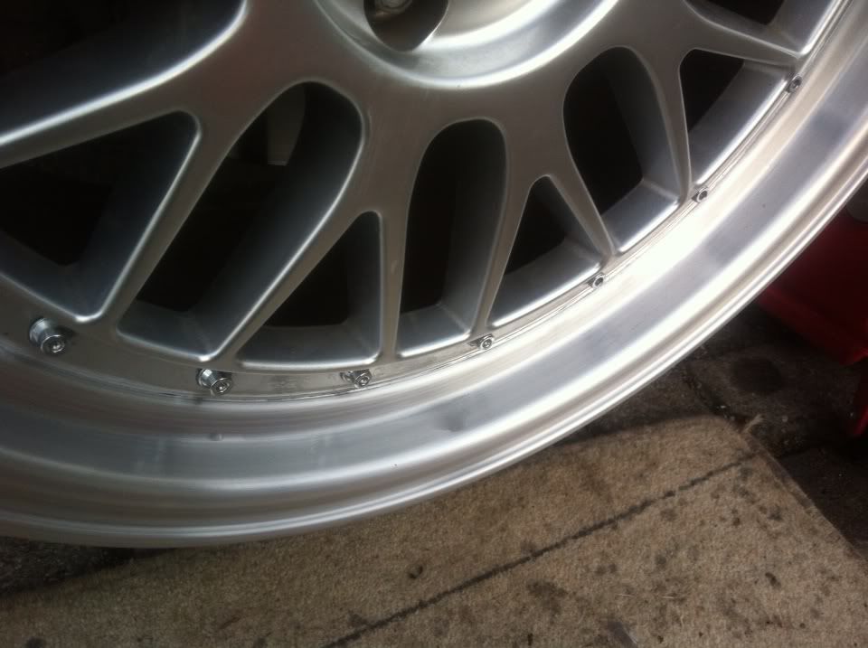

first off started with 240 grit to get the laquer off to start with, next used some 400 - 2000 grit wet and dry pics as follows.
400 Grit
600 Grit
800 Grit
1000 Grit
2000 Grit

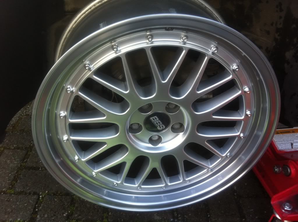

next i used some Auto Glym metal polish and a micro fibre to polish them up, not sure whats better than a micro fibre so suggestions welcome.
any suggestions for a better polish welcomed as i dont have them to the mirror finish that i want just yet, also any advice / opinions welcome :)
