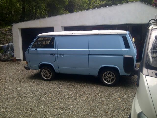

And a cheeky set of new wheels... Need to get extended rear studs as the original ones are a little short.
Still got a bit to do, I can't decide on the roof colour, I'm torn between black or white, suggestions welcome!

It looks better than I thought it would, good effort.
I personally would leave the roof white, I think black would clash with the light blue.
You could always paint brush the pic on your computer to get an idea though  :smiley:

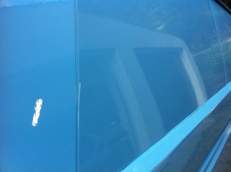

Can you get some close ups!? I'm really considering doing this to mine. What needs doing with regard to the prep? Will it cover/fill scuffs and stuff? Does look pretty decent from afar though.  :smiley:

Finish has a slight orange peel, although you can flat it down for a mirror finish. Personally I'm not gonna bother for now as it looks fine and its transformed the van.
Before you paint, it has to be flat, I first used a DA with 80 grit on the bottom half as it had been brush painted before, then filled any dents etc. Then 320 on the DA everywhere. Then panel wipe then roll the paint on. No need for primer! Full instructions are on the link I put on the first page...
Its not a quick job, I reckon I have put in at least 25 hours so far, and thats mostly with a high power air DA, I still have the drivers door and front to do, although these bits have nearly all been 80'd and filled so its nearly there. I'm hoping to have it all finished tomorrow.....
