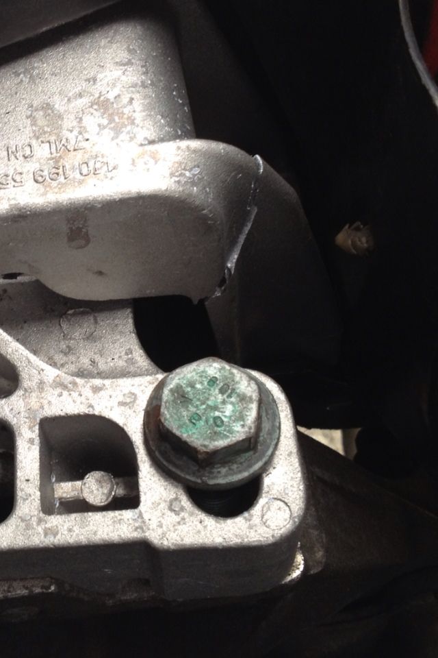

Here is what it looks like .......
Thee other side is a Smaller crack
Not sure if this picture is of your actual mount but in the above picture the engine mount failure could possibly be the result of improper installation, just look how out of alignment the mount is! It's completely jagged. The bolt should sit centred on the top mount as to cover up the hole. Chances are because it's so far out of alignment the bushes aren't working and instead you have metal on metal contact.
Power would definitely not be the reason for the mounts failure in the above case. I've had mates run gt2871r on standard mounts for a whole season without such problems.

It wasn't that far out of line before it broke but now it's comletely on the piss which I think idvdue to the engine dropping and moving  :undecided:

Not sure the bolt should move so easily it is supposed to hold the engine while driving after all. Perhaps they were loose. It's odd that both your engine mounts went.

Mine started to crack in 2 places.  passenger side.  I just swapped the casings over off a set of spare stock mounts.

which is what THS do anyways :wink:
Hmmm will see what they say first but may end up doing that ha :smiley:
