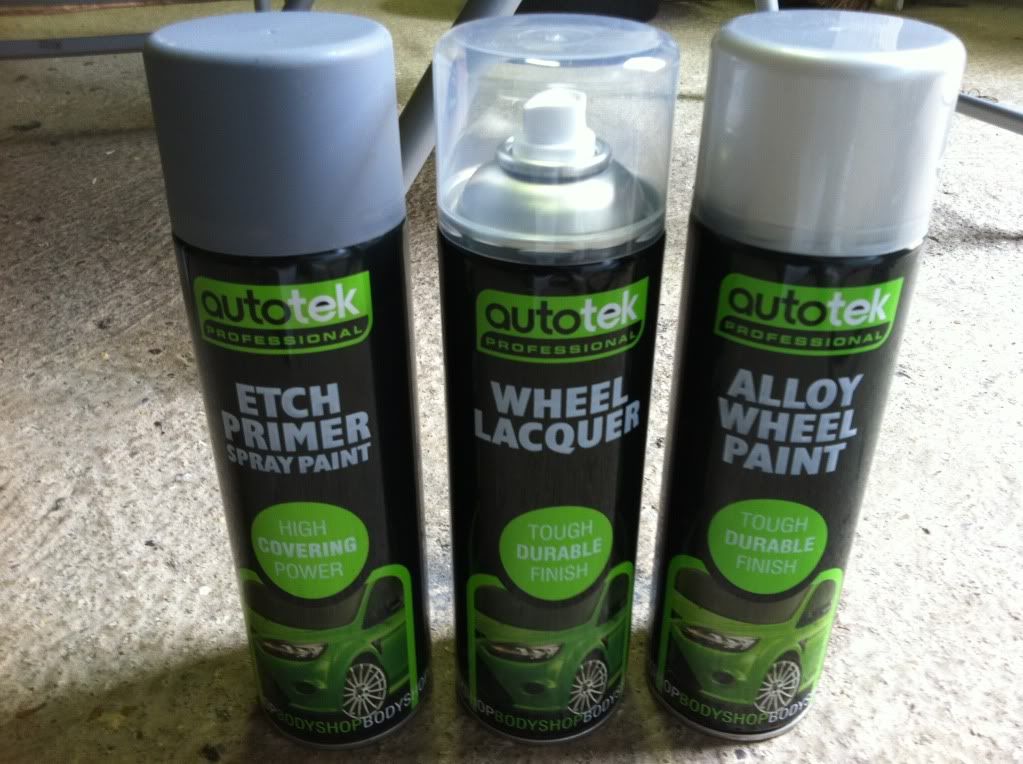

So to start off I got myself some spray… now I didn’t know what sort to go for, so in the end I decided I would go budget and got these
2 Primer, 3 Paint, 2 Lacquer all 500ml.
You could go for a more expensive paint etc but I though I would give these budget ones a go because I got all of them for £18!!

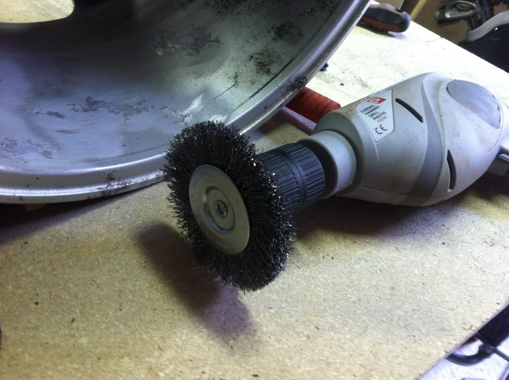

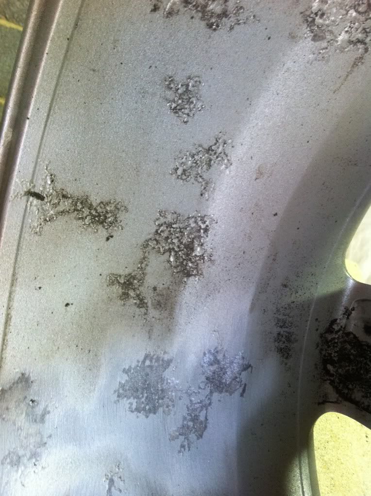

For the insides of the wheels I got this bad boy

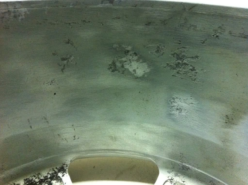

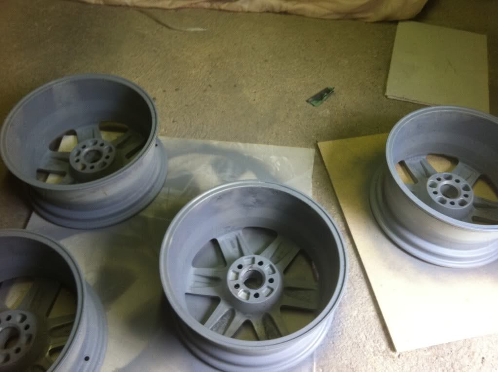

It would have taken me an age to do the insides of the wheels by hand as they were heavily corroded. (Below)

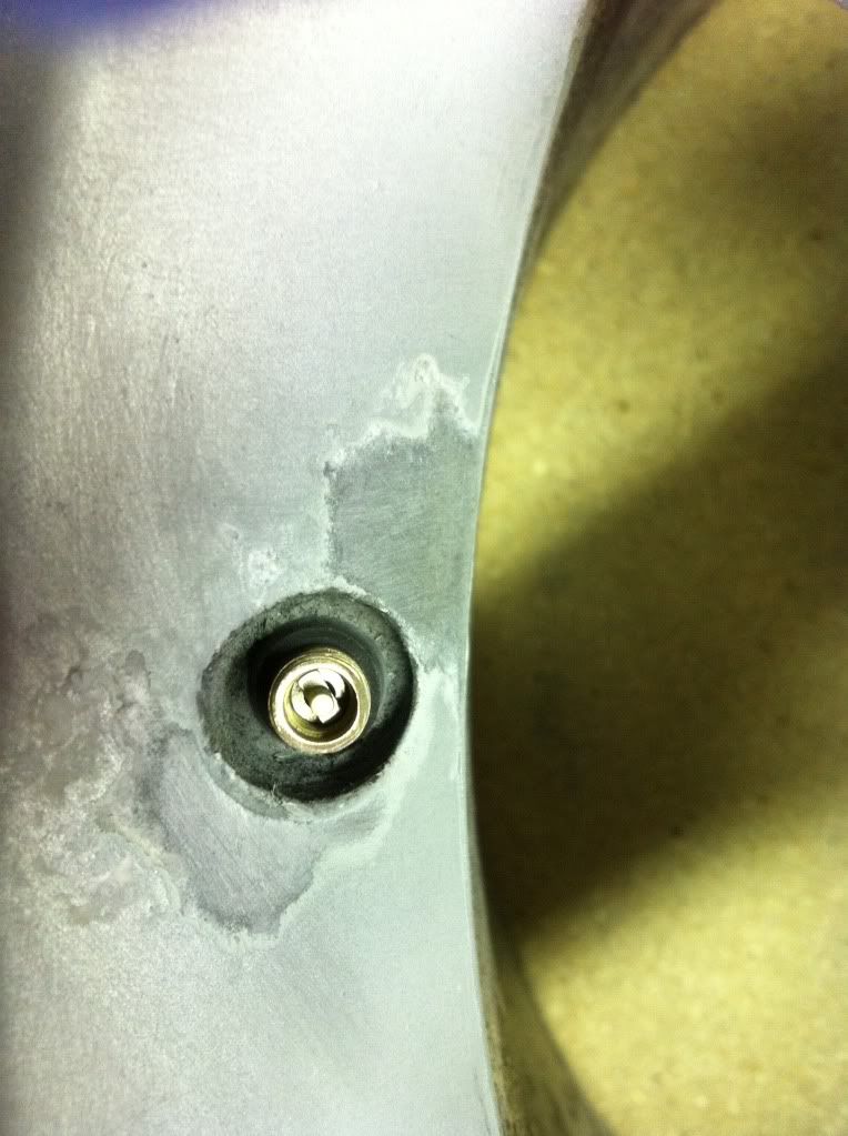

So I cracked on with the sanding and after a good 1-1/2 – 2 hours on each wheel I was ready for the primer, now as you can see by the pictures I’m not looking for a ‘perfect finish’, just something decent that didn’t take me ages….

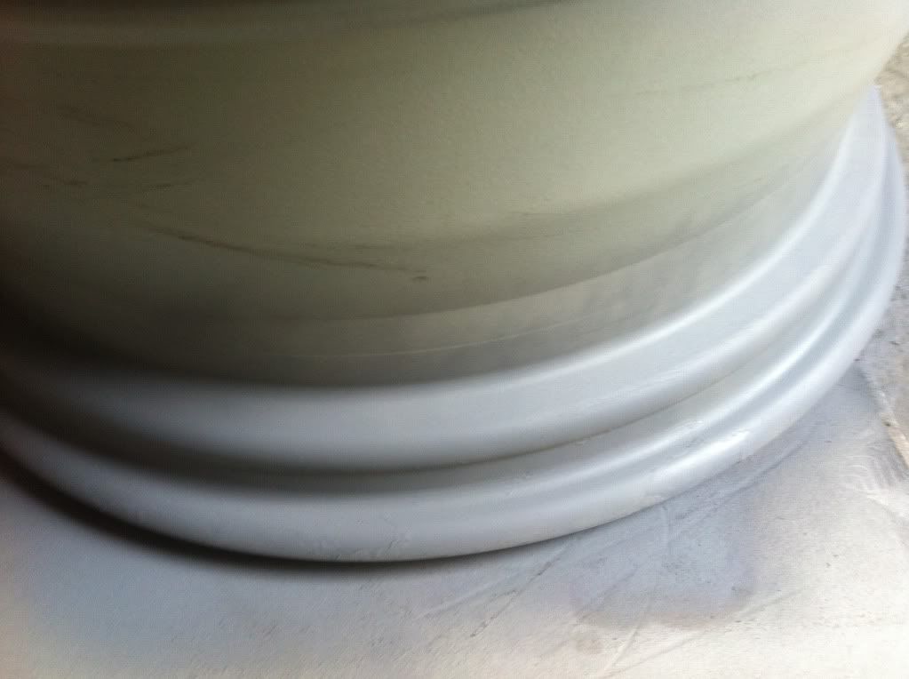

Next I had the tyres whipped off and gave it a good sanding round where the tyres sit as I think I had a couple of slow punctures from the rim (the smoother you can get it the better).

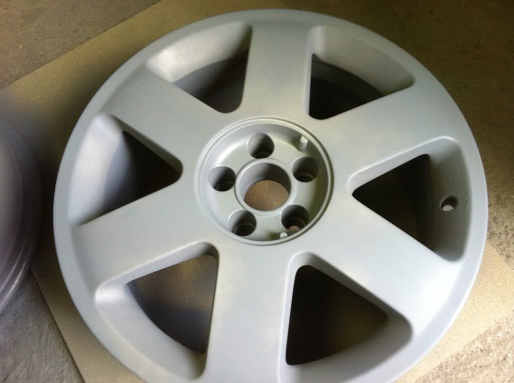

So onto the first coat of primer, I warmed the cans up in the warm water and cracked on with the first coat
Then the second coat

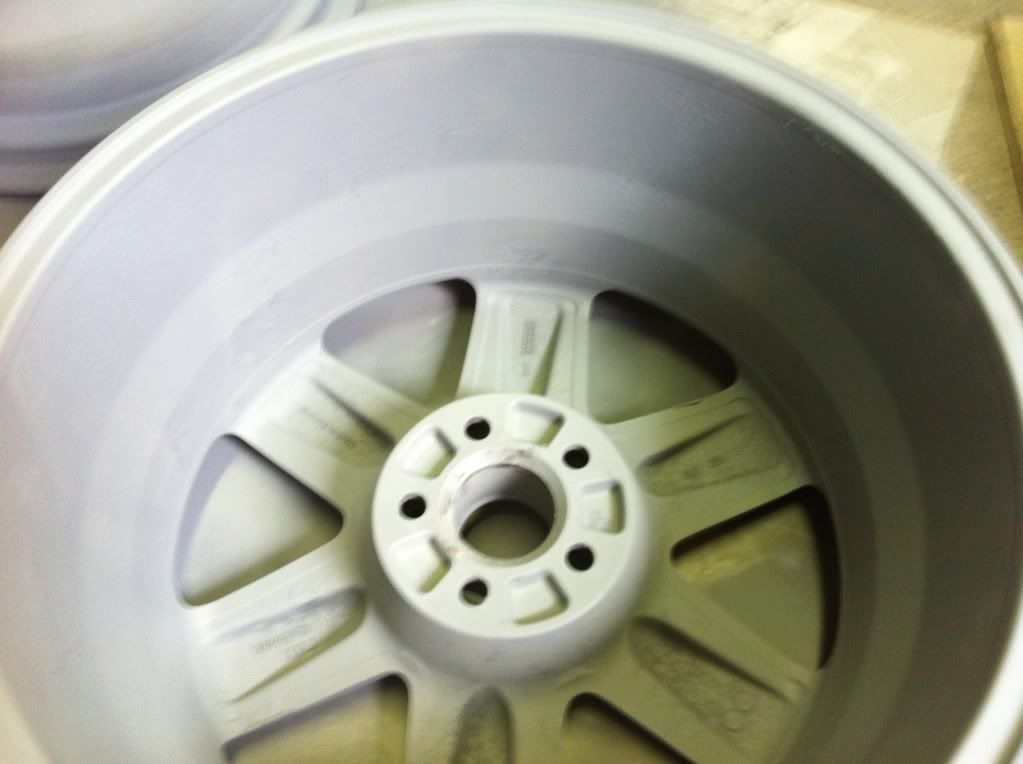

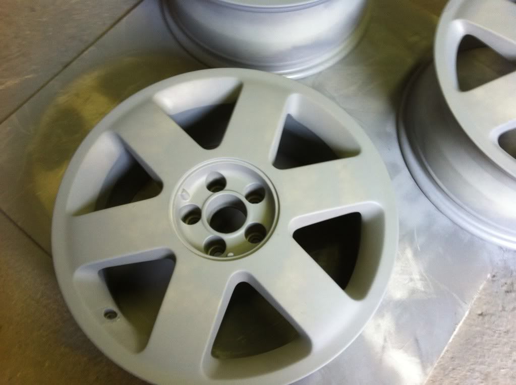

Then 2 coats of primer on the fronts

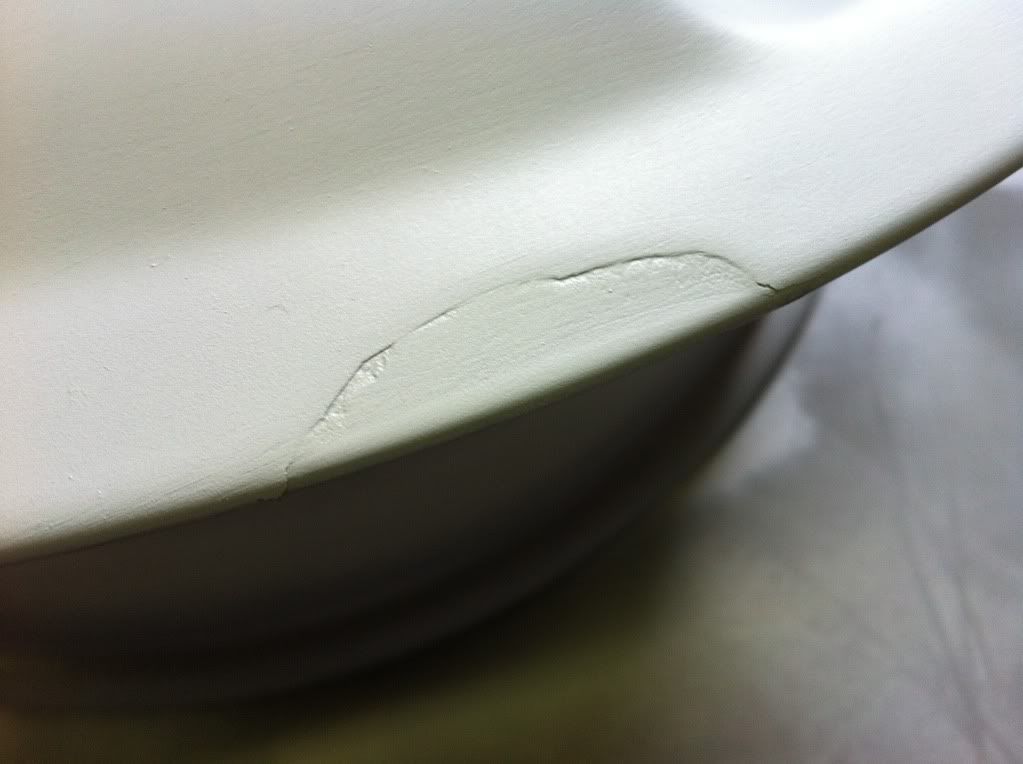

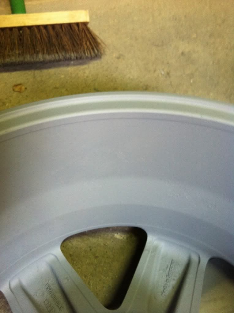

Now up close you can see where I’ve been a bit lazy and not flattened off the edges on some of my sanding, so out came the wet and dry… again.
Wheels are all sanded and re-primed, 2 coats in total and I JUST had enough, I’m happy with 2 coats, don’t think a 3rd would make any difference but you’ll defiantly need another can if you intend on doing 3 coats.
I set my heater up in the garage and let the primer harden for around 45 min, then I took some 1000 grit wet n dry to it just to smooth the finish a little, I didn’t go mad as it would just fetch the primer off but a general rub down didn’t do it any harm. I used lots of water, gives you a nice smooth finish.  I have taken the primer back to the metal in some areas, but im sure all will be good once i get my paint on  :cool:

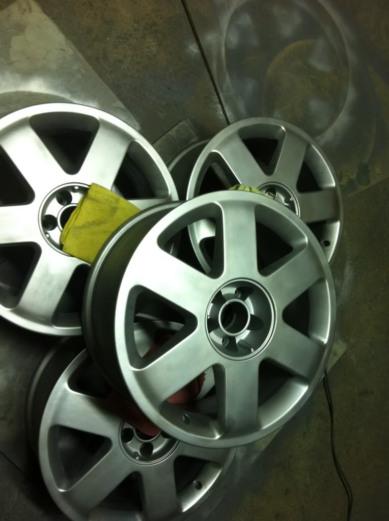

Re: My Alloy Wheel Refurb Project
« Reply #3 on: 11 May 2012, 09:09 »

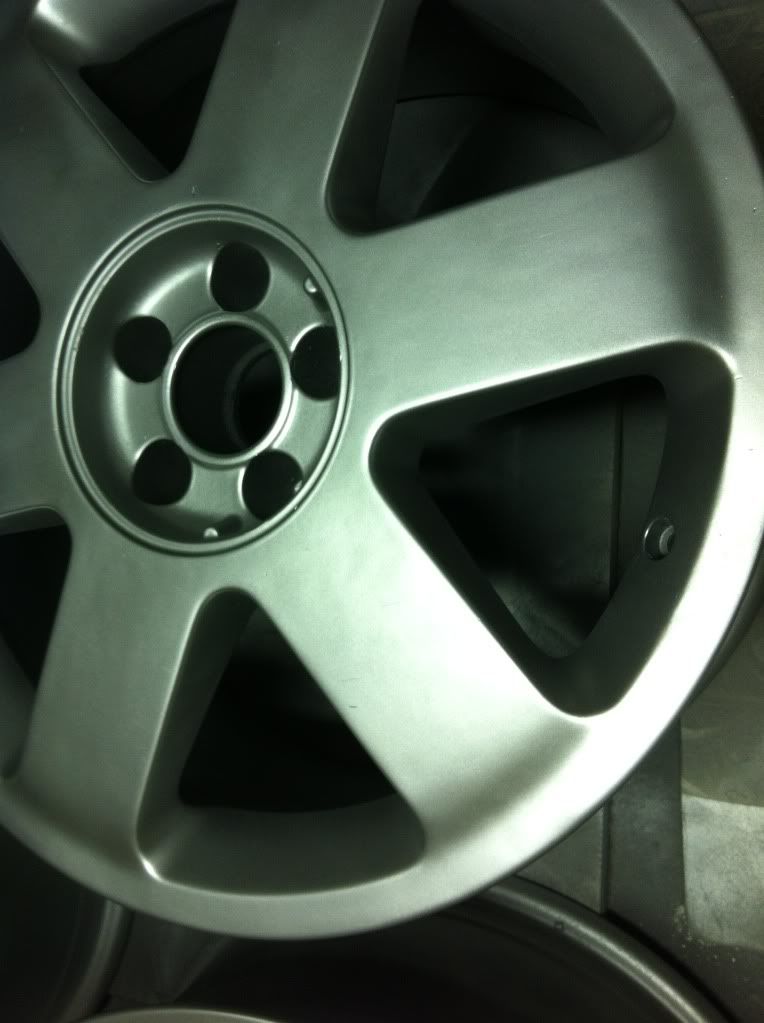

Got them painted yesterday afternoon, did have to patch them up along the way due to my lazy preping but im happy with the result...
The result is by no means perfect, however if i would have spent longer prepping it would have been near perfect.
Now for the Lacquer... the paint can actually says not to lacquer!?  however im guna ignor that and crack on  :laugh:
« Reply #6 on: 14 May 2012, 20:09 »

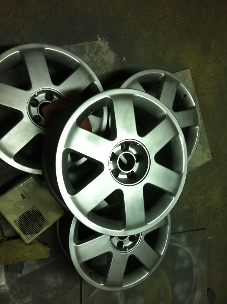

Got them finished off on Friday, just giving them a week in the garage before getting the tyres fitted on Saturday.  Will get some pics up then  :cool:
The only thing im stuck with is centre caps  :undecided:  theyre a slightly different colour, dont know if they'll stand out really bad, so just going to stick them on and see where to go from there.

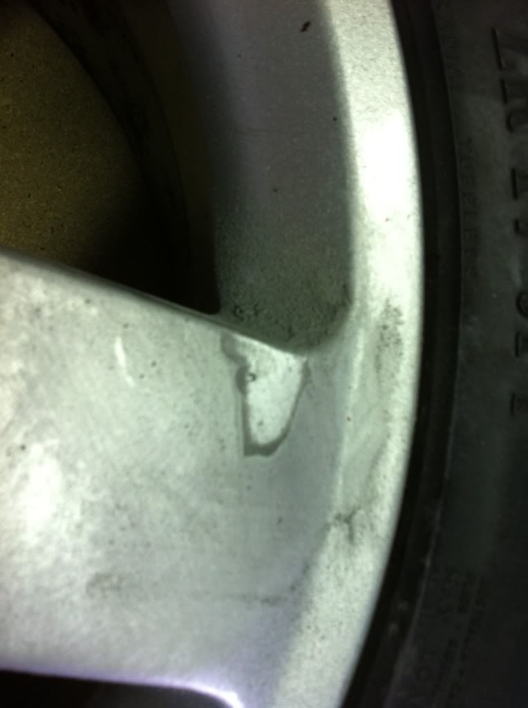

I'll have pictures uploaded next weekend of the finished wheels on the car, i should have got them on this week but the chimp in the tyre fitting place chipped one of the alloys  :cry: , there guna "sort it" they said so ill have to wait until i get home on Friday to get them fitted!
