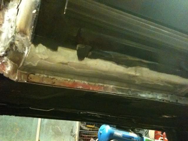

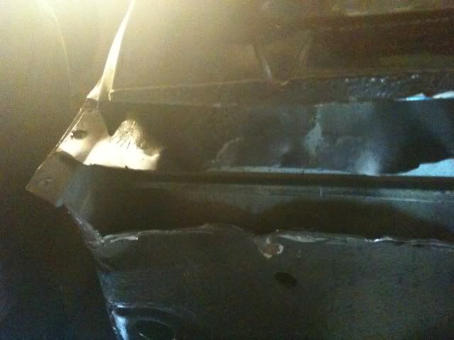

Just started doing the sills on my vr6,but the floor is badly damaged :0(
rebuilding it but,just wondering if I can buy new jacking points or what can I do????

Take off the sills and pull down the floor/ sill flange section. Thats what they had to do with mine.
The jacking points are part of the sills and the inner floor section, you cant buy them seperate.

so dude what i´ll have to do is rebuild them???
the floor has been pushed up inside the car where some muppet as used the wrong jack i think

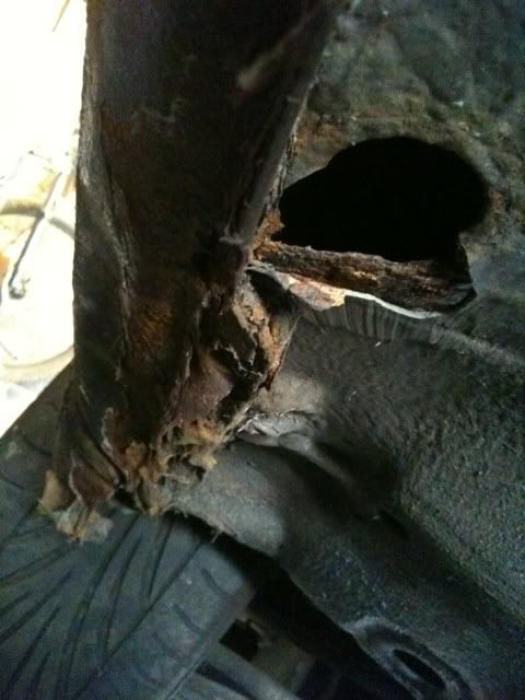

I did this. You need to use a different thickness of metal for the jacking point area. I had to remake the section from the sill inwards around 3". The plastic bungs are another culprit of rust and I've welded over most of them.
More pics in my thread.

omg erm..................
i actually thought mine was bad.lol
i have little holes,not that massive.lol
could you send me a link to your thread dude
cheers,looking good mate
