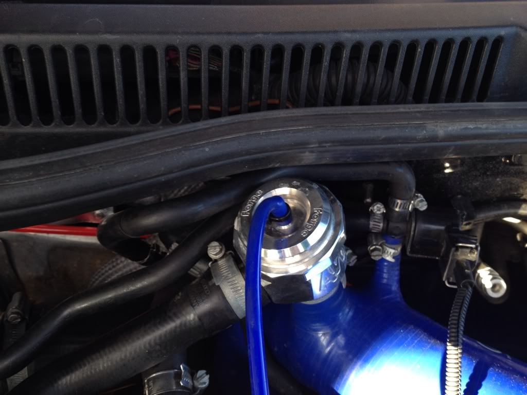

Do you know where the 007p goes? Possible the easiest mod to do, two jubilee clips and a small pipe, standard one is a small black plastic one ontop of your tip (to the left of your airbox and right of your engine rocker cover. You just loosen the two jubilee clips and remove the top pipe then put the 007p in its place should look like this.....
Apart from the blue pipe will be black  :grin:
