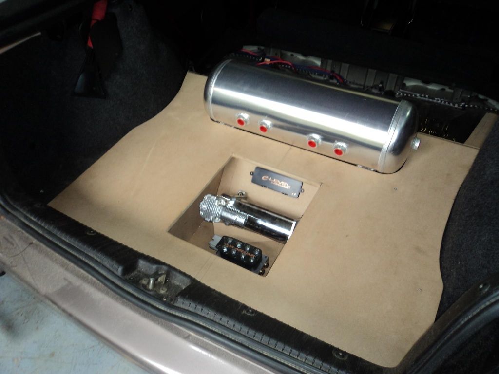

Me and Matt discussed a few ideas when I dropped it off and wether they would work and we came to the decision of mounting the tank at the rear. everything else will be in the spare wheel well and covered so not to get damaged when being used daily. Will be a cover so can be removed for show use.
We could have put the tank in there aswell but because it was so shallow the floor would have to be really high and then the boot would have been pointless so a compromise was made. To be honest I'm happy we did as I think it will look better.
Here's the 1st couple of pics I saw.

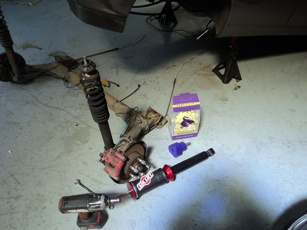

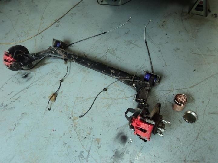

And fitted up my rear beam with new power flex bushes.

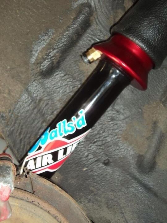

And all re fitted with air lift struts

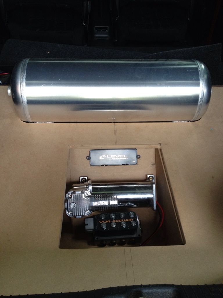

So another update from the Balls'd Facebook site.
So Matt got it sitting down on the rear but will still need a little adjustment for the look we want. Arch between tyre and lip.

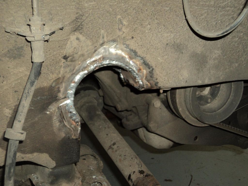

Next he went to work on the front and has said that when i was running coilovers the driveshaft had been making contact with the chassis leg. This obviously won't do for the new lows so a chassis notch was sorted.
Awesome work by Matt again. U can also see on the shaft where contact had been made.
