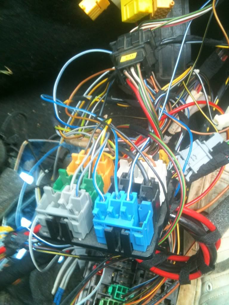

dunno where to start with this, doing an abf conversion at the moment mk3 16v into mk2. ive taken the subframe out with engine and box- the lot. problem ive got is i am trying to take the immobiliser and induction loop out of the mk3.
i need to know what this is for:
ive got a black wire going into it from the immob and i need to know if i can junk it or what i have to do to convert it to the mk2.

its the black plug in the middle on the right :smiley:

Doing mine ATM...
Pedal Box - Why not just stick with your standard 020 box and clutch set up?? The clutch/fly off your mk2 will fit.
MK2 Air Box is no good (no space for the breather IIRC) nor is the MK3, you'll need one of a ABF toldeo (or Ibiza?!?!)
The black wire needs to be connected to an ignition live in your mk2.
