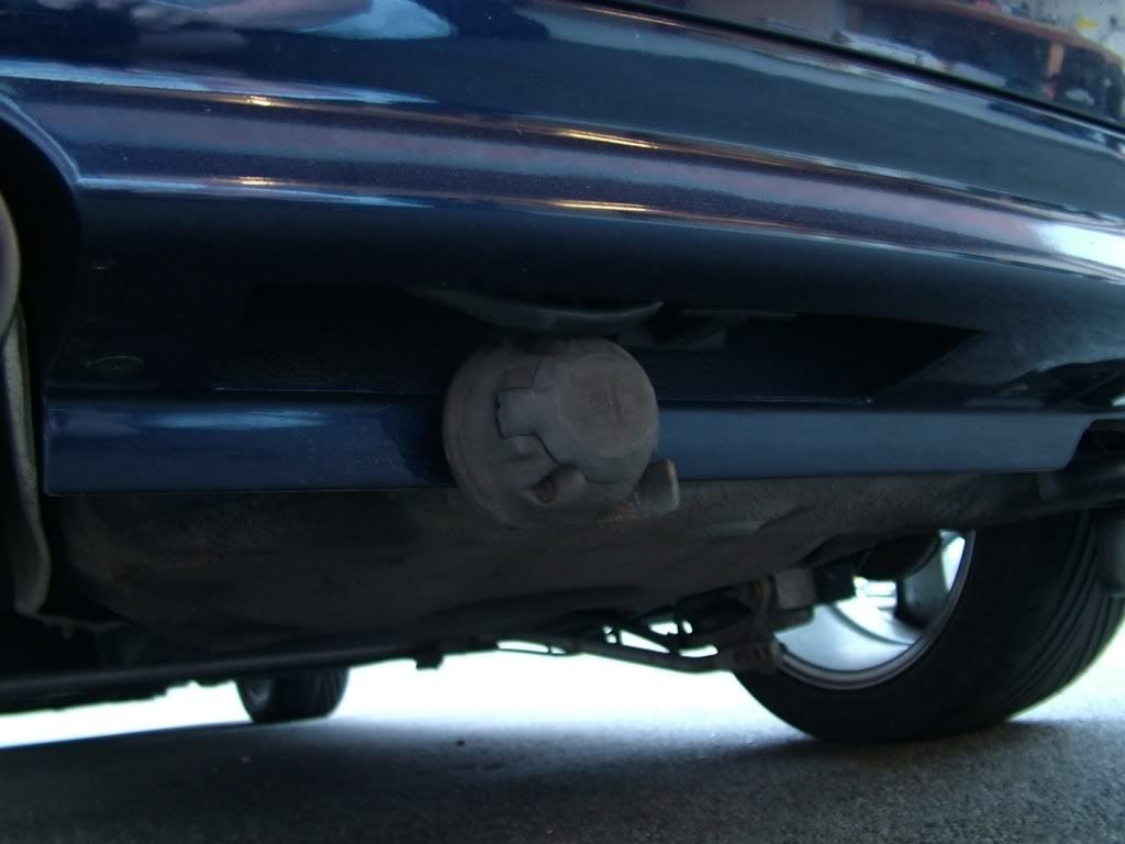

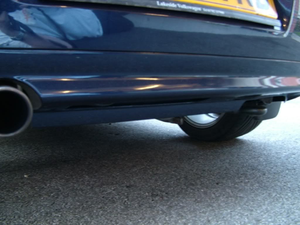

You need to chop the valance for every type of tow bar.
Ive got a detachible swan neck type and had to cut about 189mm x 80mm out the valance but when the tow bar is removed and the electrics plug is pushed up you can see anything.
With the normal type tow bar you can remove the tow ball but will have the bracket and electrics still on show.

Like Steve I have the VW detachable one, you wouldn't know when looking at the car from behind as the slot cut in the valance is underneath :afro:
No sign when not viewed from underneath  :cool:
