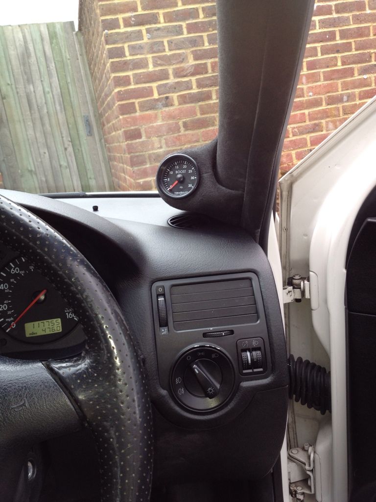

thats how mine is on idle sits on -20 under load gives your boost whatever it is and engine off sits at 0 so summat wrong there dom

Dom check the line from the back of the gauge, give it a suck and block it off with your tongue and see if it drops on the gauge. If it does you know it's leaking on that olive union.
I used to sit on -18 in hg on idle
I'll look at the video when I get on my PC and not on my phone

Will do, it's all hidden behind the dash now though :grin:
I'll wrap some cable ties around the t connector as well, I didn't have any earlier so left it without. There's a possibility that it's leaking there as well.

Right, so the problem lies with the boost gauge tubing some where then? I guess I'll have to check it over tomorrow!

I'll have a check over everything tomorrow and see if I can sort it, if not then that'd be great. I haven't done anything with the pipe coming out of the gauge, I assumed that the seal would still be ok. I think the problem is with my T connector personally, it seemed a little loose :undecided:
