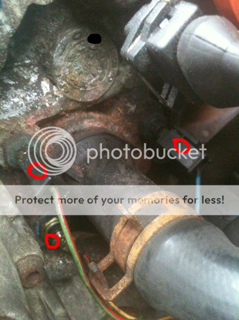

clean the three temp sensors on the r/h side of the head, under the dizzy. two of them control the idle control valve (ISV) and one controls the temp gauge in your clocks, they are the same so you can swap the wires around if one of the sensors are duff.
Any pic for them please
regards
The plug in top r/h corner of the picture is the one off the dizzy. Ive circled the sensors red, the bottom one is the one i replaced because of the same issue.
