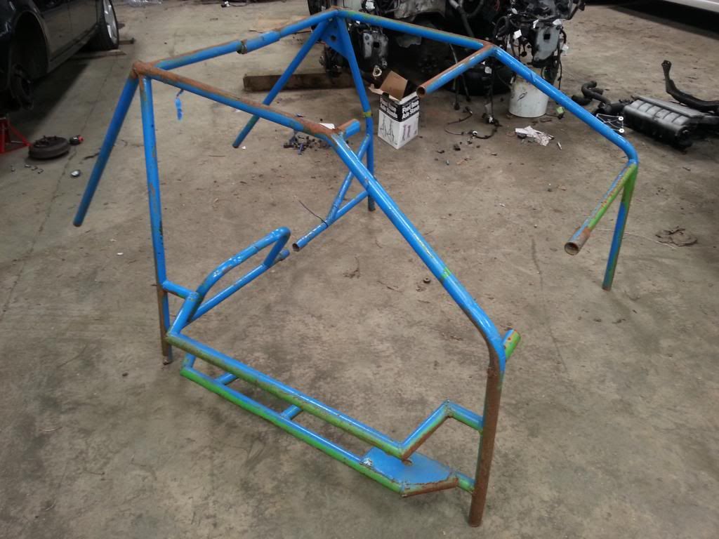

home made cage i take it dave?.. what steel did you use?. i want a cage for mine but i aint paying £800 for an omp one..
Can get a cage from ebay, as long as you can weld can mod it as you wish. Picked up this the other day from a corsa
Needs a bit of work but I thought a good base to start from and for £36 cant complain!  :smiley:
Need to read through all the specs now get it ready before fitting.

« Reply #535 on: 16 May 2013, 17:21 »
NO, that's no good - the main hoop needs to be a single tube.
What you've bought there is £36 of scrap.

« Reply #536 on: 16 May 2013, 17:24 »
Those welds look like they will snap right off in an accident, jon.
My welds or the welds in that Corsa cage?

Not yours, those welds on the ebay corsa cage.

The welds are f**king awful on it, loads of bits of unwelded wire on them, could do better with my eyes closed.  It will all be taken apart and rewelded just now have the bends and some of the material to do it easier. Want to do it right that why im following this progress and asking to make sure
