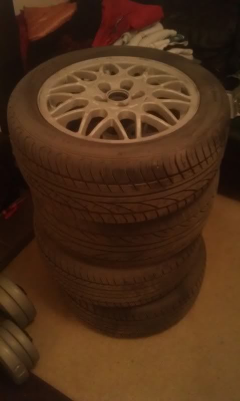

Intermediate wheels bought, sandblasted and ready for paint    :whistle: :laugh:

Love it! Did you shot blast them with the tyres on, prime then spray? Laquer?

Exactly that mate, sandblasted with tyres on, white primer, pink spray, then lacquer.
Not perfect, but certainly the result I was after    :grin:

Wicked. Cheap and cheerful eh. Beats paying £400 for a full refurb. Suppose the condition before hand depends though! Will certainly look different when on!  :grin:

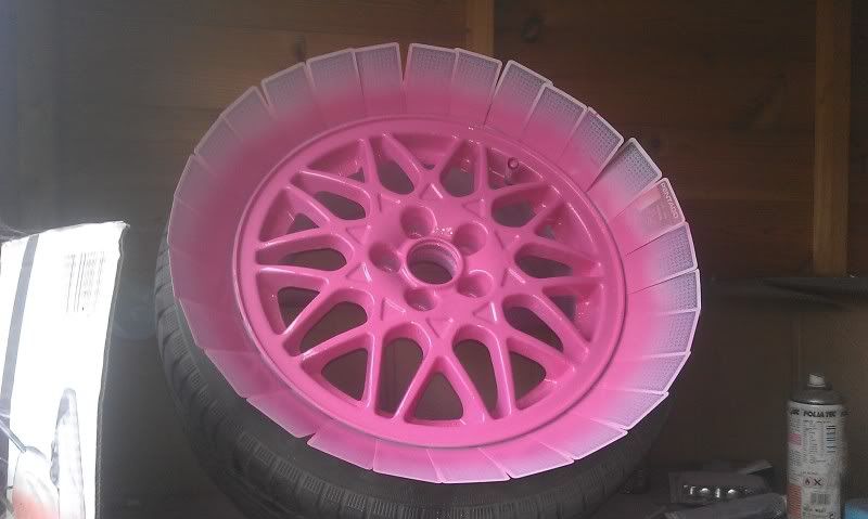

ghetto spray job, love it !  :grin:
They were really badly corroded which is why I give them the once over, sandblasting will clear up the actual alloy corrosion/bubbling too!
You know me  :laugh:

loving the card masking method too -  :whistle:
I'll bring your attention to the spark plug cardboard cover masking the valve  :grin:
Unfortunately these wheels only came with one dustcap, so it's doing the rounds  :laugh:
