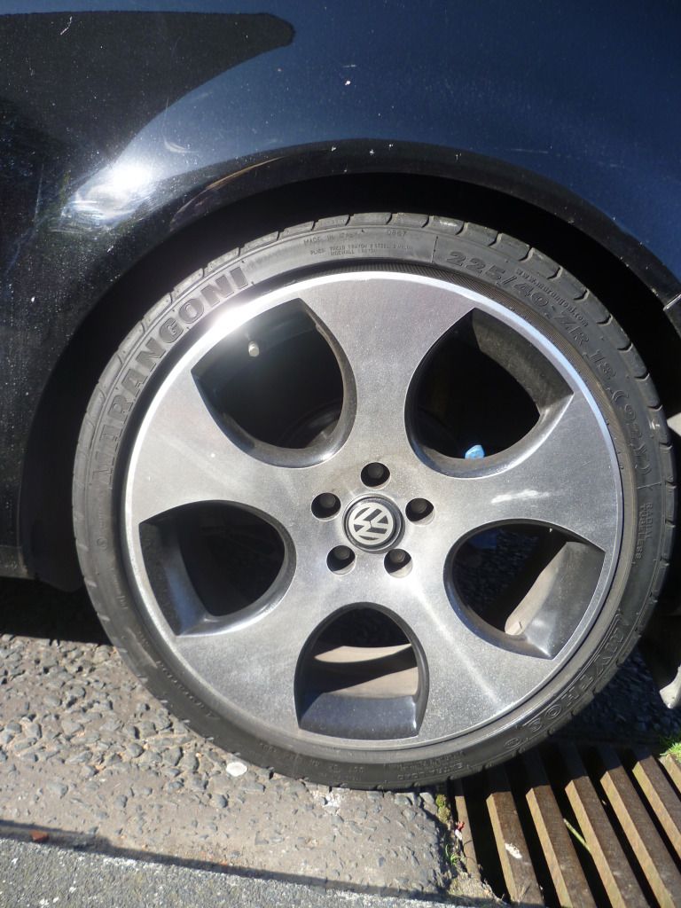

hi there my rims have pit marks on them and im wanting to sand and polish them just unsure what i will need apart from lots of elbow grease im looking for a really good shiny look any help would be great on what grade of wet & dry needed and polish

whatever you do dont try it yourself you'll go through the laquer , the best thing you can do is to get them re diamond turned we offer this for £75 +vat per wheel this process with us takes 5 working day and come back like new we are forever doing monza 2's there prone for this .
its not pitting its water corrosion which appears after a while due to the alloy being porus or after being damaged and water gets underneath the laquer
