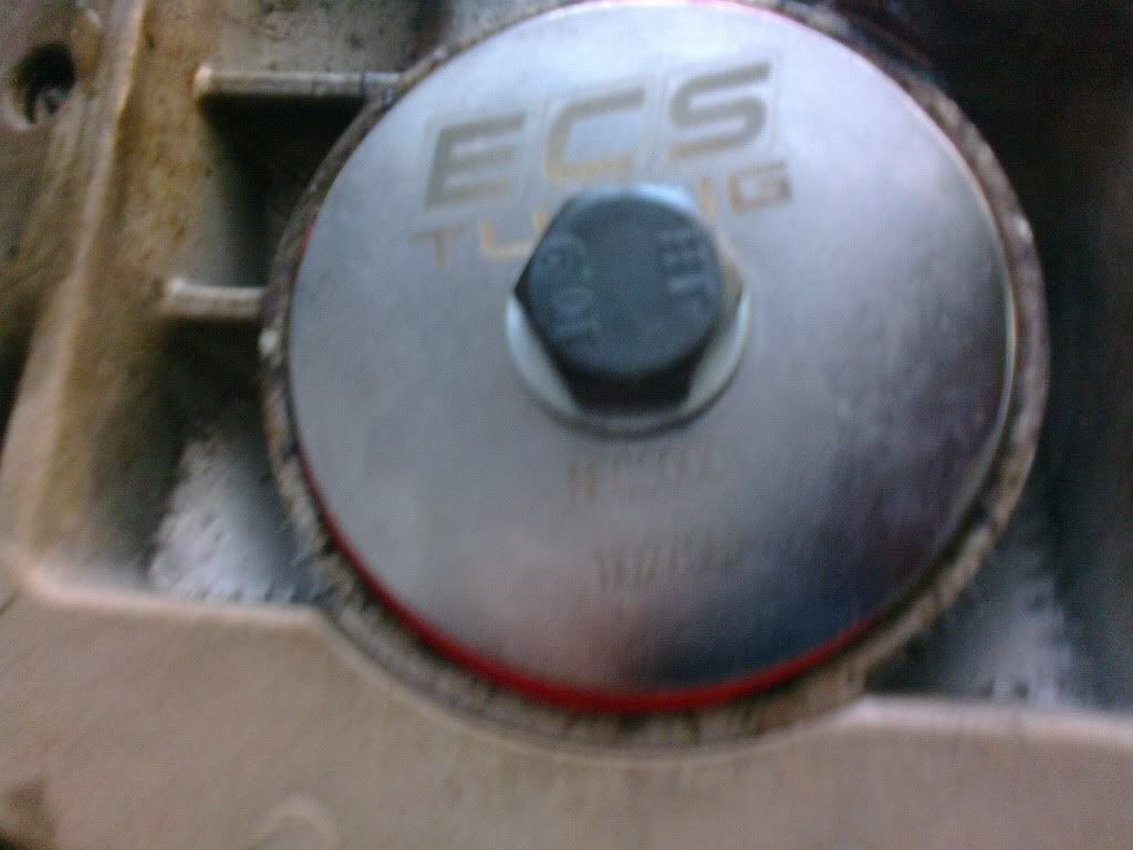

Had a 'ECS' dogbone insert fitted this morning. First impressions are considerably less tedious gear shifts and slightly reduced wheel hop, overall I'm happy thus far, but the verdict is still out. I suppose for £35 and ten minutes to change it's probably worth it.
I'm going in next week or the week after to have the N75 bypassed and to have the boost tweaked again to achieve more mid range torque without having to upgrade the HPFP. Fingers crossed for 300bhp+ and 300lbft+.....
