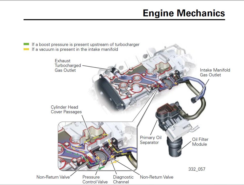

Have a look at page 3 of this thread for info on it and my photo of it.

Thanks. I can see the fine oil separator clearly under my engine cover but i can't locate the PCV from the picture in the document on page 3. I'm pretty sure that oil is inside the air intake pipe as the join in the pipe above the turbo is wet with oil. Maybe i should suggest changing the fine oil separator and PCV.

I know the pipe he's on about I photographed it on sunday also been told about this from a few places.

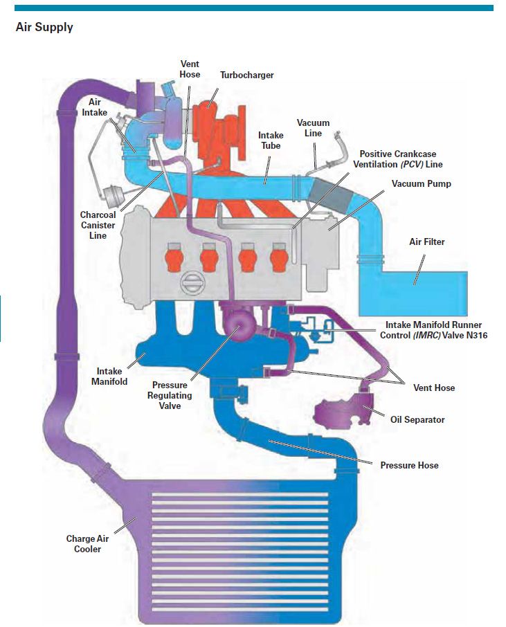

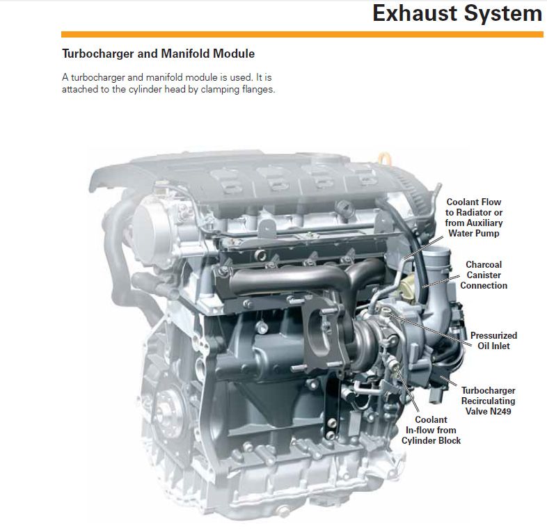

Bit more info i have which may be handy for others.
This below is the late mk5 but its very similar
