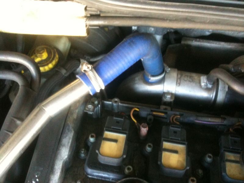

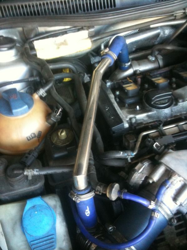

agu?- ko3 turbo standerd.
may have had the turbo uprated to a ko3s
does it have a uprated intercooler?
that chrome pipe on top of the turbo? :undecided:
has a forge side mount intercooler.
doesnt have forge pipework whats that pipe connected to  ( the long chrome one on the left)
it connects to the bigger shinny thing. inlet?? :embarassed:
id see about uprating that pipe, far too small, which youll be doin anyway cos if you want more power then front mount ic should be your first call

To me it looks like it connects to the charge pipe, can you take off top cover and take another picture??

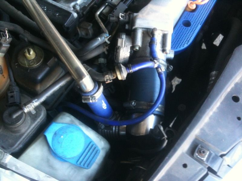

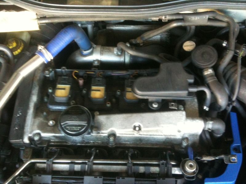

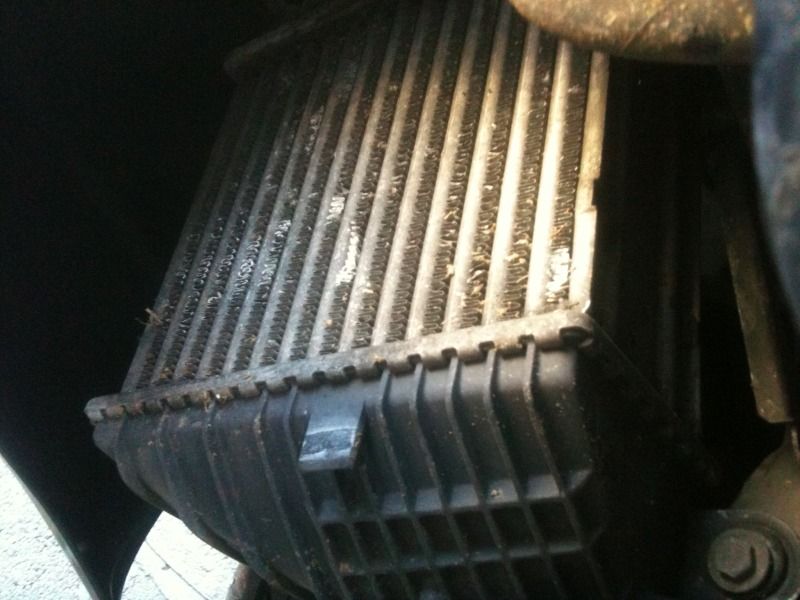

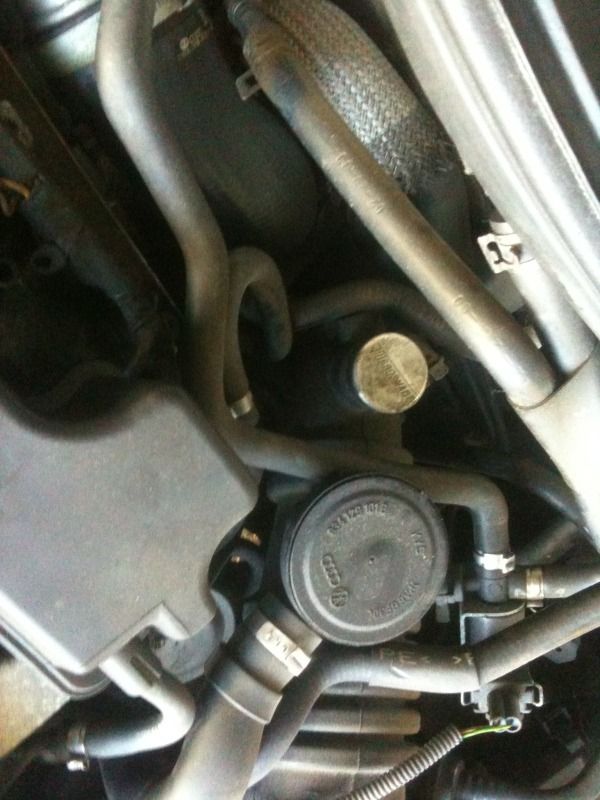

After having a closer look it dosent look like there has been that much done to it. i think standard ic, no forge 007p. here's a few more pics for you to look at and comment on.

As I thought Dv cold side relocation kit I just thought the charge pipe should be blocked and the pipe should go to the tip.... Or am I being a Bellend???
What dv is it??

When you change gear do you hear it chatter or does it chushh or pissf???

its like a quick chushh.

bit of over engineering just for a relocation kit, especially as itll make no real difference

Still think that it should be connected the other side of the turbo  :undecided:

« Reply #29 on: 19 March 2012, 22:40 »
Yeah, it should be.
All thats doing is putting boost air back into the boost side of your turbo....Where as it should be dumping into the TIP..... :huh:
