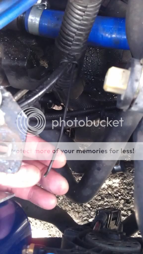

just found this wire not connected to anything cant see where it goes could someone have a look on their agu for me pic below cheers guys

I HAVE NOW FIXED THE OIL LIGHT PROBLEM seems a had pulled a wire off the oil pressure sensor on the filter housing and on attempting to reconnect it the wire was to short  :evil: but a brain wave later and all is sorted until the next chapter thank you all for your help  :smiley:
