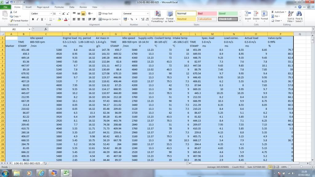

those logs are useless unless you do a full throttle run in 3rd. Blocks 002, 003 and 025 would be the best ones to log
use print screen and paste it into your paint program of choice, save as a jpeg, upload and post it here

Offline salgar3176
  • Posts: 20
Re: Running issues 1.8t AGU
« Reply #16 on: 07 March 2012, 22:41 »
Nearly got full throttle but i like my no points on my clean bit of paper
anyways this was done in 3rd gear any help/ideas would be great
thx in advance sa

Coolant temp sensor?  Does your needle jump up and down?  Its reporting a wide variation in temps there.

« Reply #18 on: 08 March 2012, 19:33 »
Chris look at the time stamps, they're not in the right order. As a rough calculation your MAF reading at its highest equates to around 185bhp

« Reply #19 on: 08 March 2012, 20:14 »
Well thats no good lol.  need a raw log with a 2nd or 3rd gear run from low revs to redline to make any sense of figures tbh.
