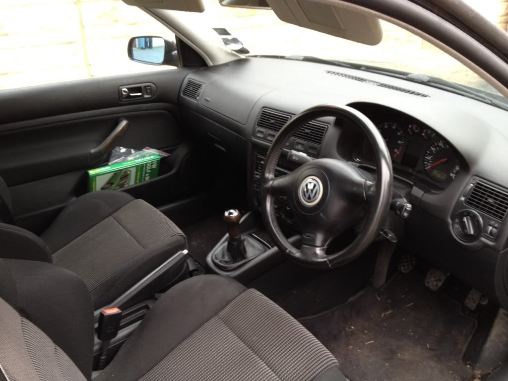

« Reply #2 on: 25 February 2012, 19:08 »

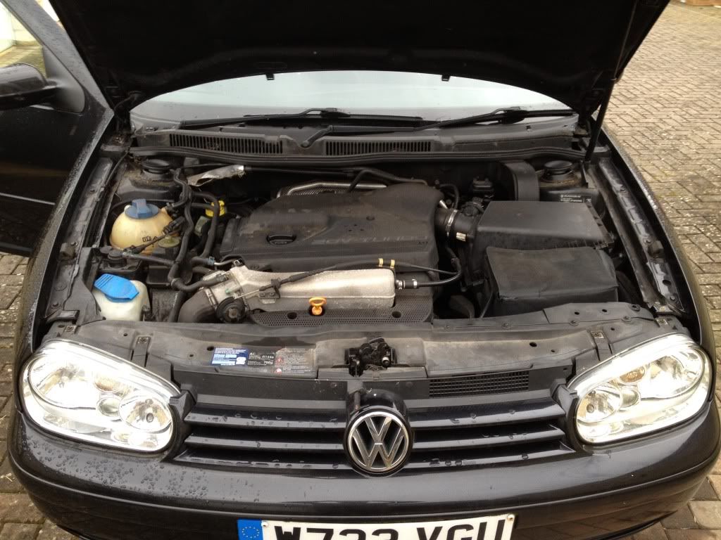

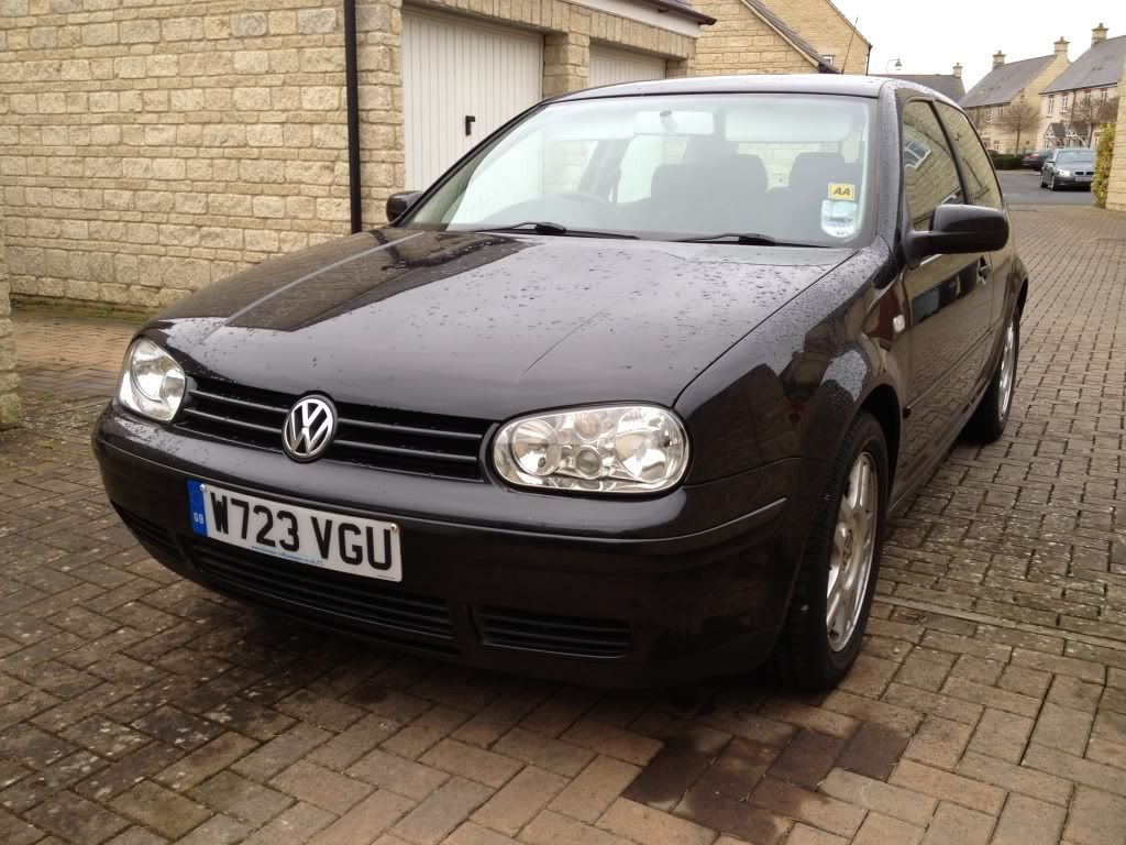

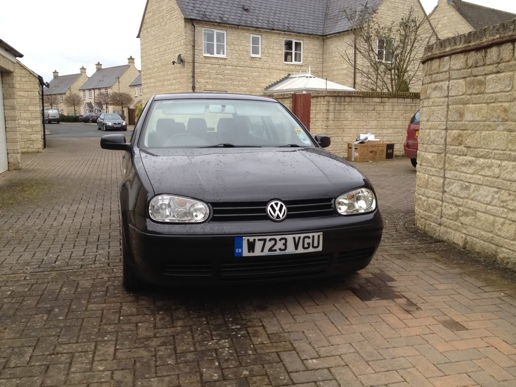

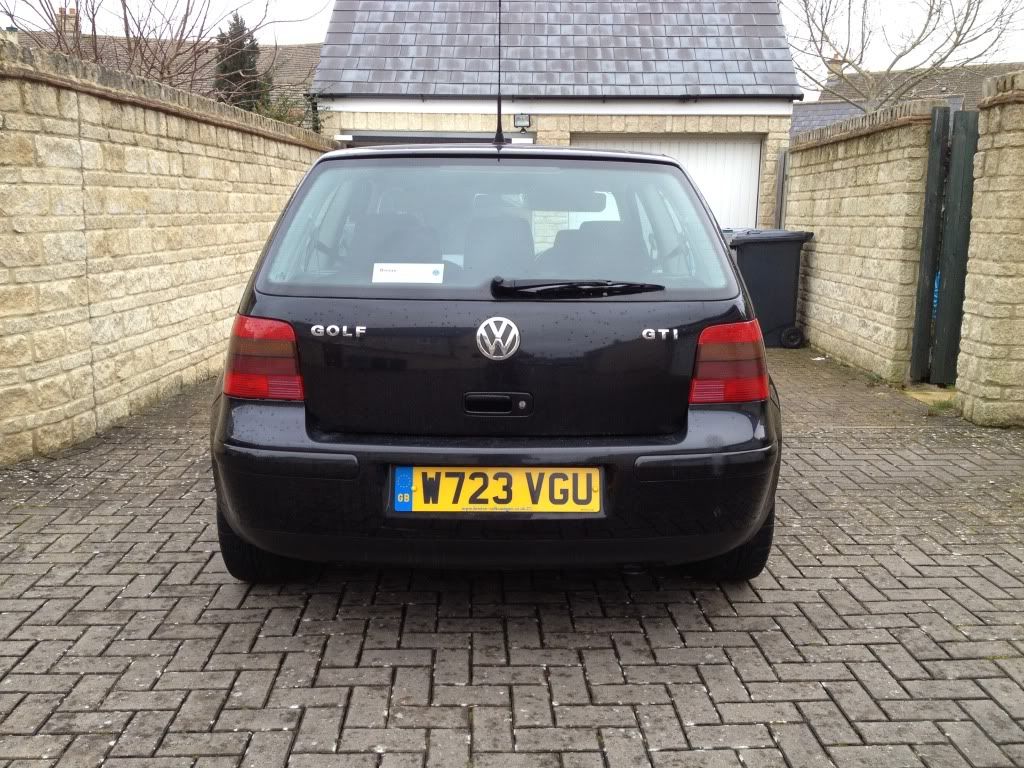

Hi

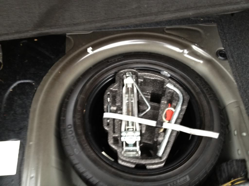

Here's a set of pictures to show you all the car as she is at present.  I've already started to do some of the work, so will post those later, but thought you might all like to see where we're starting from: -
To be honest the bodywork looks better than it is, as both rear arches have either had some re-paint or they have faded, but I'll be doing something about that at some point in the future.  But if you look at things like the spare wheel kit, its original and had has never been used!

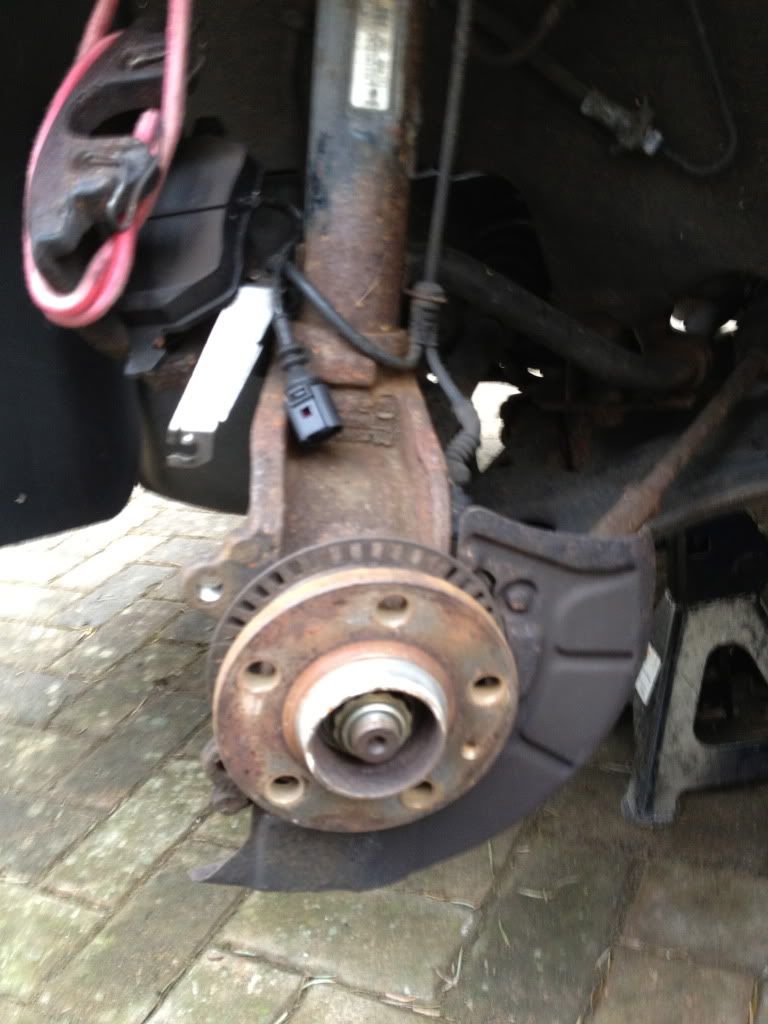

« Reply #3 on: 26 February 2012, 09:56 »

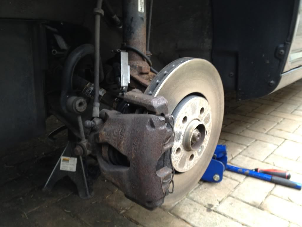

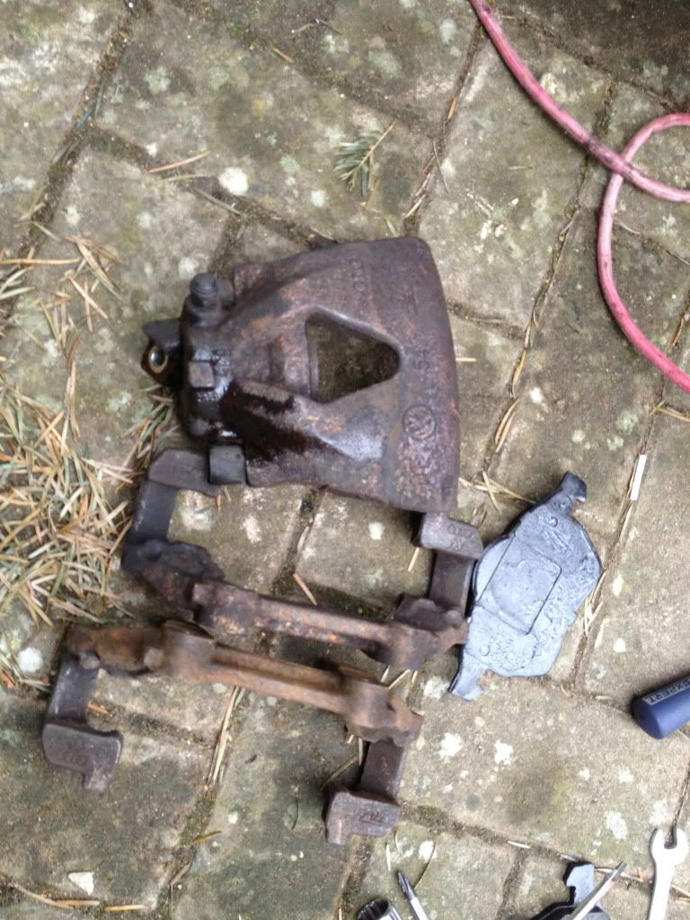

Morning

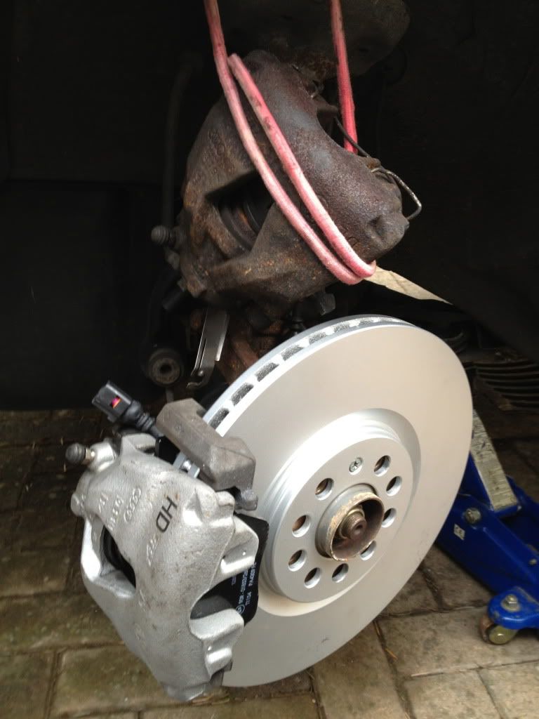

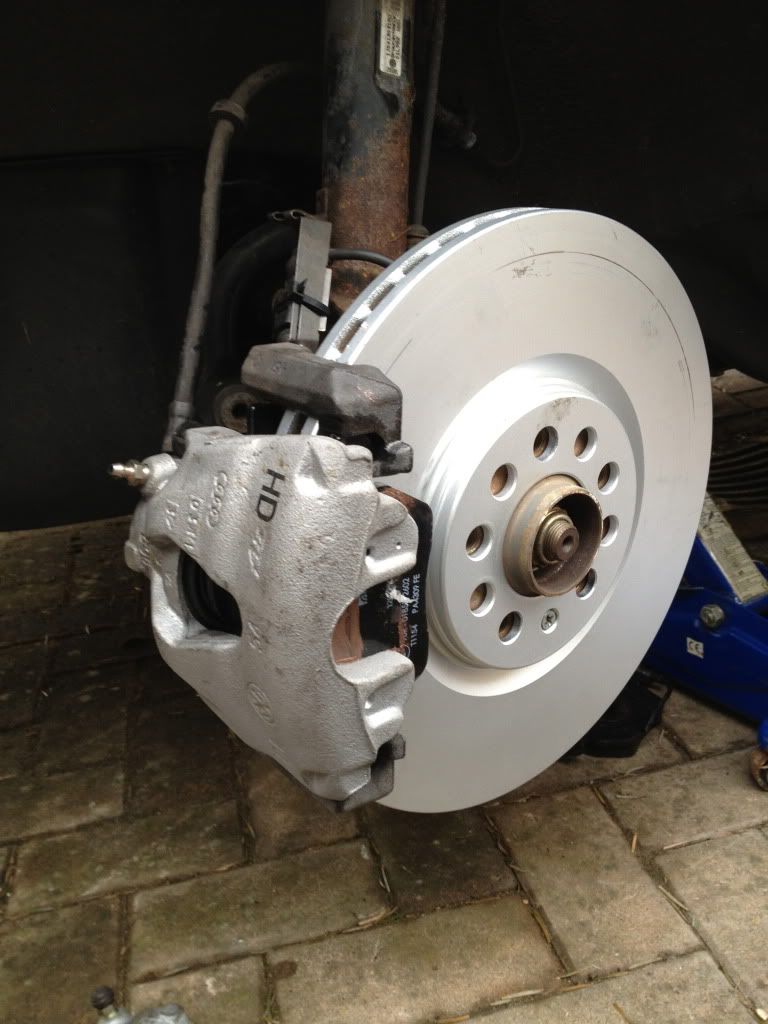

Finished my 312mm brake conversion yesterday.  When I got the car, it has been sitting for over a year, so for the MOT, I changed the battery, as apart from that it started first time.
The brakes on the other hand were a bit shot, even after running round the block left foot braking the whole time....
To get the car through the MOT, I found some cheap disc and pads all round at Eurocar Parts.  They were especially cheap using the forum discount code.

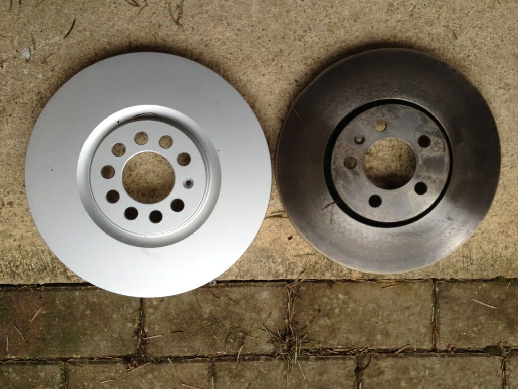

Before - Standard GTI Set up
After - 312mm Upgrad pack which included the carriers and refurbished calipers.  I purchased some Pagid discs/pads this time.
So not only have I now got a newer braking system all round, but it stops much much better.  The intention is to start with this set up and as I go through, slowly improve the braking as I begin the work on the engine, but for now, I think when I've completed the suspension work, and sorted it all out, it should be a good base to go from.

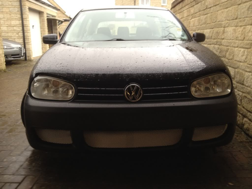

Procomp - 1.8T ---- Lights & Bumper

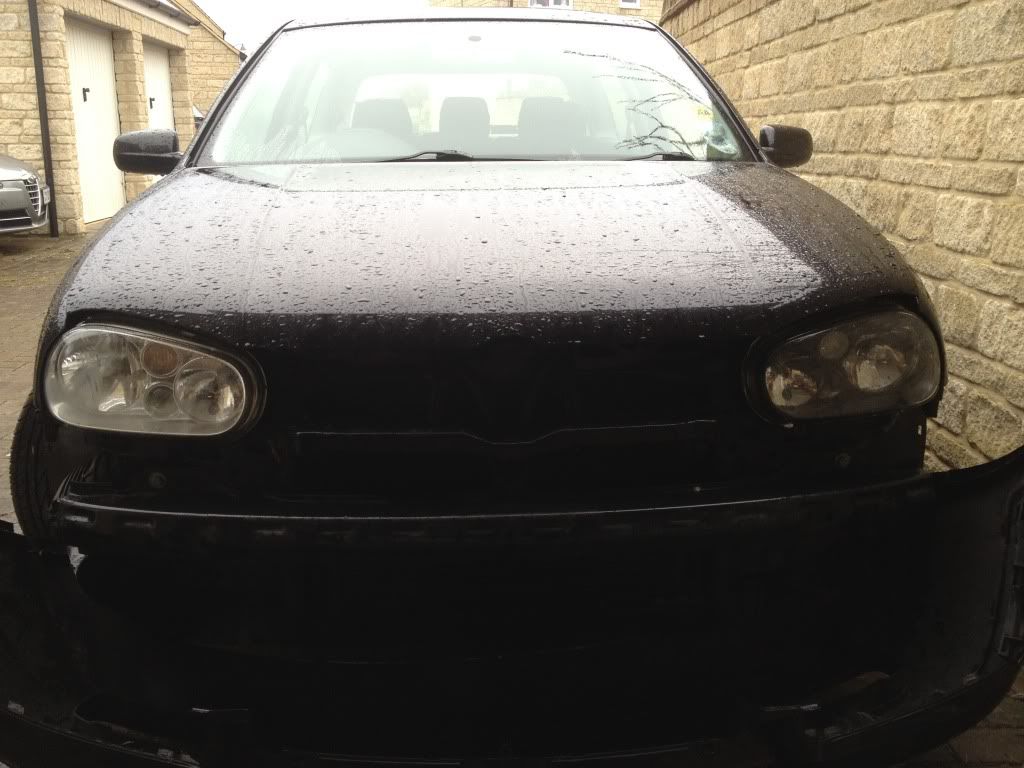

« Reply #4 on: 03 March 2012, 07:39 »

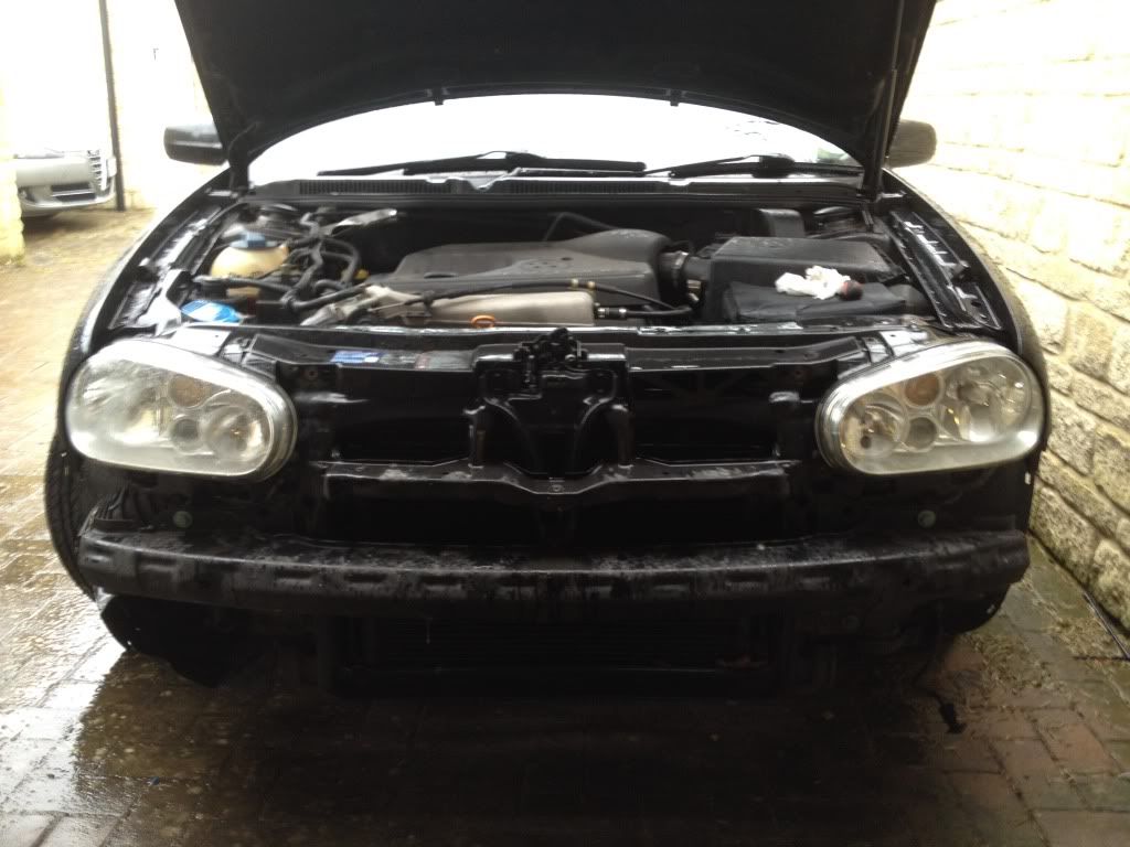

Started to do the upgrade to the lights and front bumper..........
Got a set of Anniversary lights off e-bay
You can see the new light on the right hand side for a comparision
Also at the same time, I pruchased a replica R32 front bumper and fitted it back on as I had the old one off to do the lights
Fits really well and is made of ABS, so pretty tough. Will most likely be painting the grills as well as the bumper and will take a view once I've fitted new alloys, the coilover kit and ARB's to see what it looks like.  The intention is to get some R32 side skirts, german style plates and change the rear valance, as I'll be upgrading the exhaust system when I start work on the engine.
Any views welcome on what others have done........... :smiley:

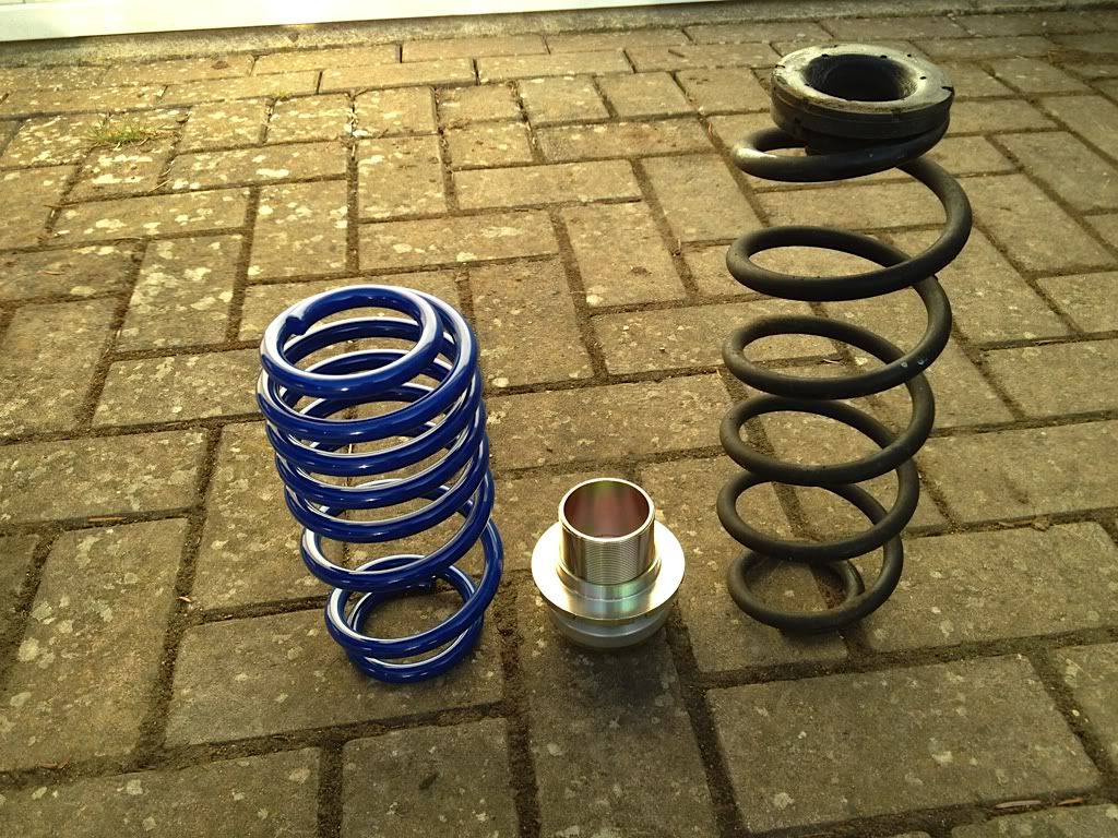

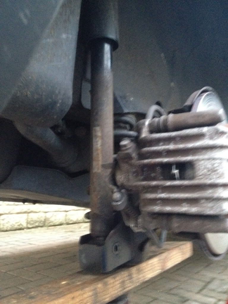

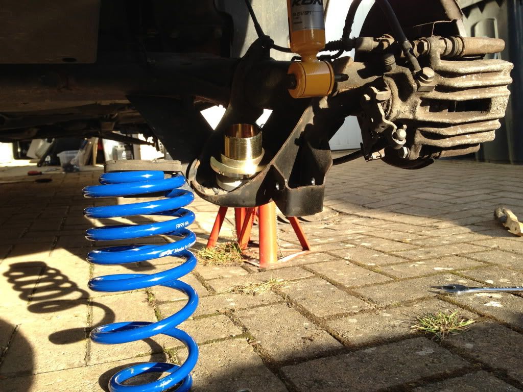

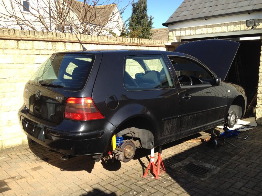

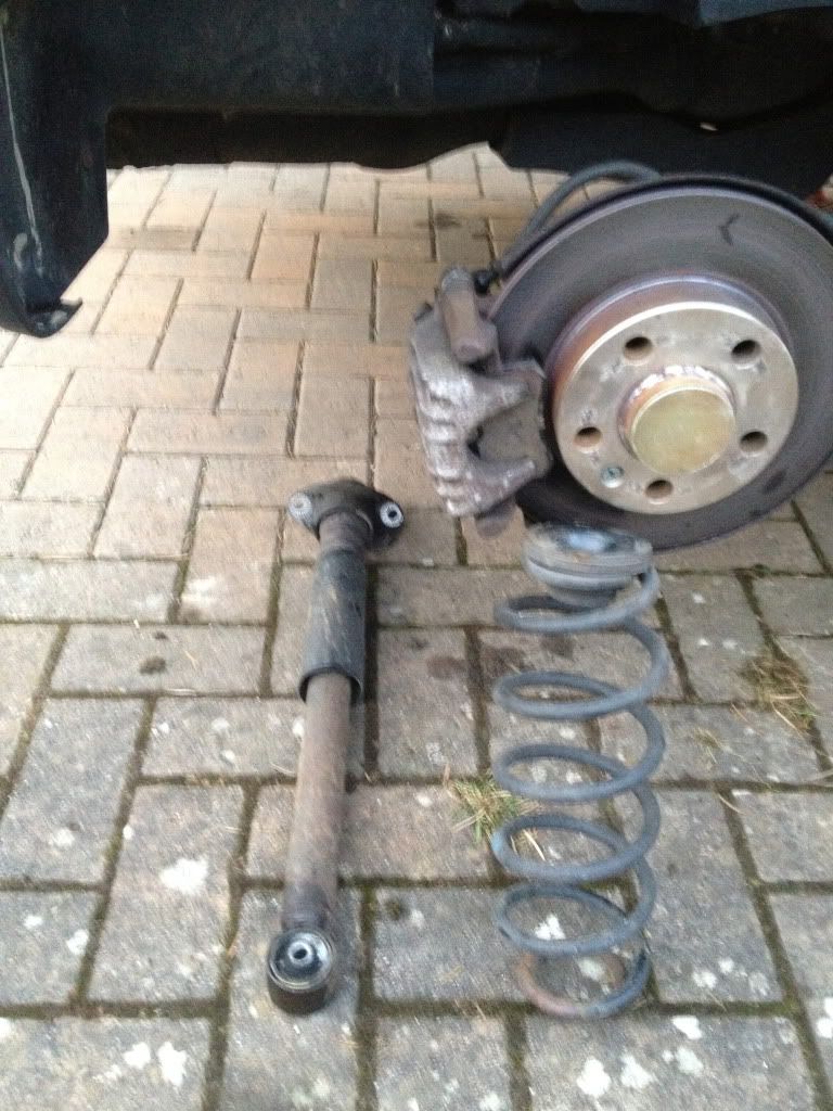

Hi

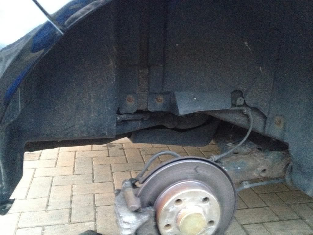

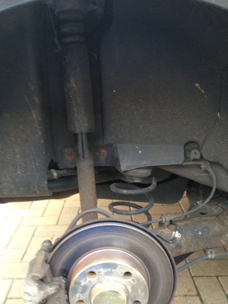

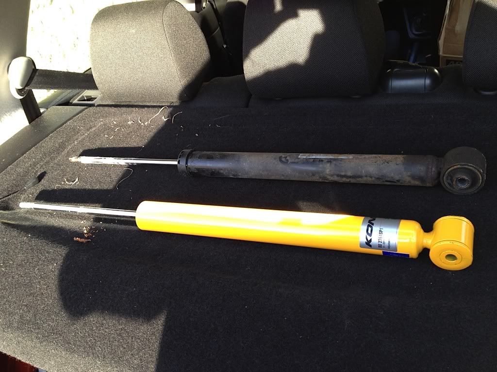

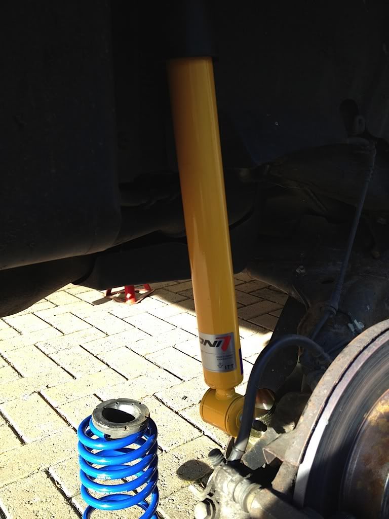

I've started to do the work on the suspension, which will include fitting a set of FK Konigsport coilovers and Eibech ARB's front and rear.  I've started on the rear, as it's fairly simple to remove.  Just a case of compressing the rear, undoing the damper bolt and lowering everything.  Then you just need to do the two top bolts and everything comes out.
Old Rear
New Rear - Lovely new kit
I'll post some pictures once I've fitted the rear ARB.  I'm really looking forward to getting the suspesion all done and the car back on the road, so will be working on the front over the next coule of days to get the coilovers on along with the ARB, which include dropping the subframe.

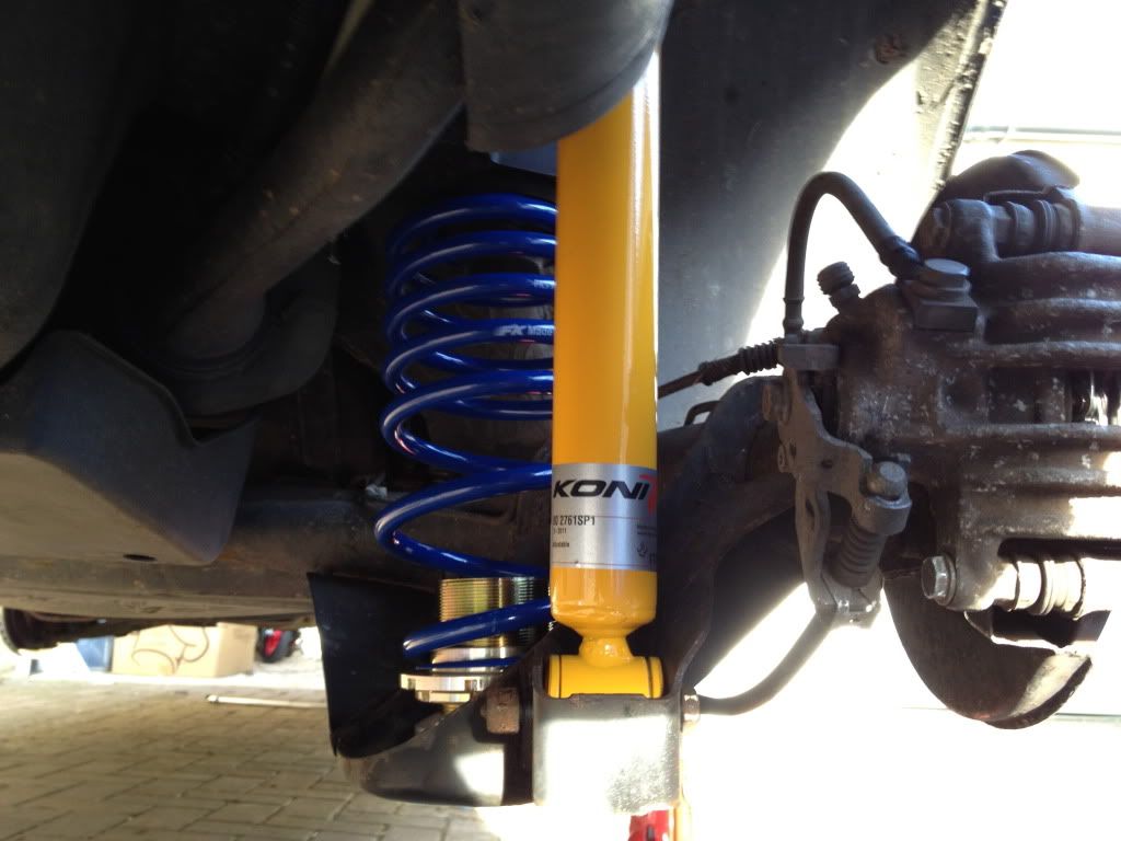

« Reply #7 on: 07 March 2012, 22:13 »

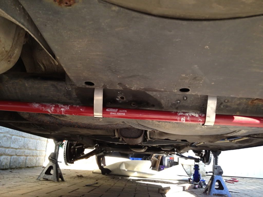

Evening
Posting a couple more pictures of my rear suspension, as I've now fitted the Eibech rear ARB along with the FK kit.  Need to give it a clean and set the ride height but will do than when I've finished the front.
Oh....I did realign the mountings when I fitted the bushes so they were evenly spread out

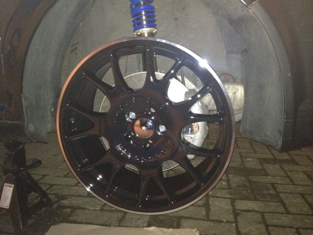

How about this for a golf with 'air ride' :grin:
Here's a sneaky peak on my new alloys!!!!!

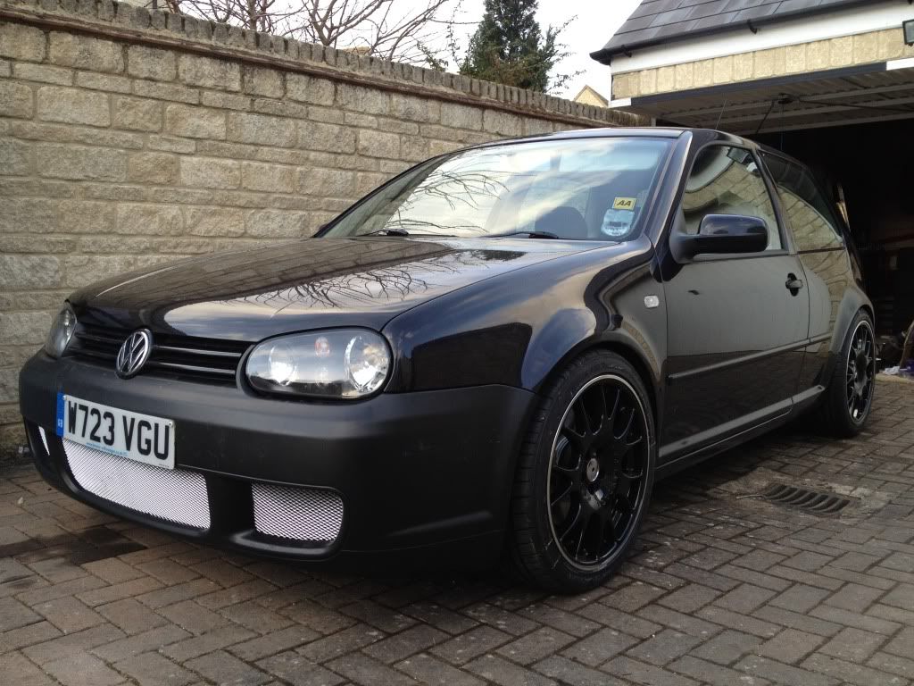

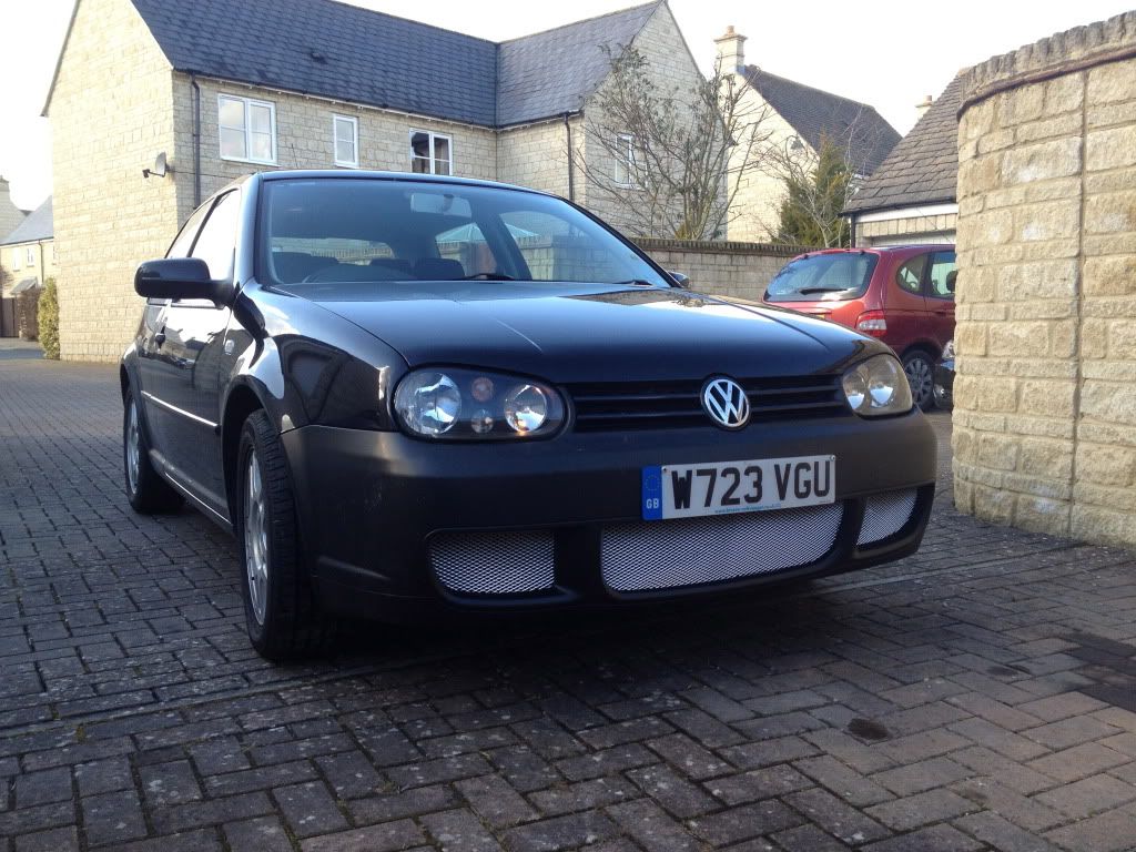

« Reply #8 on: 10 March 2012, 18:21 »
Evening
Two pictures to show the difference between the old wheels and suspension v the new set up.  I'll put some more info on soon to show the transition from the standard to the FK Konigsports and new 18' alloys: -
OLD
NEW
Cheers
Gregg
