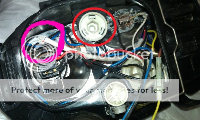

just got back from collecting them, gave them a quick clean with some APC so were semi clean for when i fit tomorrow , for second hand there not in to bad a shape, noticed one thing the seller failed to tell me the hatch for the main/full beam in glued down as the metal locking mech has broken on it but i can salvage that off the old ligths i think but exspt for that very happy with them let hope they work lol  :grin:
got a couple of Q's
are the adjusters on them ?
Why two connectors ? i know one goes to the loom, but the smaller one i am a bit clueless about
The white wire, whats it for ?

Right now for some answers  :tongue:
The adjusters will need taken out of your old headlights and put into your new ones, it looks like the white blanking plug is in at the minute. That brings me to the white wire, it plugs into the adjuster.
The small plug on the outside of the light, passenger side plugs into the loom, drivers side is just left with nothing to plug in to.
Fuse should be ok.  :smiley:

 . . . how hard should it be to get the blanking plugs out as this hapend  :undecided: and the other feels fast in
super glued for now but cant see it being very strong  :angry:
Also i am guessing red wire + and black/brown -

Just to confirm this is the bit you are trying to remove?
It should just twist out :undecided:
