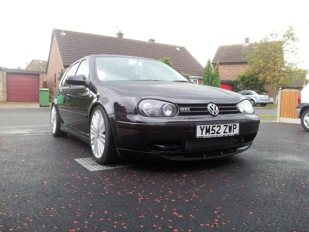

Definite improvement now the arch gap is gone.

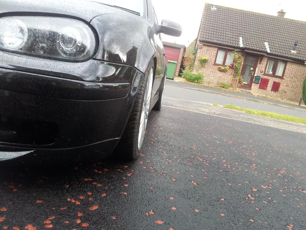

Cheers guys  :cool: Ive probably driven a good 250miles+ now and the fronts have dropped a further 10-15mm which is causing tyre scrub even on braking  :grin: + every corner so this weekend im going to raise them a smidge  :cool:

if you raise it then it'll still scrub mate, get your arches rolled, it's the only way to sort it :D

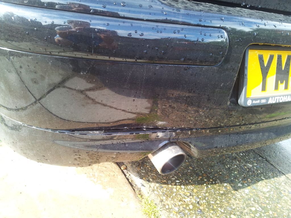

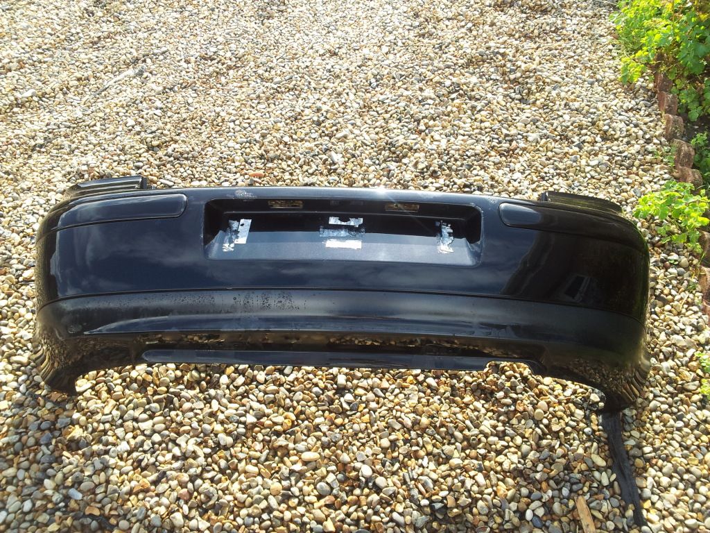

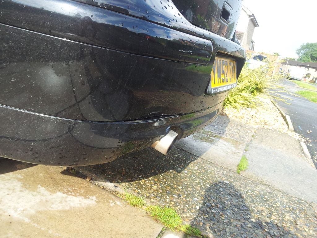

Well for a long time now, My rear bumper has been in a bad way. the heat from the exhaust has melted/shrunk it  :shocked:  :grin: how about that for rock 'n roll
Ive been searching for ages (4 + months) for a LC 9Z  black magic rear bumper to turn up and all the ones that did were in a much worser state than mine and highly priced. I did look into getting any old bumper and getting it sprayed but quotes on £175+ I jsut could justify it  :lipsrsealed:
How ever my patience has paid off as this little gem popped up on ebay 10 miles away for a measleyy £10  :cool:
install

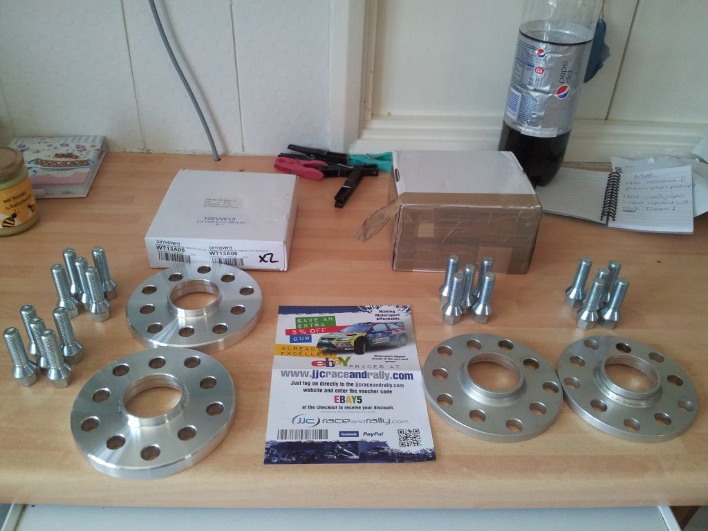

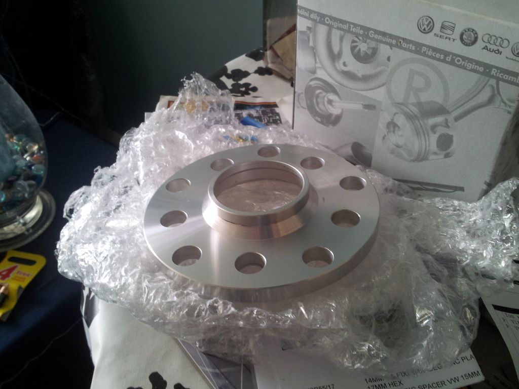

Uppon arrival of my spacers a few weeks back one arrived damage ( check the one furthest to the right, completely cracked in 2)
So I sent a email to the company and recieved a replacement

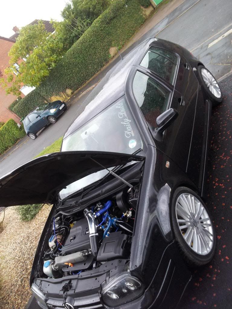

12/10/12
Well It certainly has been a while since ive ventured into this thread  :grin:

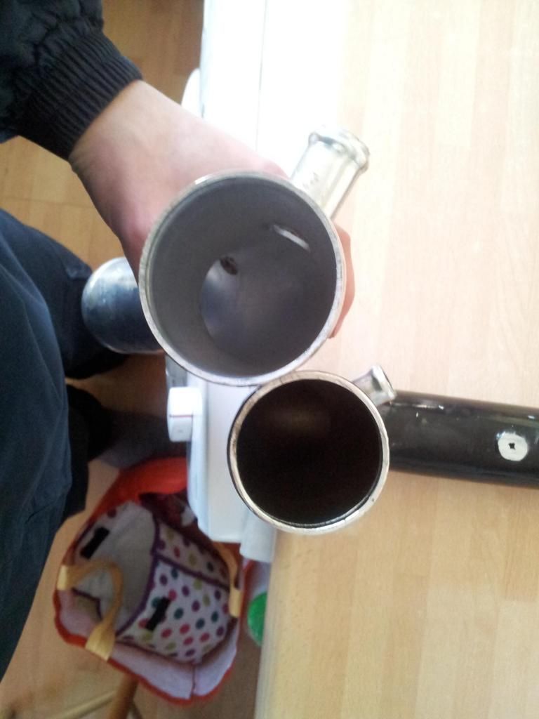

Ive finally started getting round to the list of jobs Niki from R-Tech recomended doing.

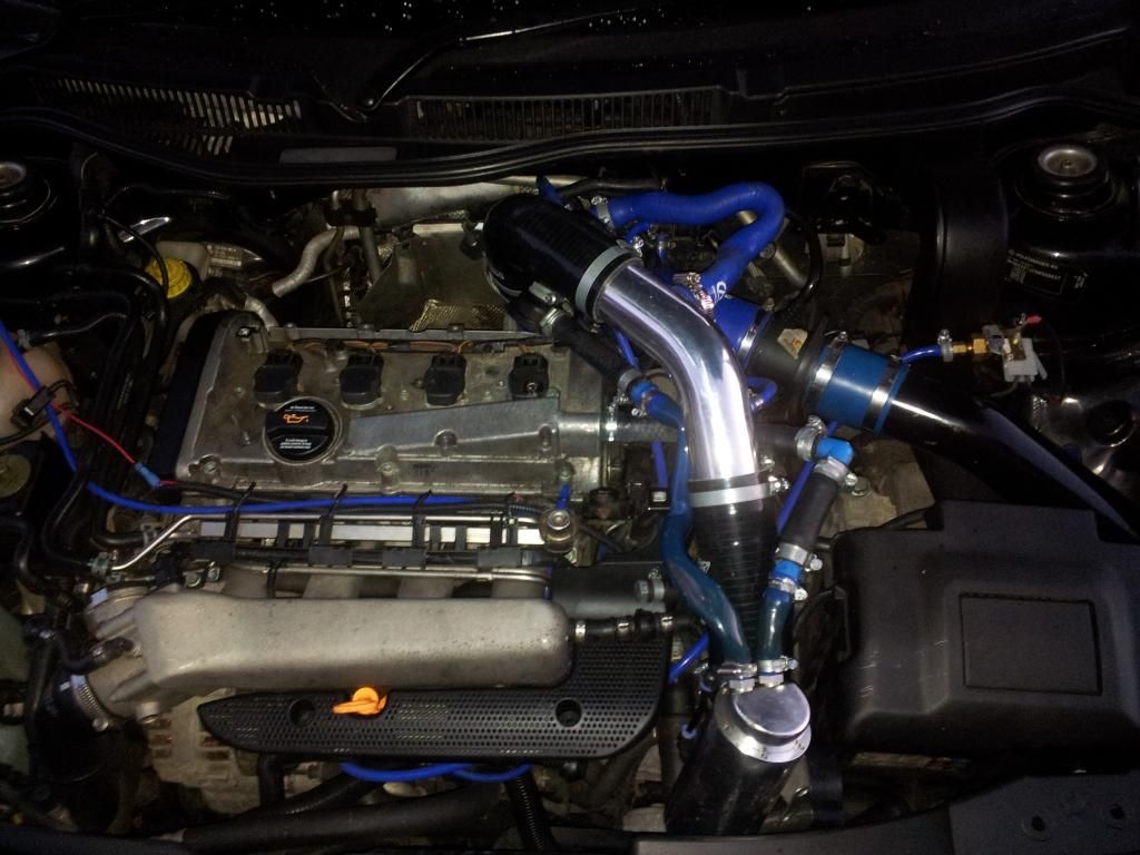

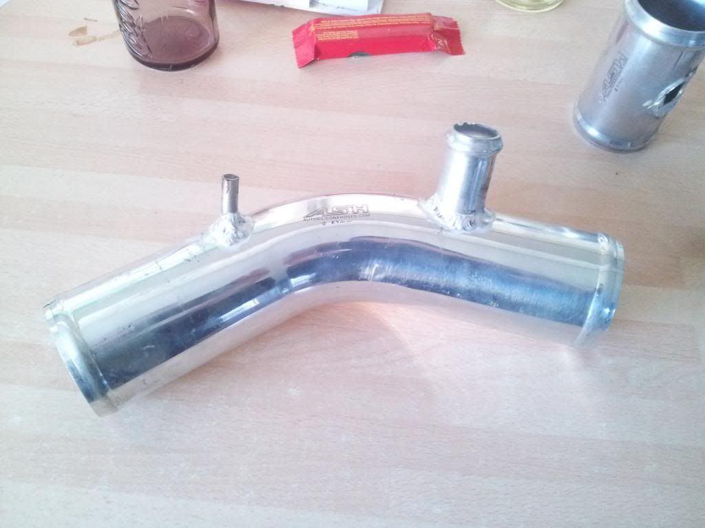

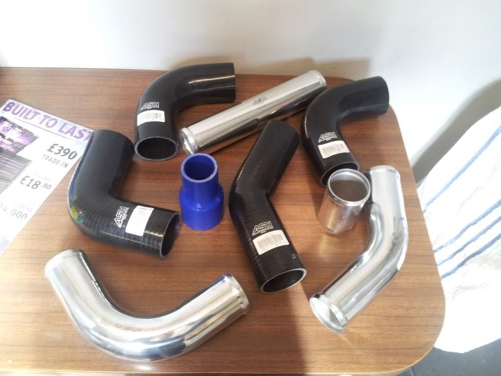

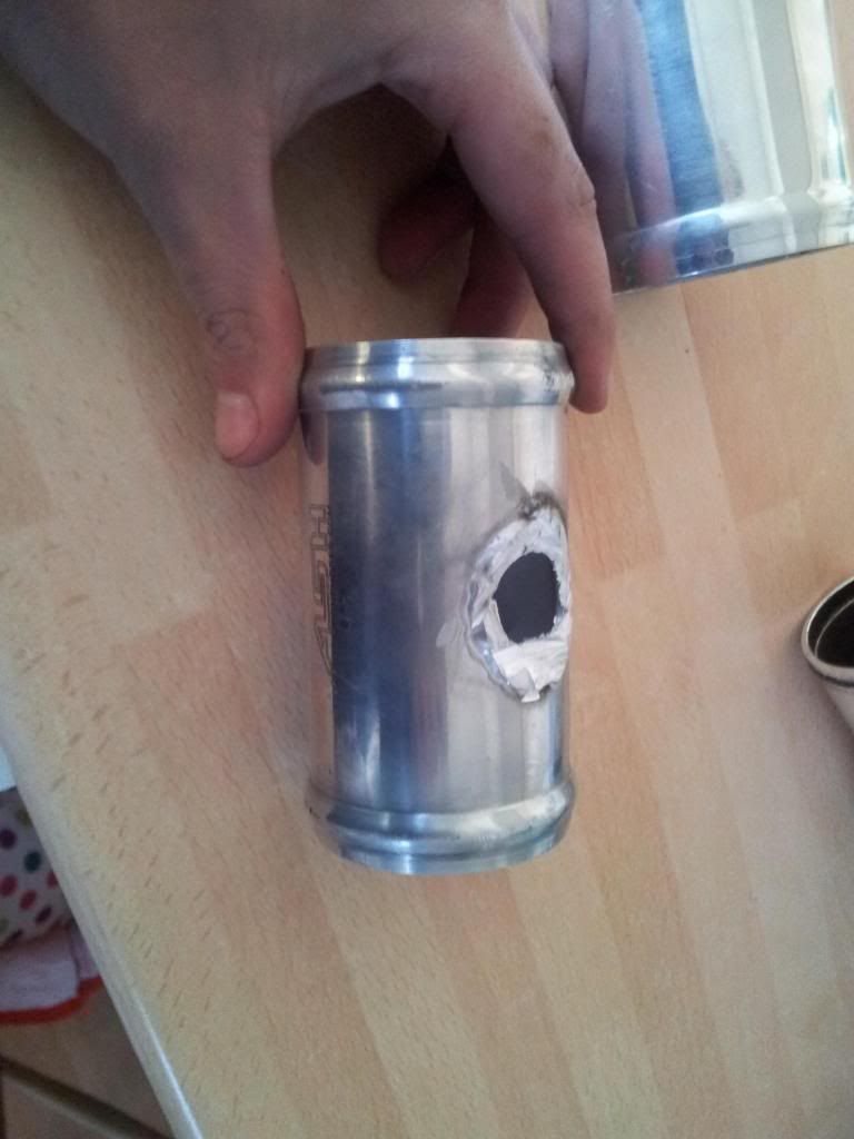

First major job was to change the pipework from the turbo to the intercooler to a larger diameter as you will soon see why my power was limited to 231bhp  :rolleyes:  :grin:
New 2.5" pipework next to previous old 1.75" pipework  :shocked:
With help from Prawny (cheers bud) I gathered the list of angles I needed
Take a T Piece and cut the 25mm end off find a bit of alli tube in the garage for the n75 take off
Give it to the workshop and walll....The finished article
All plumbed in awaiting for road test as MOT and TAX ran out  :cry:
A few random shots i got tonight in all her glory
You know winters on the way when you wake up to frost in October  :lipsrsealed:
thanks for reading
« Last Edit: 12 October 2012, 19:59 by Chris#101 »

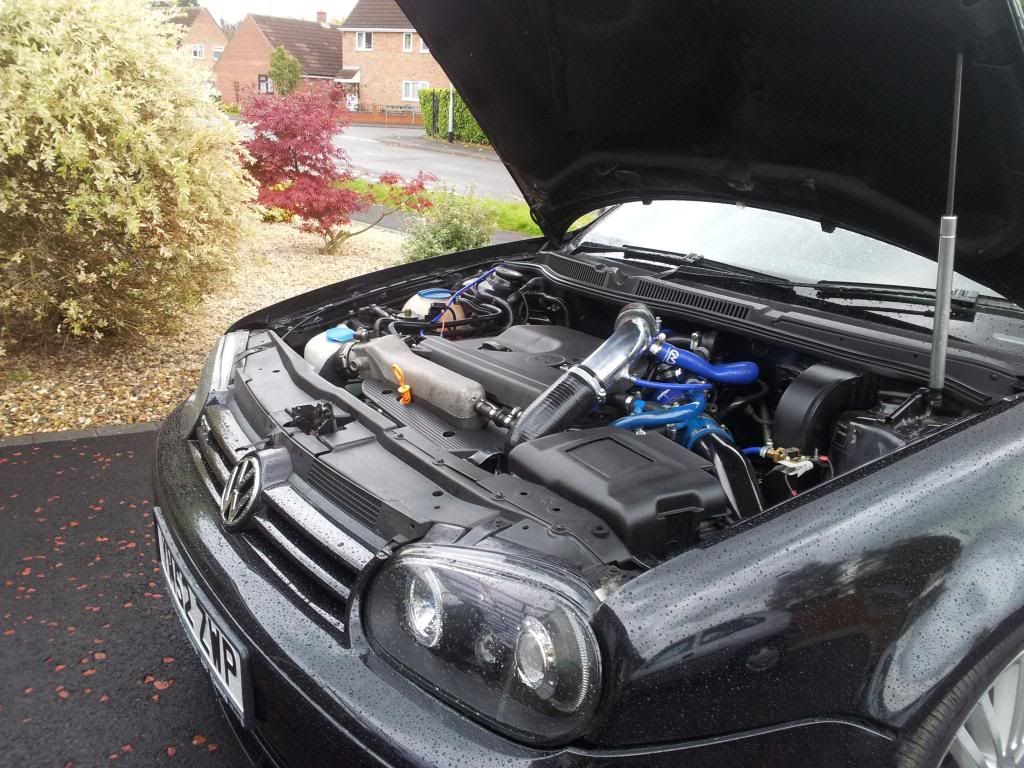

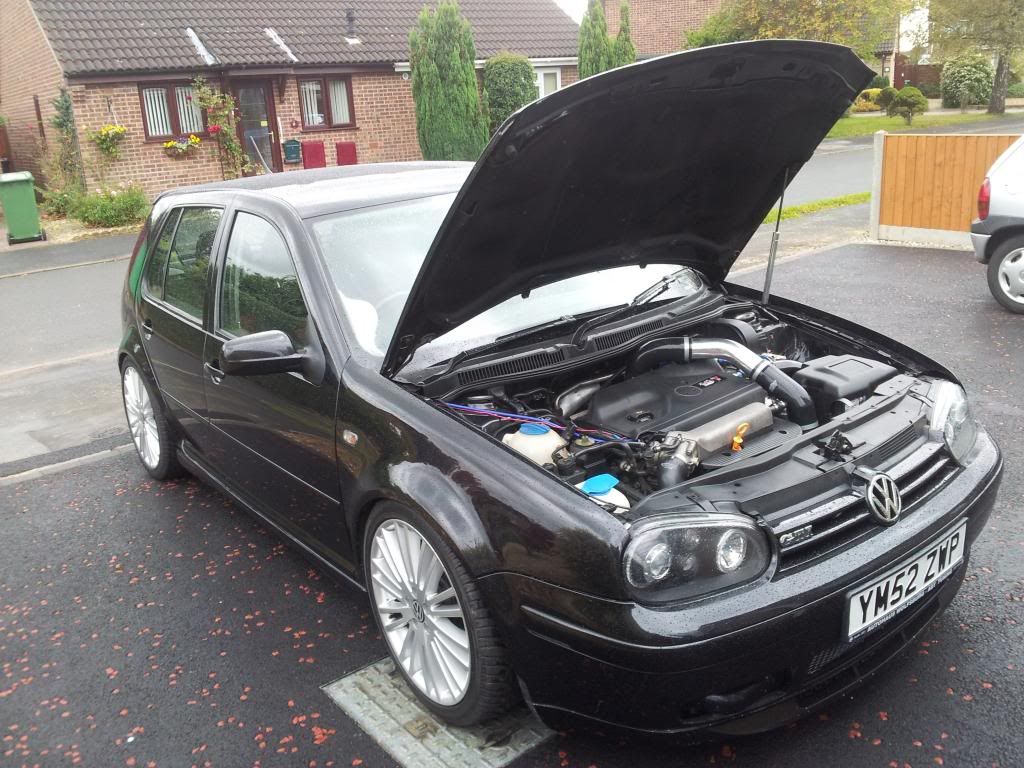

Well following on from the weekend, I wasnt to happy with the fitment onto the turbo outlet as it rubbed a little on the bonnet when closed. So I just cut the silicond reducer and silicone 90* bend down to bring the overall height work of the pipe down.
So this is how it currently stands.

Now for some opinions
My turbo has been on the way out for a while now prior to the 231bhp ,258lbs-ft remap  :grin: so I think its only fair to change it before it sh!ts itself in a spectacular fashion :lipsrsealed:
I was contemplating the k04-023 conversion but with it being an AUQ with standard internals the figures sort of scare me a bit to reliability factors with it being a daily!?!?
So currently im thinking of going K04-001- direct bolt on, so my question is I know chinese products have been known for rubbish quality of materials machining etc but is that a thing of the past now? Anyone got any feed back on ebay turbos?
What does everyone think would be more benefiial with my current spec:
*Forge T.I.P
*Forge Actuator yellow spring
*Forge 007p
*2.5" Toyosport FMIC
*Devils own water methanol injection kit
*3" turbo back Draft 42 designs exhaust non res
*Toyosports CAI
* PVC Simplified- Oil catch can
http://www.ebay.co.uk/sch/i.html?_odkw=04+001&_osacat=0&_from=R40&_trksid=p2045573.m570.l1313&_nkw=k04+001&_sacat=0
The car is currently having its mot done so fingers crossed it should go though without any major problems :smiley:
this is how I left her
Any feedback would be much appreciated!? cheers
