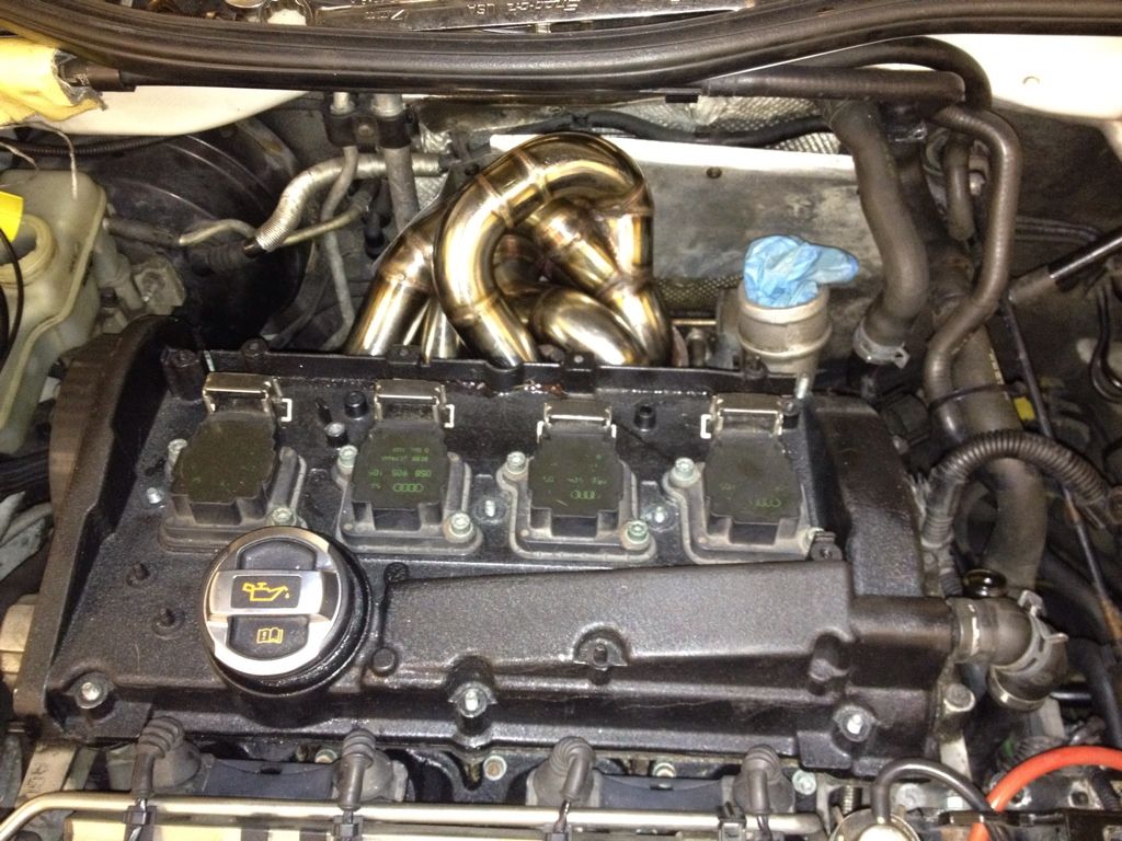

Taken from prawn on audi sport, but its the same as mine, but i could never get this angle!!! Pure porn!!

« Reply #21 on: 15 February 2012, 10:45 »
which manifold did you get I REALLY fancy one now...

« Reply #22 on: 15 February 2012, 13:31 »
Xs power manifold!! Iv seen one glow n its sexy!!
Booked in to r tech -  roll on 3rd of march!!
Also orders the fmic and all the pipework!
Was unsure of how many clamps to get so ill wait till its all mocked up and grab them!
