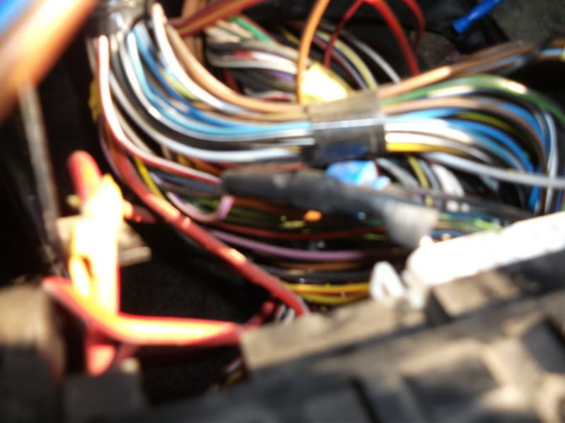

This wire?
i hope so as i found that the wire was a tiny bit singed either side of the blue connecter so...
cant start it yet till my neighbour wakes up to move her car so i can get the leads of life on her! Can't blame her, she just had 5lb twins!  :sick:

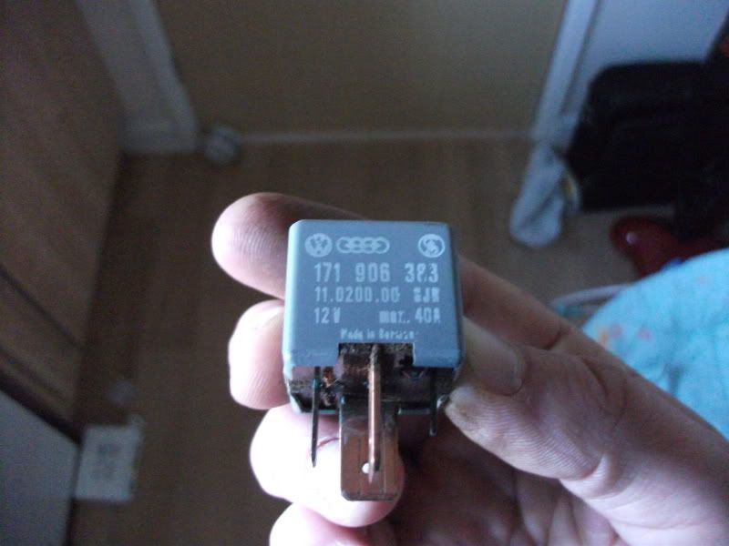

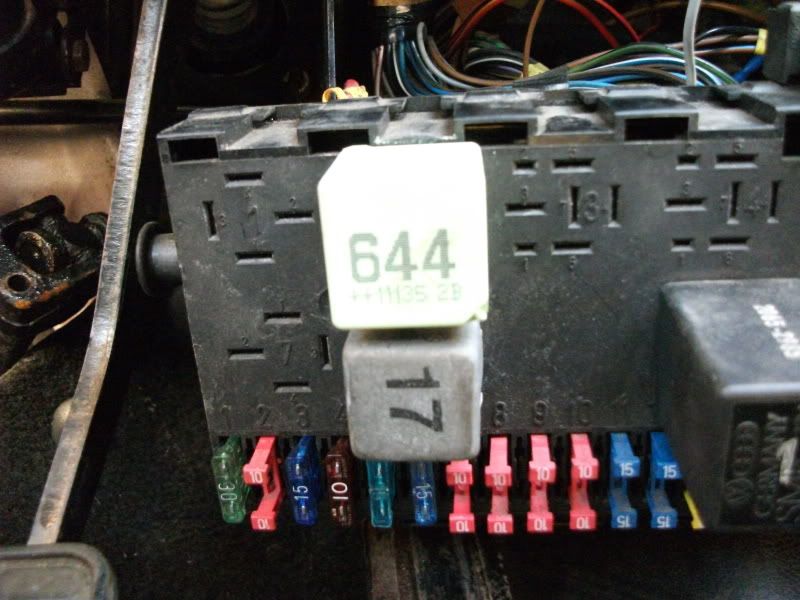

on the relay side. i swapped this relay...

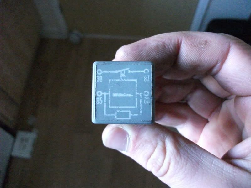

for this one, new from vag

you see that scotch lock there,   you likely see your problem.  cut the fecker out solder and heat shrink over.   ( or better still order some pins for the FB plug and reinstall wire slightly sorter with  new pin.
i was thinking triming back wire under bonnet as they are more likely to fail there.  but on spotting a scotch lock anywhere it instantly becomes chief suspect  they are infenal fecking things
