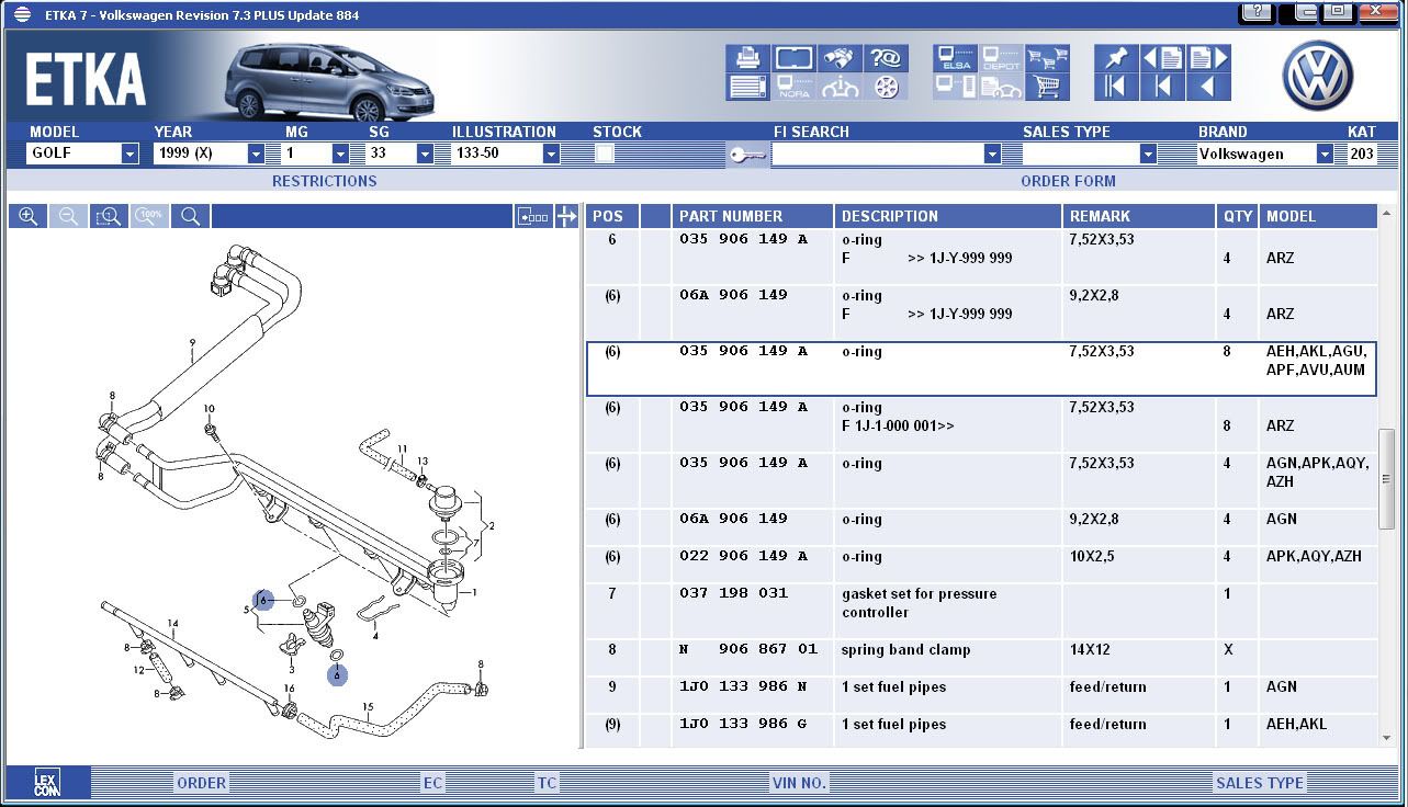

hi guys anyone know part number for agu injector seals cheers
Offline Chris.
  • Posts: 1,916
Re: part number request please
« Reply #1 on: 28 January 2012, 16:32 »
Ones that screw into the inlet: 058 133 555
O rings:

Or do you mean the seats that screw into the inlet manifold?

Covered them both ;)

Sorry, stupid phone cut off the part number bit of the pic
