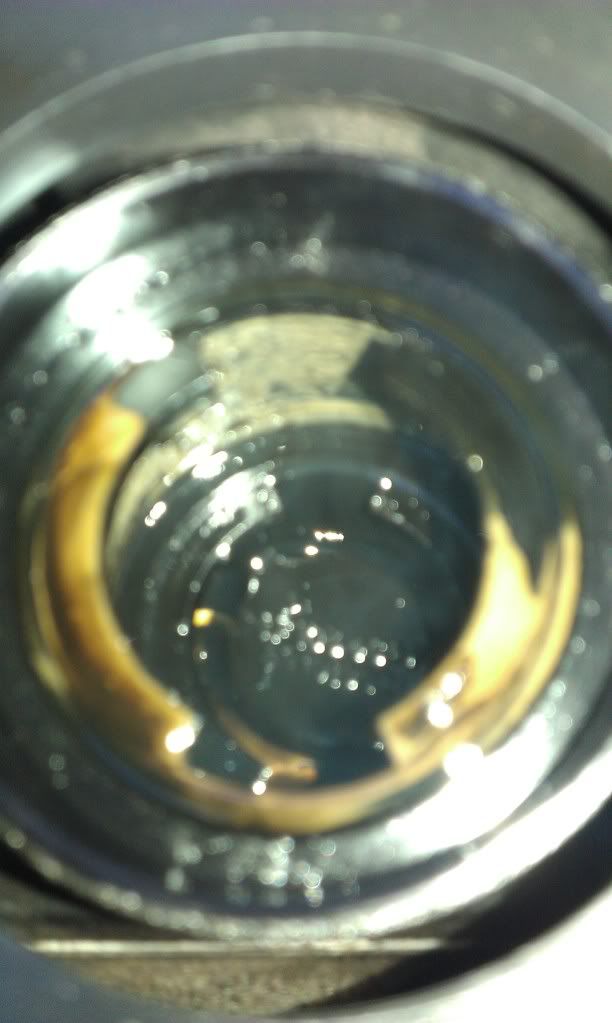

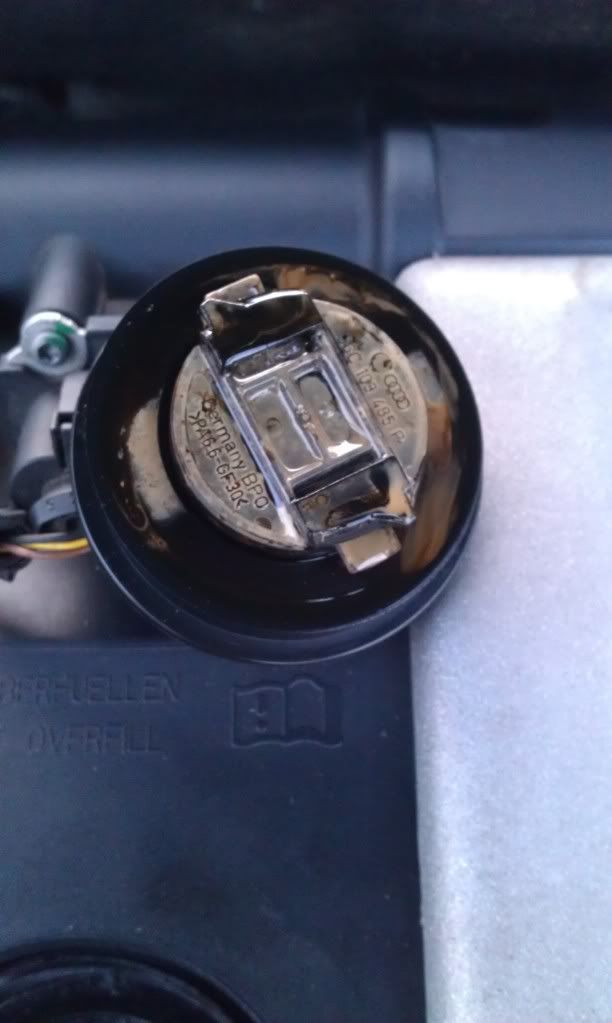

Thanks for all the replies.
Here are a couple of photos showing the filler cap and the neck of the rocker cover, after having wiped all the gunk off and been for a long journey. There is a decent covering again.
What makes me think there may be something else going on here is that i've had the car for over 3 years and I think I would have noticed this going on before now.
Any further thoughts much appreciated.
Cheers
Mike

« Reply #12 on: 30 January 2012, 11:10 »
looks the same as mine, more or less

Just picked up My new oil filler cap and it's a completely different design underneath much deeper around the base and goes right into the hole rather than sit on top as the old one did. I have already put it on and it is so tight on to the engine block and the rubber seal is much thicker. I could hardly get it back off th engine. I didn't clean the mayo before I put it in and when I had a look I have already noticed much less mayo at the top and on the cap.
I am convinced moisture was getting in the old one only time will tell if it completely disappears but I will keep you posted. Could be £6 well spent

« Reply #19 on: 01 February 2012, 17:10 »
Is the revised one different to the one i've got (shown in the photo)?
