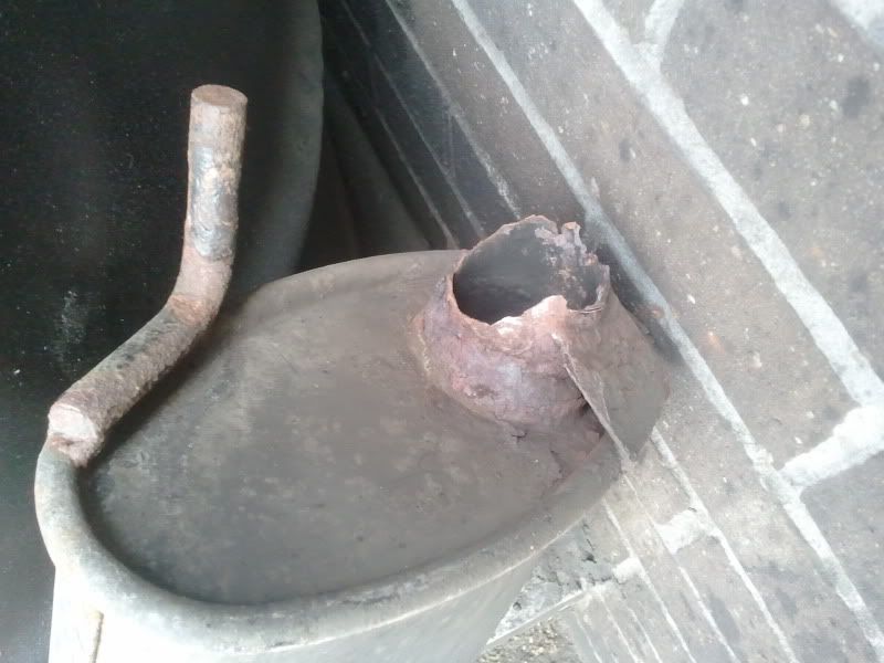

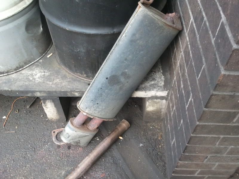

Back in late 2009 I bought a brand new sportex back box and had it put on the car to rid it of the pea shooter dieseler stylee tail pipes.  But come the late part of 2011 it didn't look so new :

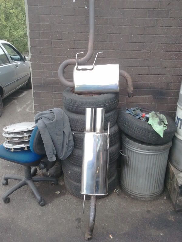

Its not even been 2 years and its rotted through.  Yet the rest of the exhaust up to the cat that has been on the car for around 4-5 years was still solid and working ok.  Note to self - never bother with Mild Steel exhausts again, and never buy Sportex...  ANYWAY!  I had to get my hands on an exhaust to sort that little problem out, and a mate from "Moorlands VW" based in Leek came to my rescue with a Stainless cat back system that he was taking off his 8v Mk3 that he was breaking.  Picked it up and it was a little grubby, so first thing I did was take it down to my mates garage - SB Autos in Burslem, Stoke, where I broke out the solvol autosol....
We think that to the best of our knowledge its actually a Magnex, so win all round.  Getting the old centre section off was a bit of a pig as it was jammed solid in the cat, but with a bit of coaxing from Steve and Punko (SB Autos mechanics), it came out in the end, and then with new clamps (and eventually new centre rubbers when I discovered it knocked on the chassis brace) I stuck it on.

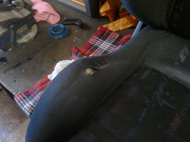

The bolster on my drivers seat has been badly knackered for a long time (which is a very common fault with this style of seat as I am sure you folks know) and I was actually on my third drivers seat with this car, so I took the opportunity to deal with it. First of all, big thanks to my friends Amy and Gaz for sourcing a pair of seats in the right cloth for me.  They came out of a three door, and obviously Kermit is a 5 door.  But I had a plan (I didn't know if it would work, but it was my plan and I was sticking to it).

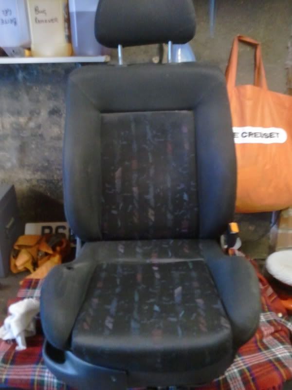

Here is my original drivers seat:
As you can see, its had it.  This was unsightly, and uncomfortable for me to sit on as the metal bar was digging into my leg.

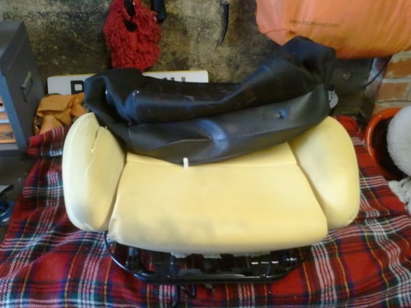

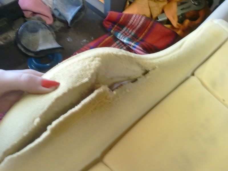

Now the fabric is out the way and we can see the root of the problem...
So we will sling that foam in the bin.

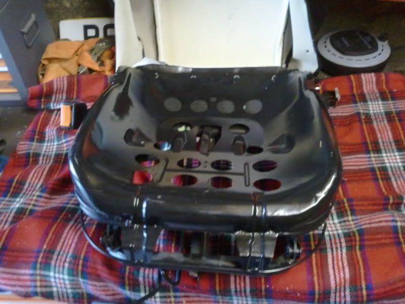

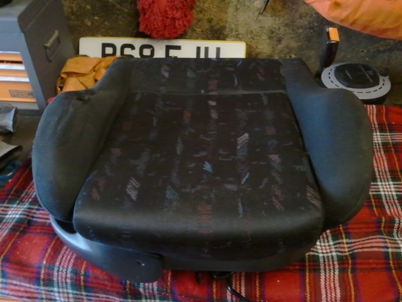

Its actually very difficult to completely remove the fabric from the seat base (you can see in the photo the staples that go through the metal base holding the fabric in place), so at this point I elected to use the drivers side seat base of the three door seats Amy sorted me, and the foam from the passenger seat base.  Here we can see the base itself, with the fabric still firmly attached at the back:

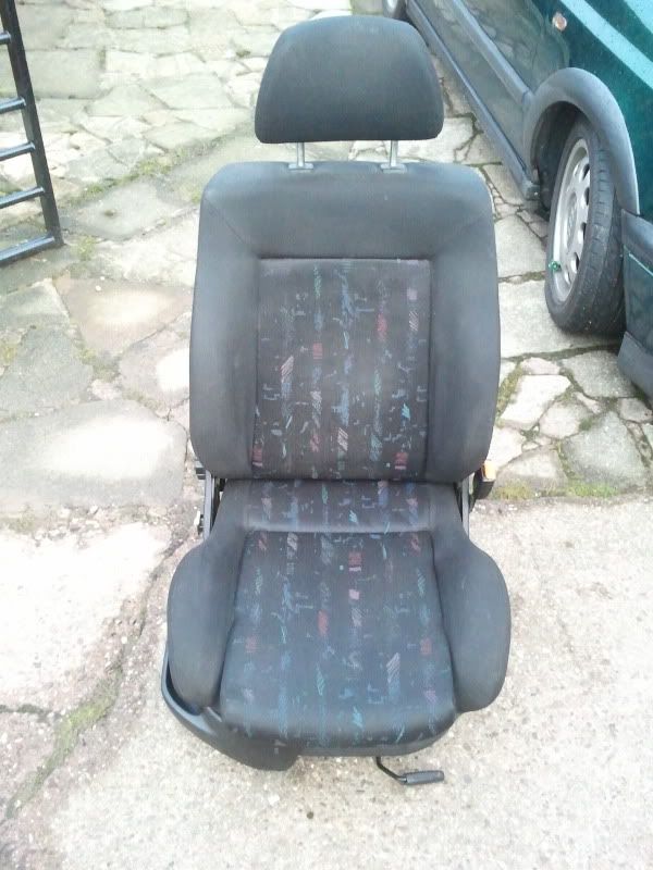

The passenger seat foam was perfect, so i placed that on the base, reconnected the fabric to it, and reattached the fabric to the seat frame.  Even thought the base I am now using is from a 3 door, it is actually identical to a 5 door one, so I now mounted the backrest on the seat and reattached all the trim plastics and handles (and picked out the most intact/unmarked/undamaged plastics from the three seats during build up).  Leaving us with this:
So to recap, that is the foam from the 3 door passenger seat base, the base and cloth from the 3 door drivers seat, and the backrest from my five door drivers seat!  Aka - Frankenseat.  :grin:
One perfect drivers seat with no sagging of the bolsters and no damaged fabric.  Its so much more comfortable!
Kind of pleased with myself for having done all this.  In total it took about 2.5 hours, which involved the full strip down of 3 seat bases, and the rebuild of one seat.  Now all I need to do is get my hands on some form of wet vac so I can shampoo the seats properly.
