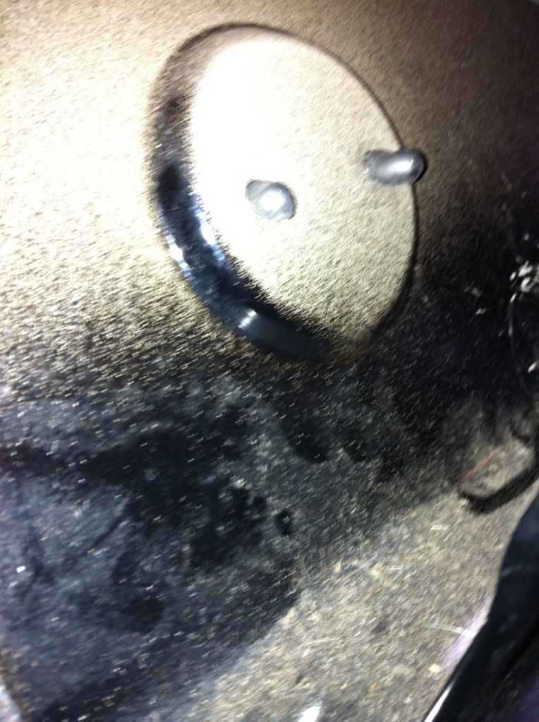

OK, I also need some help.
I have bought a replacement VW rear badge.
As described in the posts above it comes with what I think are 2 plastic fit once gromets.
The problem is removing the old badge.
I have prised off the badge and rubber surround but in doing so I have broken what appears to be rubber lugs which are still stuck into what appears to be soft rubber gromets.  These look impossible to remove.....
I am not sure what the next step should be as I don't want to do any more damage.
I will try to post a picture.
Neil

Offline nmcculloch
  • Posts: 5
Re: Removal of rear badge - dumb question
« Reply #15 on: 07 June 2012, 22:20 »
Thanks Thom89
Here is a photo (hopefully)....
Yes, the broken legs are stuck in the rubberized clips.
My main concern is that the rubber seems extremely strong (and pliable) and so a lot of force will be required to push it out.
(On the inside of the boot, the lugs stick out and are very "rubbery" and so difficult to get any purchase on to "push" through.)
I guess it just requires brute force, I am just concerned about doing damage.
Neil

« Reply #16 on: 07 June 2012, 22:35 »
Just shove em! :smiley:
Thom

« Reply #17 on: 08 June 2012, 08:27 »
If the badge was fitted with the original grommets, you could straighten them out from the inside of the boot with some pliers, then push them back out through the hole in the rear panel. Inside to out as it were.

« Reply #18 on: 08 June 2012, 13:29 »
You won't push them out with the pins still in the clips,
Once the pins are cleared from the holes, then the new badge can be pushed straight on to the mounting clips... No need to remove them
Thom

« Reply #19 on: 11 June 2012, 22:23 »
Thanks for all your help.
There were no plastic clips on the car, the rubber lugs appear to have been pushed directly through a "rubberised" washer type arrangement which was very tough to remove.
See the before pics.
The only way to make progress was to attack it with a razor blade, cutting off the lugs on the inside of the panel and then trying to remove as much as possible of the rubber on the outside of the car.  Difficult to do without scatching the paintwork too much (see after pic).
Ideally I would have removed more rubber, but went ahead and fixed the clips and badge in place.  It is not as snug a fit against the body as I would have liked but we will see how long it lasts.
