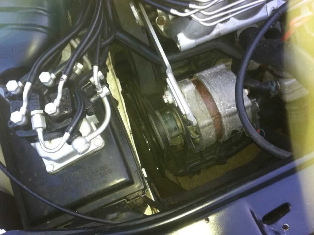

OK, What are the 2 belts fitted on side of Mk2 Golf GTi 16v engine. I ask as outer one is twisted and needs changing. Can't find sod all in Haynes Manual explaining what belts are :sad:. I know inner one is alternator and I think maybe water pump. Here's a pic.

the other is your PAS belt

Power steering pump belt.

That would probably explain the juddering in the steering at tickover. Cheers all

As others have said the outer belt is the power steering belt, the Haynes book is hopeless and doesn't seem to realise that these cars came with PAS.
I found this guide helpfull when changing the water pump which involves removing both belts as it actually identifies the adjustmnet bolts:
http://www.volkstorque.co.uk/vt/mech-tech-questions-answers/62134-mk2-golf-thermostat-replacement.html
The third photo shows the hidden bolt!
I assume that you have the KR engine, there are two different sizes of belt for PAS depending on the chassis number, I found out by buying the wrong one first based on the guide in Halfords. According to VAGCAT the options are:
v-belt / F >> 1G-MW240 000* / F >> 1G-MB075 000*
9,5X730MM / KR,PL
(7) 027903137
v-belt / F 1G-MW240 001>>* / F 1G-MB075 001>>*
9,5X630MM / KR,PL
(7) 026145271
