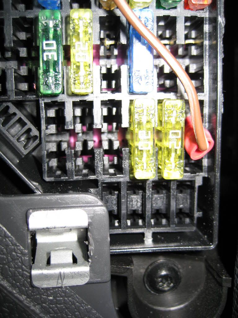

Folks, anyone know which sections of the fuse box have permanent power? Trying to retrofit PDC and rear camera and need to add a fuse for each.

Here is a photo of when I put a road pilot in my MK5 - but I don't know if the fuse box is identical.
Just stick a multimeter in the blanks until you find one that's powered!

thanks! I thought all the top bits had power but from your pic I saw only a couple extra have an exisiting top in already.
Hmm, I need three more fuses, and seems like only 1 is available.
Wonder how you add more?

Some details lower down
this page
. on adding a new fused circuit.
One thing they mention is to remove all fuses before adding the new circuit
I haven't done this the last two times I added a new circuit and it doesn't seem to matter, forgot the first time
