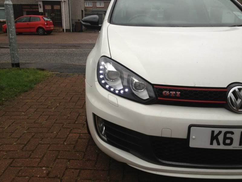

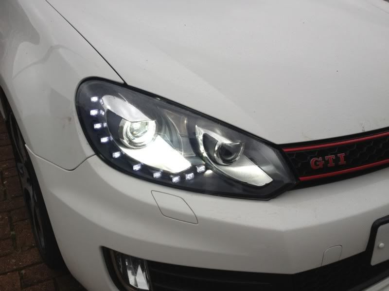

Well at long last my lights arrived after 4 weeks but to be honest they were worth the wait!
They are a very sold unit for replicas and build quality is no different to the quality of my OEM Halogen housings. Everything fitted nicely and I am over the moon with them.
Anyways the job was done by myself, I started at 08:30 this morning and was all done by 10:00. All i need was my torx bits, ratchet, and as someone else said....... a brain!  :grin:  oh and VagCom.
I have fitted my 6000K H7 bulbs from my xenons. Although the description says it’s a D2H bulb a H7 bulb also fits so no need to try find someone who sells a D2H bulb!

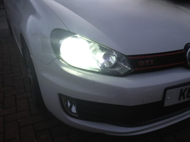

Before Shots ( Xenons ( Hid kit ) and LED sidelights in Halogen Housing )

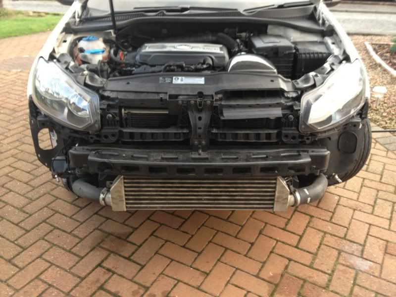

Bumper Off:
Light Out:

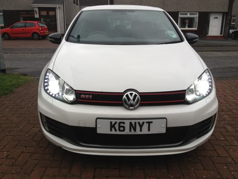

New Lights in with LED sidelights on:
Some Final Shots:
