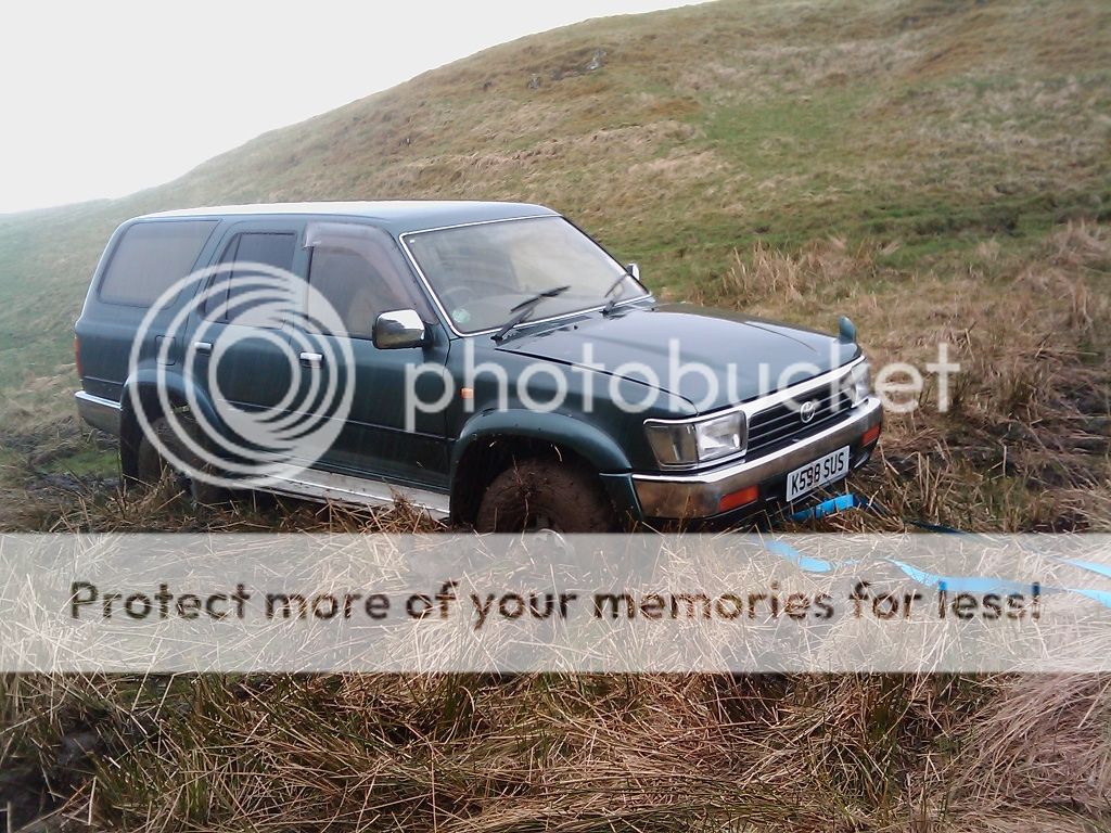

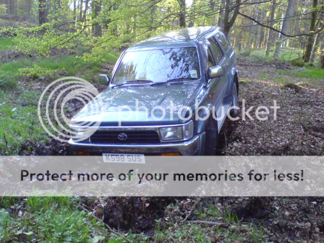

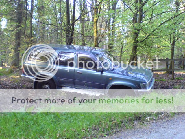

Here is my 4x4, down on the solway firth for a bit of drift action! Its like a free skid pan down there, good for learning. And there are dunes to play in too...
Its primary function is carting my bike about to and from forests ( two fully built bikes go in the back with the seats down). It gets a fair few miles on forest roads through the year when im working at MTB race events, but limited proper 'off road' use. I do try to have a play when possible, and hence it has become known as the ditch surfer! Dont manage anything as impressive as posted above however.
One favourite this year was driving up the black route decent from the top of Kielder forest. says more about the naff-ness of their black route than the ability of me and the wagon.
This was a bit of trail reconnoissance gone wrong, the tarmac road is 2ft away, but the bog was too wet (common issue in Scotland)
When its not involved in a bit of opportunistic 4x4 fun, i.e. something more planned, we always follow the tried and tested off road method. Go and have some fun, untill someone gets not just a bit stuck, but very stuck, spend several hours digging them out (inevitably from some Scottish bog again), then go home.

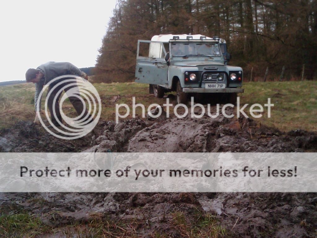

Recent antics on a local farm, with a couple of mates with landy's:
several tow opportunities that day, till the wee series 3 got sucked into the bog in the final pic. much digging (3hrs) to avoid asking the farmer for a tow at the cost of £20.
