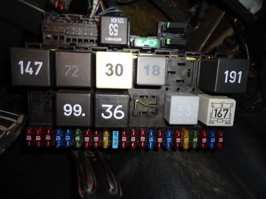

The haynes manual fuse/relay box diagram doesn't seem to match my fusebox.  I reseated all the relays and also the ignition switch.  the book shows the #2 position as 'starter inhibitor relay & reversing sensor relay', but I've got nothing in that position.  followed the wires from the switch to the box, nothing obviously wrong.
Here is a pic of my fuse/relay box.

have you got good voltage from the engine itself (also gnd) to the batt pos & starter lead?  Wondering about a bad earth cable.
try powering the starter excited directly using a reasonable sized bit of wire.  That would isolate starter issue vs ign switch / wiring.

You get ignition lights as normal? but doent crank the engine over in the start position?try wiggling the key when holding it in the start position,sounds like ignition switch issue,very cheap fix if it is :smiley:

I was losing a couple of volts across the earth ground.  Removed and cleaned, no help.
Tried wiggling the key in the ignition during start, fires up no prob.  Of course it's always the last thing you check.
