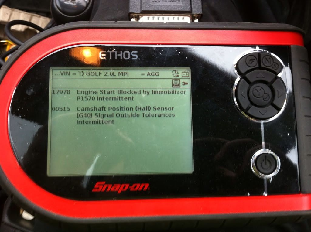

Just got communication.
Intermittent engine start blocked by immobilizer
And
Intermittent hall sender signal out of tolerance
Now I can't get communication again

  • Posts: 204
Re: Gti 8v agg no spark
« Reply #5 on: 22 October 2011, 13:25 »

« Reply #6 on: 22 October 2011, 13:31 »
I think the water has messed the hall sensor then, so it won't fire up. Don't know why the immobilizer would come on after a water incident, but maybe water got into the ECU?
